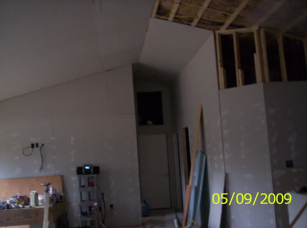

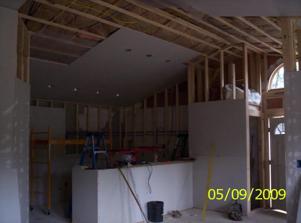

Bishopknight
#368

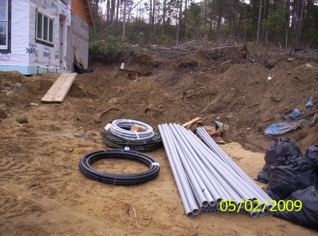

Heres the 1 and 2" conduit, tri-plex and 4 ought SEU wire for the meter to panel connection. I also got a 100' of 1" water line.

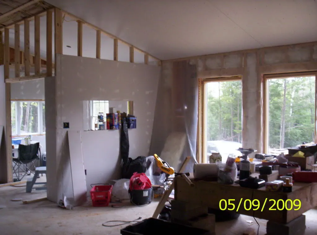

Most of the kitchen drywalled but pex elbow sections not hung until I can pressure test them. The utility room is not drywalled at all where pex or DWV is located.
Main hallway hung with drywall with an above head storage compartment which will hold quite a bit of things.

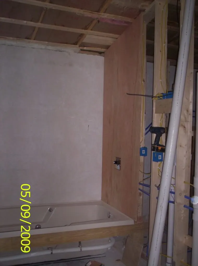

Shot of the shower. Next time I will photograph the actual pex installation I've done.

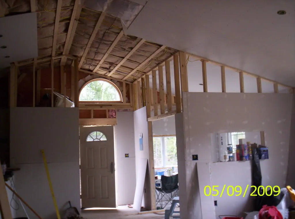

Another view of the living room. The 4 ought quad-plex SEU is not installed yet because I had to order a 200 amp disconnect combo box.
Shot of the entryway.

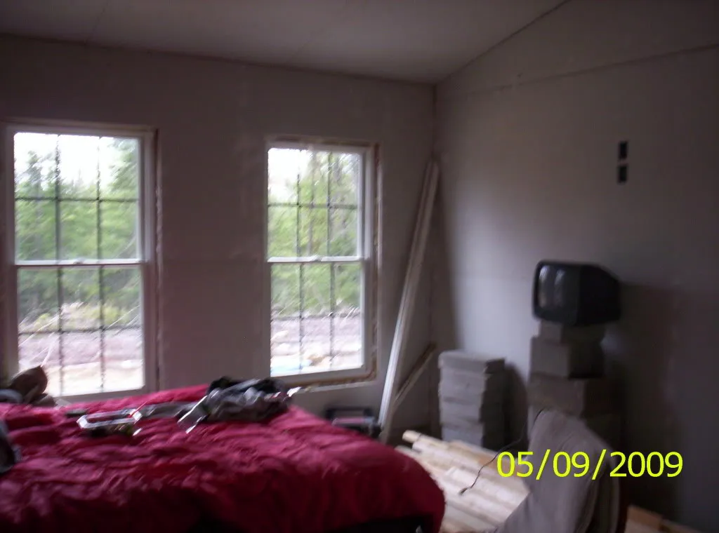

My master bedroom with queen bed and tv/dvd combo unit ( great for relaxing and watching Battlestar Galactica on )

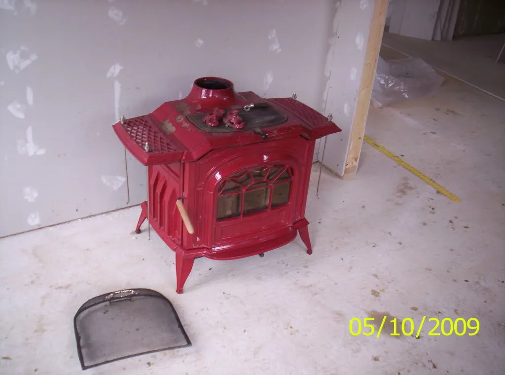

My $400 craigslist Vermont Castings Wood Stove. This sucker is heavy.

It's looking good, You're fairly rattlin along there! Great buy on the stove - we just got an "aspen" by vermont castings on kijiji for $500 cnd and considered that a good deal! I checked out your vid on youtube. I thought you came across very well. Good of you to put your hard won knowledge out there for others. Nice one. [cool]
Al
Quote from: Bishopknight on May 12, 2009, 06:05:36 PM
Oooh! A porcelain one.  :)
Heavy... nothing but the best recycled American V8 iron... well maybe not just V8's   ;D

Bishopknight
Thanks Alasdair, I just tossed that video up there. I look tired in it.  I'm having fun with it all though.
LOL MountainDon  ;D
Hey Bob, those are 1x3 strapping. I did it to make laying the drywall easier and also to be able to put up the insulation back in January without stapling it to the trusses. Also, when a piece of drywall doesnt land right on the next strapping, I can just put up a scrap piece ( if theres room ) and not have to cut the drywall. Works out really nice for us lazy drywallers :) MountainDons right also, I heard it helps with smoothing out irregularities. I was a little worried just going end to end on truss with drywall and the strapping was really cheap so it worked out good for me.
