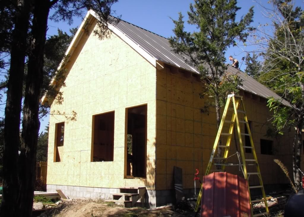

naturebug
We had a long weekend but got the roof on with no problems other than taking a lot longer than we thoguht it would. We were off about 3/4 inch at the end on one side and about 1 inch on the other. We could live with that with no problem. We put the double bubble foil under the metal which was a little harder than we thought it would be. Overall it went great. We are thrilled that this part is done. We will install the windows and doors next weekend. My husband, Terry hasn't done it yet for fear of something dropping from the roof and busting a window. The color of the roof was a hard one to pick but after we put it on we knew that we made the perfect choice - we love the color. Now starts the siding debate. We have the shake shingles for the eave of the house so whatever we go with will need to look good with them. We keep changing our minds when we drive past a house we like but we both agree on no log siding - we are leaning towards cedar siding but still not sure.

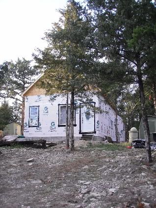

We have the windows and doors in. Most of the wrap on. We worked inside this weekend and ran electric, put some insulation up and a few sheets of sheetrock. I'll post pics from inside when it's not as messy as it was this weekend.
This is our view of the lake from the picture window at the cabin. The view is actually better and bigger than the camera showed. It's hard for me to get away from the window and get work done!

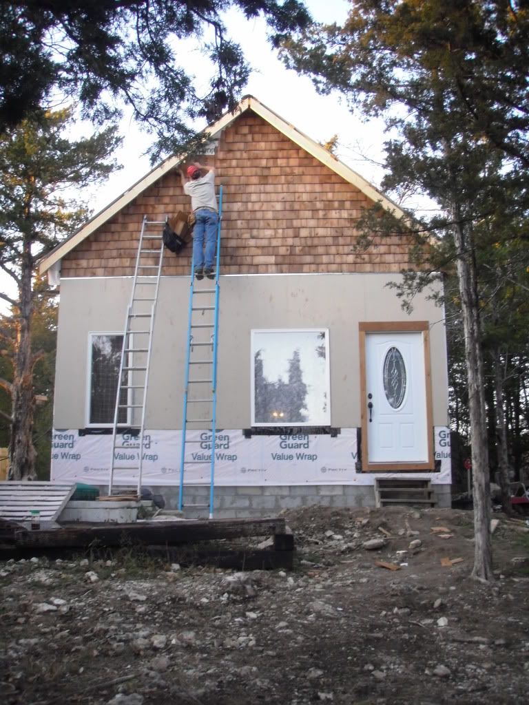

Worked on the cabin this weekend. Put the shingles up which took about 2 full days. The siding is just primer right now but we will be painting it a dark taupe. The bottom area will be cedar lap siding. It's a different look but was trying to make both of us happy and make our cabin a little different. Saw an eagle fly over our cabin while we were working on it. Thought it was an awesome sight.

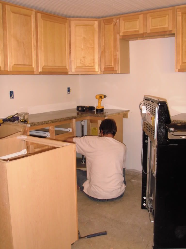

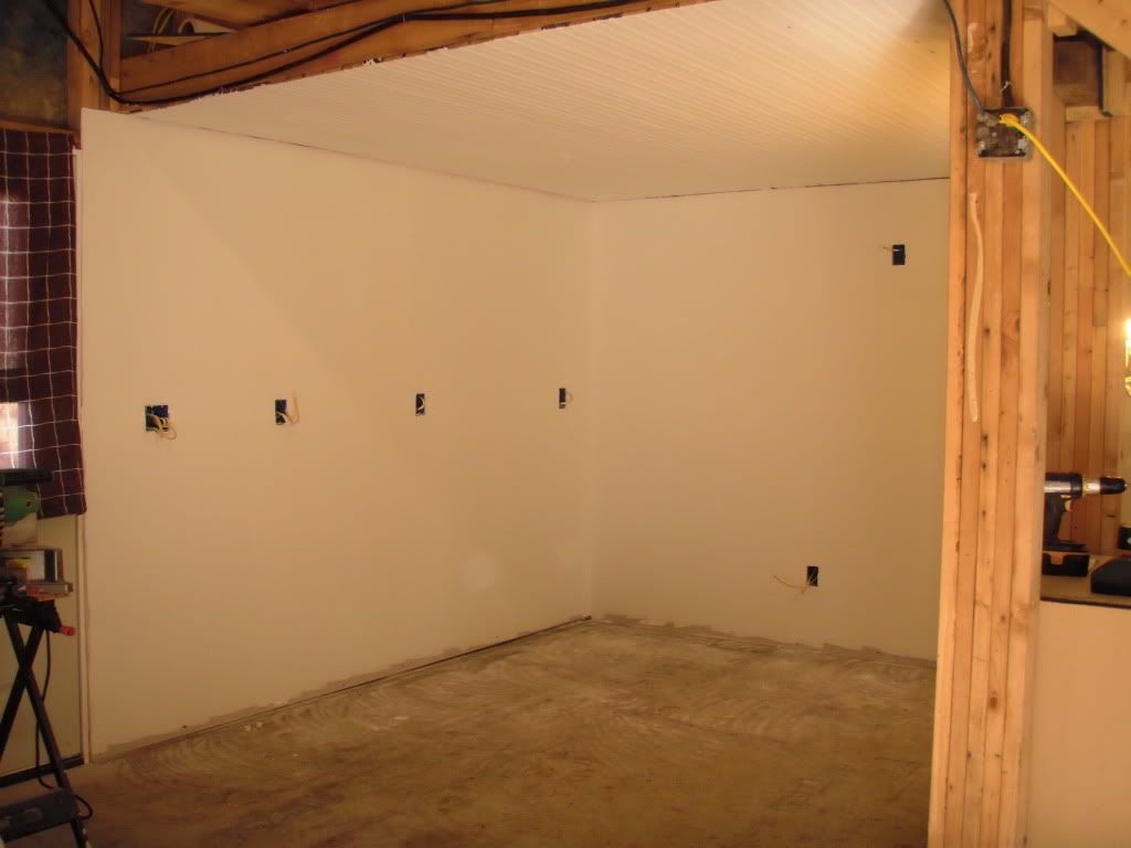

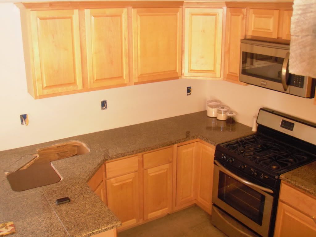

Put the cabinets in the weekend.
before:
During install:
AFTER:
We still need to put the sink in and finish the outside of the snack bar. The cabinets are maple in a natural finish and were bought at our local home store. They were a display so we picked them up pretty cheap.

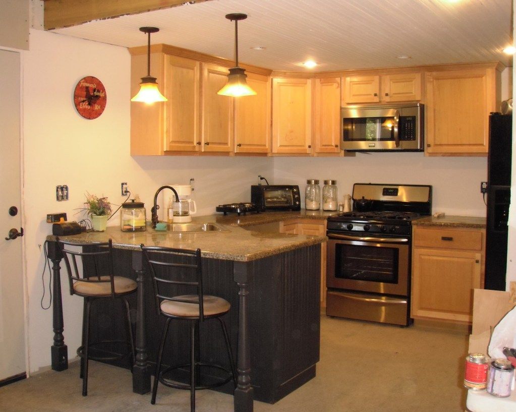

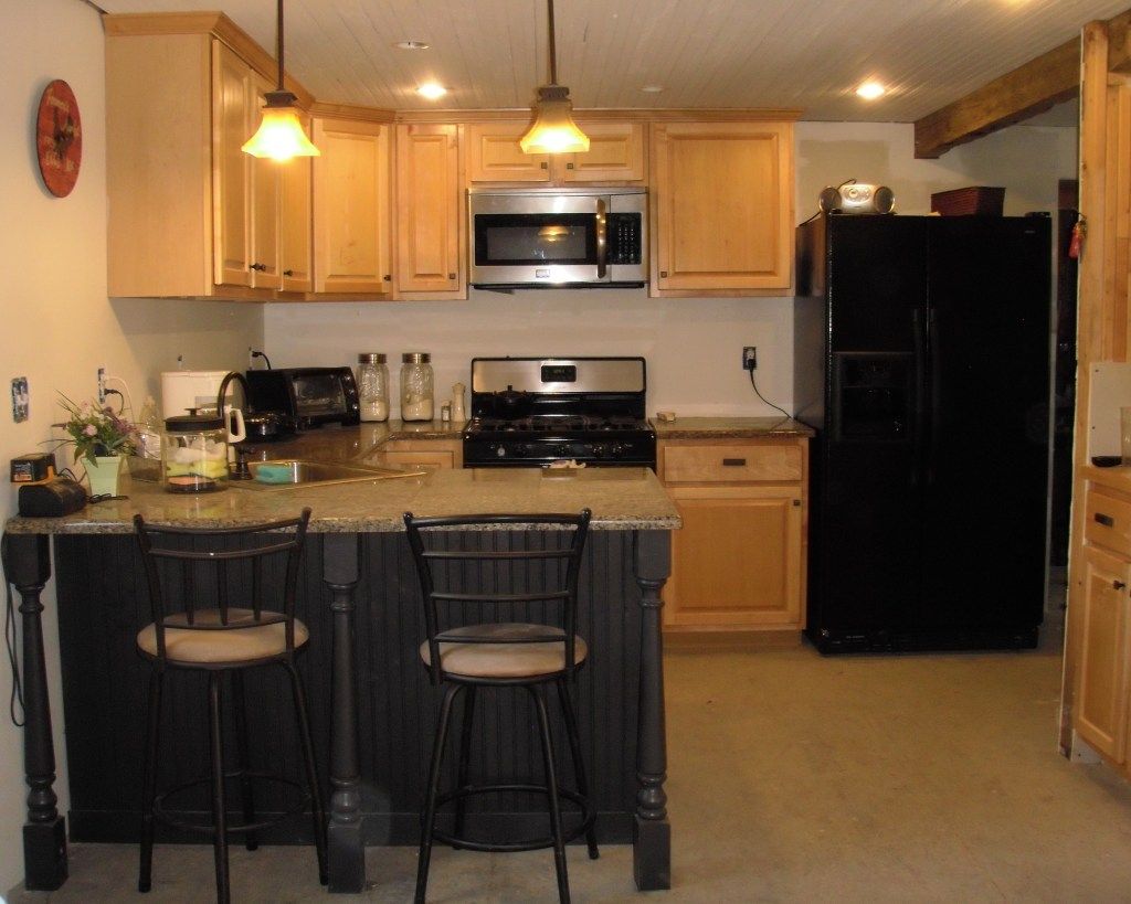

naturebug
Here's the kitchen almost complete
 [cool]
The display cabinets worked out very well.  I have often wondered why more people building cabins and guest houses do not take advantage of that.  How do you like the corner sink?  Myself I think they offer a very good option sometimes to a dead corner.  I like it.  What did you use for a kitchen ceiling?
There is a counter top appliance next to your toaster oven.  Hot plate or a ???
naturebug
I love the sink in the corner. It's hard to get enough countertop space anyway and it seems the sink is always right in the center making it a small countertop on either side. Nice large countertop area now even though it's a small kitchen. We have a toaster oven and hot plate on the counter right now because we don't yet have the propane hooked up but that will be done in the next couple weeks and those will be gone. The kitchen ceiling is hundred year old beadboard that we removed from an old house, power washed it and put about 4 coats of white paint on it. It is one of my favorite things in the house. The beam you see over the fridge is a hand hewn beam from that same house. It has been forever building this cabin but we've only been working on it sometimes a few days a month so all in all it's coming along well. Thanks so much for your comments. - Angie
