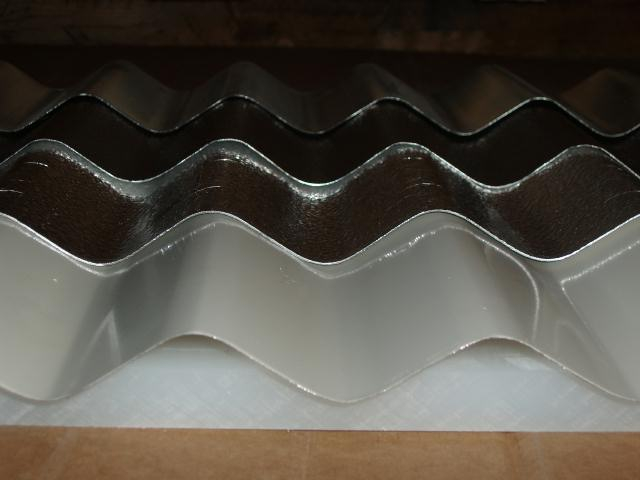

My little metal roofing experience has been with corrugated roofing.  Just my preference thus far.  Corrugated roofing is self-venting, to a degree, whether it is installed on solid sheathing or purlins ... unless special efforts are made to seal the panel ends.  In the heavier ga's ... 26 and 24, the panels offer quite a bit of anti-racking.
My local Ace hardware sells the special soft-washered screws in various lengths.  I use a 1/4" hand drive rachet to install the screws ... usually, in pre-drilled holes, on the ridge-tops.  I also like to lay the metal panels in daubs of construction poly sealer/adhesive ... this seems to deaden noises quite a bit ... and may make the screws redundant.  A few screws are installed loosely until the poly cures, then I go back and finish installing the screws.  This allows the poly to "level" the panels compensating for some of the irregularities in wood work.  I have not been brave enough (foolish enough) to try an installation without the screws ... I'd hate to have my metal roofing rain down on my neighbors.
