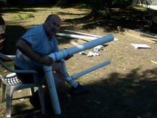

 :D Thanks so much for the support.  Another great weekend at the property.  Your advice on the plumbing was very helpful, it's done and ready for the slab to be poured.  I told my sons you can do anything with the right book, and some good advice to go with it.  Here's my in slab closet setup, with vent of course.  Oh yeh, the first version had the waste going 180 degrees in the wrong direction!
FrankInWIS
darn, just like my plumbing, read and be careful then still get it wrong the first time!  Trying to post the url of my image between the brackets. not working for me  :-/
FrankInWIS
Double barrel spud gun :-/  ;D w/ stand. :-/

WMD,   Weapon of Mashed Destruction    ::)   Like this....
http://www.spudtech.com/
http://www.americanaircannons.com/about.html
I had a small one many years ago. A combustion model, not pneumatic as this one appears to be. Could be a good winter project. Ya' know... to protect the mountain site from predators.   ;)
Now THATS a spud gun :o
We better hope  Frank doesn't  build one , he'd almost be able to hit us both from Wis.  ;D
Your really becoming one of us "driftmasters " Mtn. D ;)
