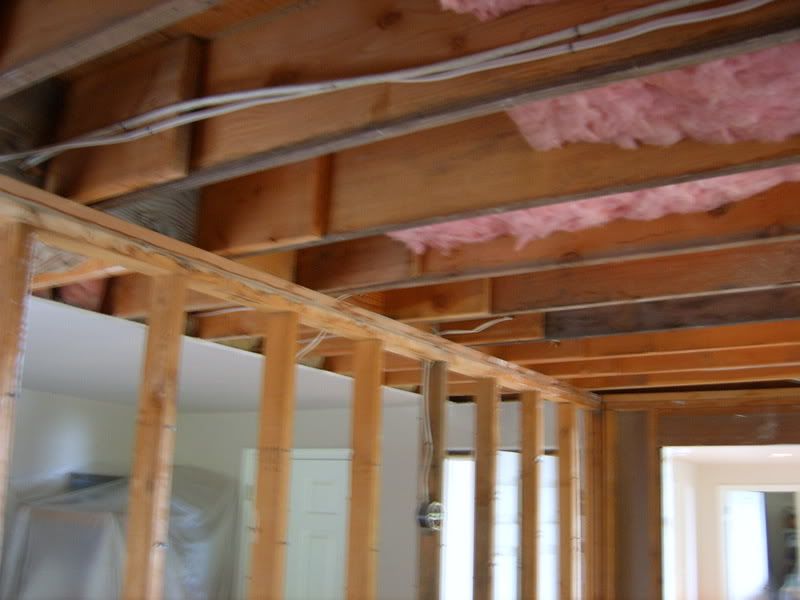

Cut out joist for LVL ,
Note the little "dap" for the hanger to seat in. No bump / lump / hump in the cieling that way.
LVL in place , hangers on.

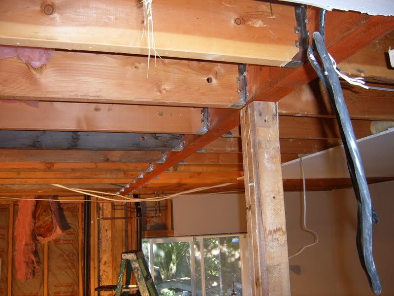

 Temp beams in place  ,
You can see the steel beams in the bottom of the photo along side the wall.  Now if the bolts come in tomorrow  ::) we may get some steel in the air.  My bet is on Wed. on the bolts

  Another interesting "Murphy" thing , the thru bolts that hold the two wood beams to the I beam , are layed out 32 " OC , figger the odds of where the steel guy started to pull his 32" OC pattern <   YUP  > every bolt falls right on the existing floor joist  ::) so we routed out a "pocket hole " so the bolt head and the nut will be recessed into the 4x8's .  We'll cut off any excess bolt once the nuts are on as well.
  Good thing we checked or we'd have had that big beam up in the  air and in the way when we would have  had to re-cut the floor joists to clear the bolts (head and nut).

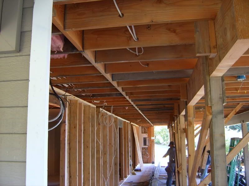

Cutting out that old rim type joist , althought it really wasn't a true rim joist , they did it sort of like it was . So instead of just pressure blocking that knocks out pretty easy with a sledge we had to cut that "rim" joist into pieces , well lets just say it was PITA getting the needed material out of the way  ::)
We used the beam as a sort of staging to cut the joist out , a good 2 fer  ;)
  The 2x4's on either side guided and helped stablize the beam as we jacked it up, we made sure the tops of the 2x4's where inside the joist cut end so we wouldn't hang up on the joist ends , that worked very well 8-)
The walls jack where "back up " and held the beam up when we changed to longer post off the bottle jacks , 4 ea. 20 ton did the lifting. 5 1/2" per jack stroke / full extention, so it was a slow go, and we used lots of 4x4's as we had to add length  each time.
New posts where swapped out one at a time .
There she is all snuggled in her  new home  :)
Tomorrow we'll check it out / tune it up , check for any low joist that we'll taper the bottoms on to "fair in " the new ceiling, no big bumps , yanno ;)
 Took about 4 hours with 4 guys plus the boss who ran down a some  more 4x4's and kept the wall jacks snug up against the beam , etc,  etc . Once we got it in place , [highlight]didn't leave you a joke line there Glenn ;D[/highlight], we cut 4 ea. 4x6's,  banged those in and left the jacks and wall jacks in place for the night.
