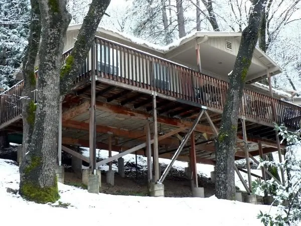

 i have some very tall 6x6 posts because of the slope of the land (up to 64" tall).   the post on the high side of the land is only 5".
Do i need to brace the tall posts?
I am using simpson T ties to connect the post to the beam and 2X connecters at the corners.

I've seen very tall ones around here but -- yes -- they do have bracing -- to me the bracing on the local ones here is inadequate, but what do I know -- they're still standing.
jraabe
#11
Yes, bracing is suggested for taller piers - diagonal or "X" bracing. Think like an earthquake... the "X" braces will work in compression and then in tension and then switch as the house moves back and forth. Make sure your connections can handle both.
I agree with Glenn, the house above is not well enough braced for high wind and/or earthquake country.
