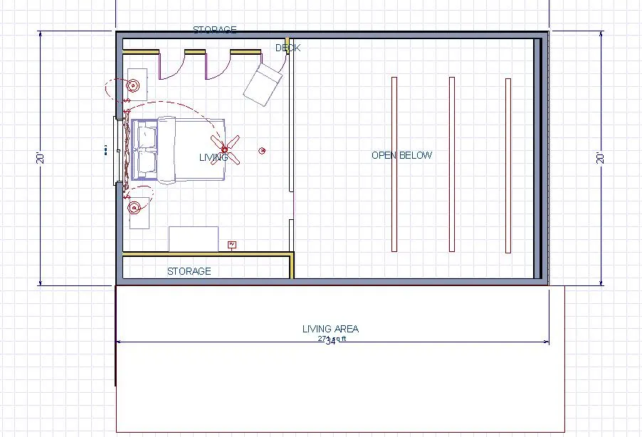

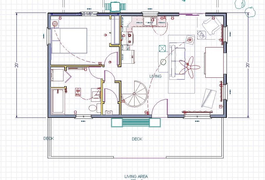

Pritch, here is our layout.  We aren't exactly set on what kind of stairs to have, torn between spiral or steep winder.
i know you said.interior.isnt done.but i would really appreciate seeing pics of the downstairs rooms to get a feel for the size. Looks lime the bedroom would be a queen size bed max, bathroom.looks plenty big. Mabey rob a coup feet from the bathroom for the bedroom.
CJ when we go up this weekend I will take some pics of the interior.  Yeah, I think it will fit the queen size but we decided to have the larger bathroom to fit the washer and dryer in and have some storage room too.

I believe i am stealing your floor plan. You know what they say, imitation is the sincerest form of flattery.  :)
mogie01
Quote from: CjAl on October 04, 2011, 10:34:55 PM
Thanks CjAl, that's why I love this site, it gives you a chance to see what others have done and how it might work for you.  Glad you like the foorplan :)  I'll be sure to take some pics of the inside this weekend.

CjAl I took a few pics of the inside.  I couldn't get a good angle though so I had my husband measure the rooms.  The bedroom is 13' x
9'5" with a 5' x 2'6" closet.  The bathroom is 9'4" x 9'10".
