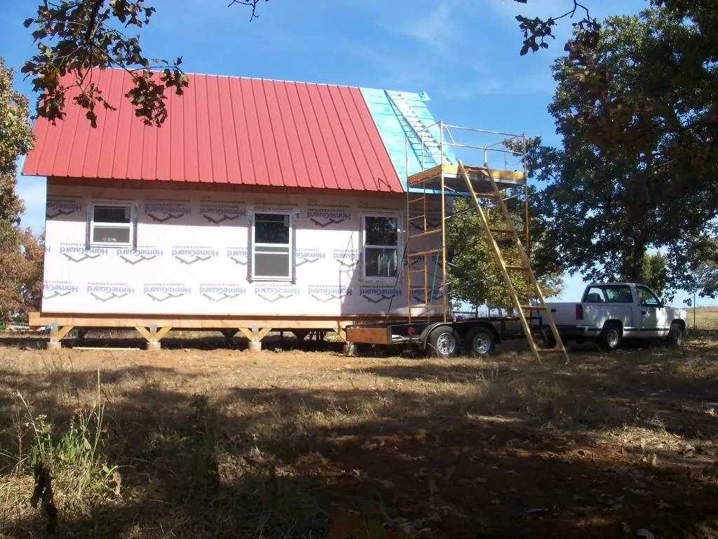

May I ask you what you will be using for the Fascia? also are you still using the forklift to access the high end of the gable, or are you using other method?
We are currently doing our siding/soffit/fascia. Up till now I only used ladders, but in order to get to the high apex of the gable and install all these things I am still not sure what is the best way to do it. I already baught scaffolding, but enough to get me to a 10 feet section at a time (the cottage is 20x30, gable being the 20), which means I have to dissmantle and re-install 4 levels of scaffolding, which I must admit is scaring me :-\

Sharbin-
There is another thread on here I saw where someone installed the scaffolding on a trailer and moved the trailer with their truck as needed.  Needless to say, level ground would be a must for that.  Just an idea.
oifmarine
#94
Here is the build thread that shows the scaffolding.  I couldn't figure out how to insert a picture so you will have to go to the thread and check it out.  It is near the bottom of page 7.
astidham
OKLAHOMA 20X30 SINGLE STORY
Dropped image in here (you can see how it was done)

Just a word to the wise on scaffolding.  If you are using cement blocks to level always use the webbing up verticle and not horizontal.  It is also a good idea to use 2X material on top of the block for the legs to sit on.  When I did my house I had it stacked 5 high.  No matter how strong or sturdy the base is it will be shakey at the top.  If you have a window on the gable end you might consider tieing off to the interior.  If you are setting it up on recently filled soil use a base plate of 2X to keep the block from sinking with the weight of the scaffold and yourself over time.
astidham
Quote from: oifmarine on June 27, 2011, 06:37:51 PM
astidham
the scaffold has adjustable feet for ~15" of leveling.
