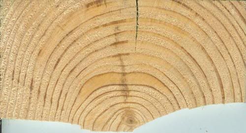

This is a shot of MSP, mixed southern pine, containing a form of reaction wood known as compression wood. If you see much of this at all run before it jumps out of the pile and hits you  :D
The wider "peanut butter" looking grain is the culprit I'm pointing out here. It is also present near the heart, and you can see some here, less pronounced. It is actually come and go all through this quadrant of the chip. In reaction wood the tree is trying to support itself in a lean or is trying to build strength to support itself during rapid growth spurts. The microfibrils that make up the cell walls are oriented on the bias rather than lengthwise within the cell wall so that as it shrinks there is not only width and thickness shrinkage, there is length shrinkage as well. depending on where in the board this reaction wood is located the board can be pulled into a bow, or a crook, can tie itself in a knot or can uniformly lose length. The peanut butter you are seeing is a heavy deposit of lignin, the "concrete" component of wood if you think of cellulose as rebar. You know pure cellulose in the form of cotton, strong but not stiff, lignin provides the stiff but is brittle. Softwoods support a lean by putting compression wood full of lignin under the lean to support it. Hardwoods throw cables over the topside of a lean and try to pull it back upright. Anyway, bringing this around the back stretch, RED is where they dump alot od reaction wood that would be unsafe if used as a spanning member like a joist or beam. We are paying the price for forestry practices that were all about rapid fiber production irrespective of quality.

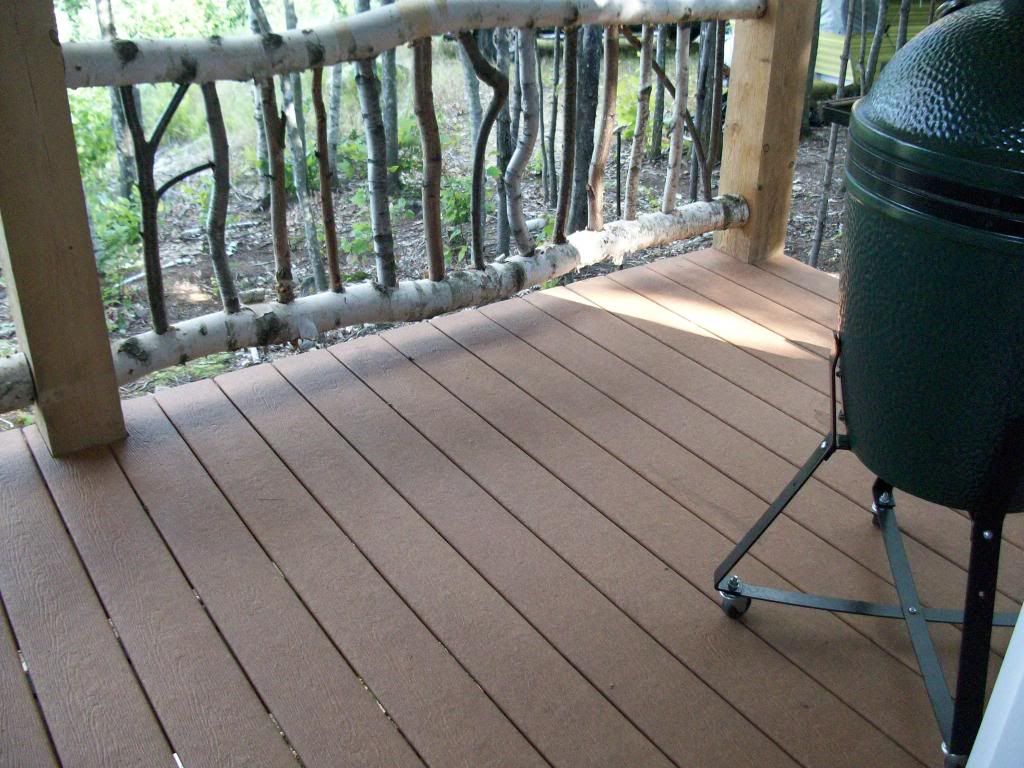

I used composite on my 20'x6' covered porch, 16" o/c. It does tend to show scuff marks from boots, and is darkening. However, we were looking for NO maintenance decking. It may be plastic, but it has a fake wood grain stamped into it, which works for me!  d*

QuoteI used composite on my 20'x6' covered porch, 16" o/c. It does tend to show scuff marks from boots, and is darkening. However, we were looking for NO maintenance decking. It may be plastic, but it has a fake wood grain stamped into it, which works for me!
It does look good. Love your rails- I am trying to come up with something unique for that part as well.
