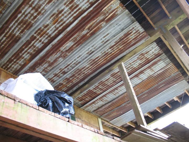

To basically close this thread (if there is such a thing as closure), I thought I would post what I ended up doing:
A friend of mine owns an architectural salvage place and he deconstructed an old barn that was sided with (salvaged) old corrugated tin.  On one side it is stamped: Made in Japan.  It looks like it could be from WWII but the Made in Japan thing wouldn't fit.  Anyway, it is old.
I got a number of these 2'x10' sheets, filled the holes with a squirt of clear caulking, and put them on the underside of my deck after adding some sleepers at regular intervals (with increasing thickness).
It has a certain patina, to be sure.  And some won't like it.  But I like the salvage aspect. And I also like the relative ease and cost with which I was able to do it---plus the deck below it is now dry!
