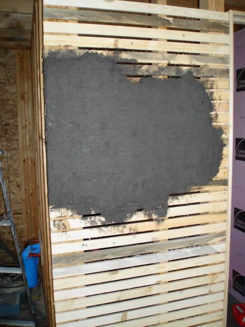

I'm giving earth plaster a try.  I put some lath up on one wall to do a small test patch.  If I screw it up or don't like it shouldn't take much to tear it out.
I didn't use a trowel, just smeared it on the wall with my hands.  I though I had it mixed up pretty good, but discovered I had a bunch of marble sized balls of clay in the mix.  I'm going to try soaking the clay in a bucket of water overnight before I mix the next batch.  Hopefully the clay won't ball up as bad.
Not sure how thick the first coat is supposed to applied, it ended up about a 1/4" thick.  ???

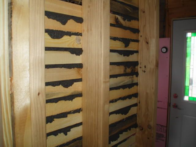

Here is a shot of the backside of the wall.  Do I have enough "squish through" or whatever the technical term is?  ::)

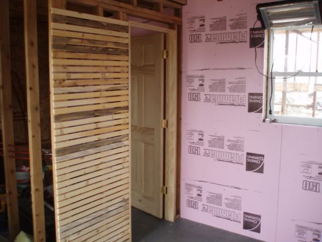

The exterior walls are standard 2x4 construction with fiberglass batt insulation, and then covered with a layer of 1" foam board insulation.
Can I add furring strips and then lath over the foam board?  I wouldn't think I would have to worry about moisture getting into the insulation doing it that way.

Is this the American Clay product?  We used that on our house and really liked it.  Of course it was only one wall and essentially as an accent wall.  I can't comment on the lath.  All I can say is we liked the workability of the product and the textured appearance when it dried.  We also liked that with an imperfection (that we didn't like), we just added water and went over it again.

My soil has a ton of clay in it, sucks to dig in, but should work great for earth plaster.  I just mixed in sand and water to make this batch of plaster.

You might add straw and sand if you get too much cracking, Beavers.  Looks like you got the sand I see.
Lime helps too- makes it sticky.  You can add Henry's 107 to help bind and waterproof it it you like - around 5 to 7%
I did some with wire stucco netting about 6 years ago - still good.  Wood lath is more authentic.  Looks like you are doing good.  Please update us as you progress.
I think your furring strips and lath would work fine.

Looks good so far! We added some chopped straw to our scratch coat, though. Makes the wall a lot tougher.. We have yet to break through a wall, and we've had some good impacts!

If the test wall turns out good, I'm going to have to use something other than wood lath...big $$$ to do the whole place with that.  They make plastic stucco netting too don't they?  Think that would work, or would the metal stuff be better?
Every earth plaster recipe I can across called for adding something different to the basic mix...manure, wheat paste, borax, ect.  I figure I don't know enough about it to know what to add and what not to, so I just did the most basic mix.  If my test patch cracks up bad, I'll redo it and try adding some straw to the mix.

We were kind of unconventional with our interior doors and window trim.. We made the jambs extra deep so that they protrude about an inch beyond the plaster, into the room. The plaster is just troweled up to the edges of the jambs... The best way to do that would be to put a groove around the jambs so that the plaster has something to key into, or some wire lath stapled around to make the wood-to-plaster connection..
Our mix was pretty basic.. We used manure for a finer texture in the finish layers. Borax is a good idea to reduce mold growth. We had several walls that molded quite badly, and even had grass growing out of the plaster from the wheat straw. Once everything dries out it's all fine though. You just have to accept the sarcastic comments from your neighbors for a couple weeks. [waiting] Think lots of ventilation; keep the air moving..
You've described plaster "grounds", they were also used around windows and doors back in the days of true plaster .

I really appreciate all the first hand knowledge!  Did it work ok just butting the plaster up to the jambs or does it pull away at the edges?

I'm not sure if it's a technique thing or what, but I've had a hell of time getting the mud to stick to the lath.  It sticks like crazy to my hands, but not as good to the wall.  Do you think the lime would help that?  And where do you get lime?

Mud plaster likes to stick better to damp mud plaster anyway.  Too dry and you have to coat it with slip clay to get it to stick - also don't smooth the coats too well before the final coat - it sticks better.

We tried to apply the next coat before the first had completely dried out, but we often moistened the walls with water before recoating--make sure you leave the sub layer good and rough for a better connection. I think the wheat paste is supposed to make things more sticky.. We used it often.
I do remember having a little trouble getting the first layer to stick to the lath at times... You end up getting a lot of mud on the floor.. A good scraping motion (and not worrying too much about uniformity) and some chopped straw might help there. We chopped our straw in a garden chipper/shredder, but Glenn's method or a lawn mower with a bag might also work.

Turns out you really do need straw in the scratch coat.  d*
As the plaster has dried some it's developed big cracks, and is pulling away from the wall at the cracks.  I peeled it off today before it hardened too much.
