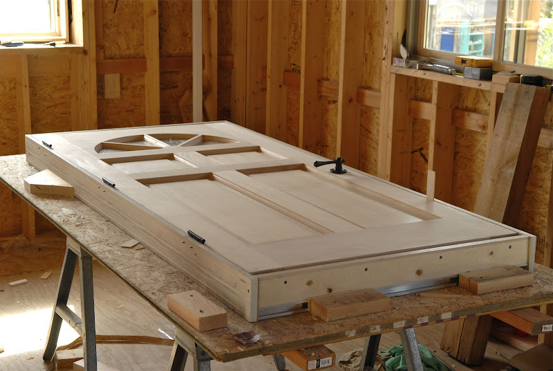

I wanted to buy pre-hung doors but couldn't find the style I wanted so I went the slab door route. It was a bit harder, and definitely took longer than I expected but with some great tips I learned on this forum it went pretty well.
I cut the bevel using a palm sander. Not the most appropriate tool but I didn't have a power planer and the sander was less scary for me than a hand plane. Not perfect but acceptable.
I then dropped it into the frame so I could mark the hinges-
Chiseling out the hinge insets-

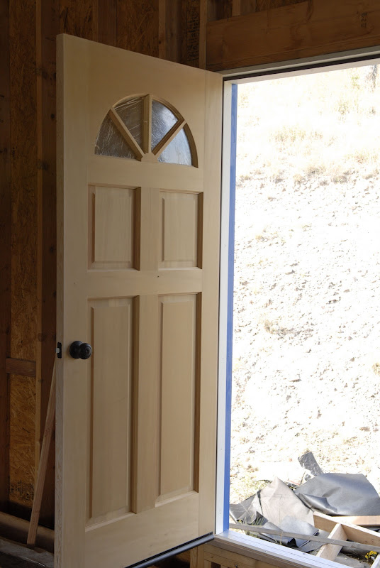

A big sigh of relief when it dropped right in-
I got pretty even gaps, though not as good as when it was on the table. I didn't leave much space in the rough opening so I had to make some skinny shims-
Still have to put on the jamb extensions and moulding, sand caulk and paint jambs, remove door and sand, stain, seal, and then start on the back one...Aye Carumba!  [crz] I now understand the value of pre-hung doors.
Overall though it was one of the more fun and satisfying jobs thus far. Nothing like your own front door closing with a perfect fit.   8)

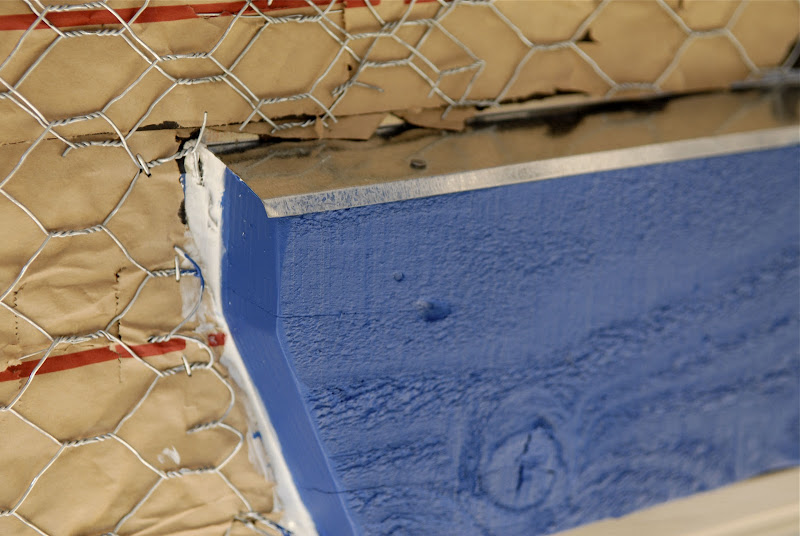

I flashed toe tops of my fake lintels like this me-

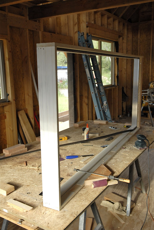

details on door jamb-

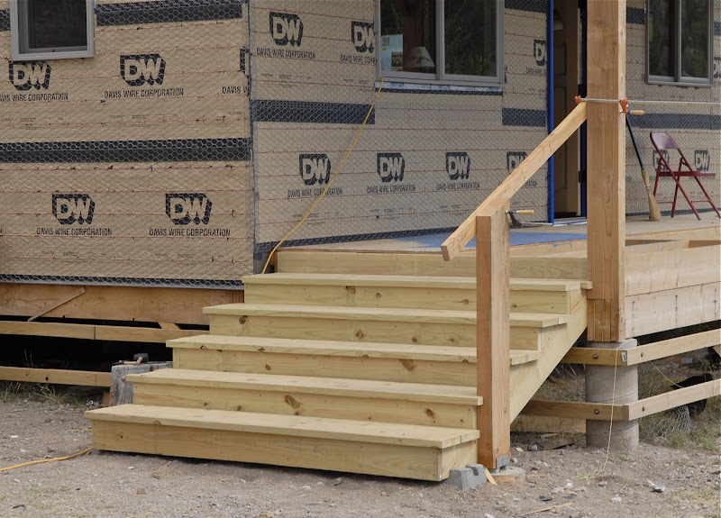

Lining up porch landing, hillbilly style- (note stringline attached to tailgate, plumbline on chair)
My first attempt at stringers, didn't go too bad-
When you have done without for awhile, stairs are quite the luxury! Handrail is temporary while trying to figure out how I want to do it.

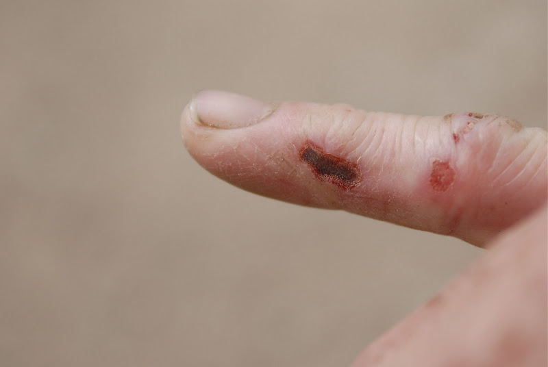

I've been hard at work doing the stucco finish coat at my friends place and getting good practice. A word of warning to anyone who has not done a lot of concrete work and is planning to in the future- Concrete (and lime) can mess you up if you are not real careful. I was wearing heavy rubber gloves and didn't notice the chaffing it was causing on my arm until it was too late.
also some water and mix got in my glove and went unnoticed too long-
It burned through what looks like nearly every layer of my skin, I fear scars will permanently remind me of that day.  >:(  d*
