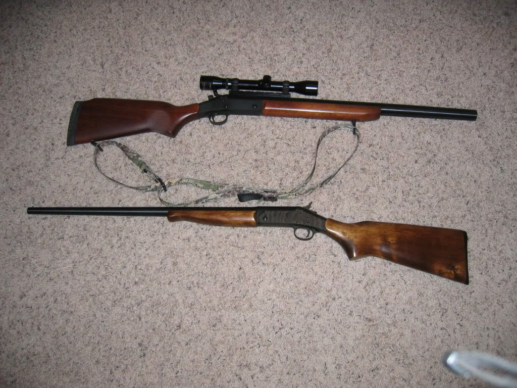

Figured I'd post some eye candy for you guys...
Note that you need an extension for the hammer if you are going to mount certian scopes.  I think it comes with it but can't remember if my FiL gave it to me or not.
I have been watching this thread and feeling something familiar about that forarm grip, and damascus styled receiver.  Sure enough I have one in 410 after I went and dug it up.
Mine is stamped New England firearms, Pardner model SB.
I guess H&R bought them out at some point as H&R now has a pardner 410 - exact same shotgun in their lineup.
They call it a SB1-041
http://www.hr1871.com/Firearms/Shotguns/pardnerYouth.asp
Here is mine,
