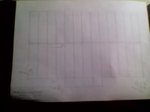

OK I'm just gonna lay out the next phase of my plan for some constructive criticism
I'm planning out the sublfoor that will sit on top of the beams.  I am thinking about framing the whole cabin 24 " on center including the joists for the subfloor and sheathing it with 3/4 inch OSB T and G.
I have a very low res image of our plan.
We have 3 beams 7 feet apart the floor is cantilevered 12" out from the centers of the far beams giving us 16 feet of depth and the beams span 26 feet in length there is a bay where joists cantilever an extra 2 feet.    there is a joist that runs down the center beam where all the joists will meet but  I am debating running 2X10 the full 16 feet and then blocking so there is something to nail/glue the sublfoor down to.
Not sure if that all made sense but any suggestions (especially on where hurricane ties would be most effective or) changes or if you think we should go back to the drawing board I will appreciate your thoughts.
thanks Bobmarlon d*
I will try to get a better image
TexstarJim
Bob, it looks fine to me, all the beams are straight and apparently level.  Extending the walls out another foot over each side won't hurt a thing, I've done it before.  I wouldn't advise any more than a foot, eventually it could sag.  Your cabin idea is real similar to my pier & beam design that I'm currently building in Oklahoma.  We're running along at about the same speed too.  I also will have 3 beams and just today got all my piers poured.  Lumber will be here first part of next week so I can start building my beams.
As far as location of the hurricane ties, the stress points are anywhere wind can cause an upward lift, mainly the sides and ends.  But for stability, I'd put one down everywhere one wooden structure joins another.  ie; joists resting on beams, etc..

"there is a bay where joists cantilever an extra 2 feet."
I'm working on a 14 x 24 and:
My floor joists cantilever 2' beyond the floor beams the full 24' length of the cabin on both sides....however, there are diagonal braces that run from each foundation post up and out to the rim joist.
"I am thinking about framing the whole cabin 24 " on center including the joists for the subfloor"
I did this as well, the floor, walls and roof in 2 x 6's ...my floor is 2 x 6 T&G the roof rafters are 2 x 10's.  Some have recommended that my drywall be thicker than that used for 16" OC framing, so it doesn't (hopefully) "wow" between studs and rafters.
I have strapping and ties in every place I could think of, except where the bottom of the wall is attached to the floor.
Additionally....because of using a post and pier foundation, I drilled 14 holes in the ground - 6 along each long wall and one at each end under the cantilever, filled them with cement, stuck a 1 x 3" bent steel strap in them and am bolting the strap to another strap that wraps around the floor beams, just another stabilizer, should the "big one" hit, being this is earthquake country.   I hope they are never tested.

Thanks for the input guys,  Were going to be starting on the floor after next weekend  I think I secured  the T and G leftover from a movie set so that should save us some money.    Its surprising how much construction materials people get rid of.

I put the floor joists (2x10) on our 15.75 x 30 cabin on 16" centers. I did it to make the floor as stiff as possible without going to 2x12 joists. My joists are cantilevers about 10 - 12 inches.
We also went with 16" spacing on the ceiling joists (2x8) and the rafters (2x6).
I did 24" center wall studs. The drywall we used was 5/8" type X. It is heavy to work with but there are no waves in the walls. I have seen new construction here in town with 1/2" 'rock on 24" and they are wavy. The 1x T&G stock on one wall was no problem on 24" centers.
The 24" wall stud spacing does give a slightly better insulation R value to the wall as there are fewer studs. However, when I add up the extra studs for the windows I didn't really save all that much money going to 24" spacing. However, I also found that with 24 inch spacing the positions for electrical outlets and switches (secured to studs) is diminished.
If I was building the cabin again, I still go with 16" centers on the floor joists and ceiling but I'd go 16" on the 2x6 walls as well. If I was worried about heat transfer then I'd add a layer of foam over the exterior.

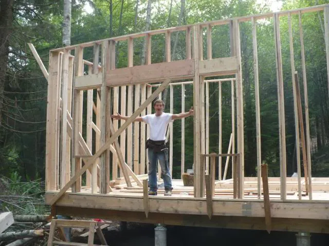

Bobcat and I have been working hard, There has been a substantial amount of progress made from our last post.  I lost the chord for our digital camera so this post will be a bit of a jump.
We sheathed the floor with 3/4" fir T & G  and pinned it down with rink shank nails and  of lots of sub floor adhesive. We found one of the larger tubes would last about 2 and a 1/4 sheets.  We ended up using 7 tubes through 14 sheets.

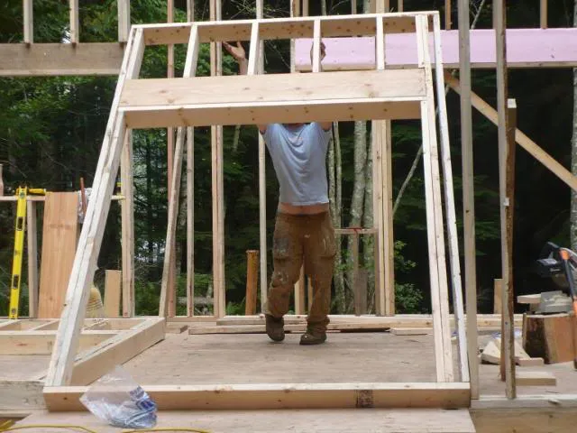

The first walls go up
and we learned to frame smaller sections at a time!

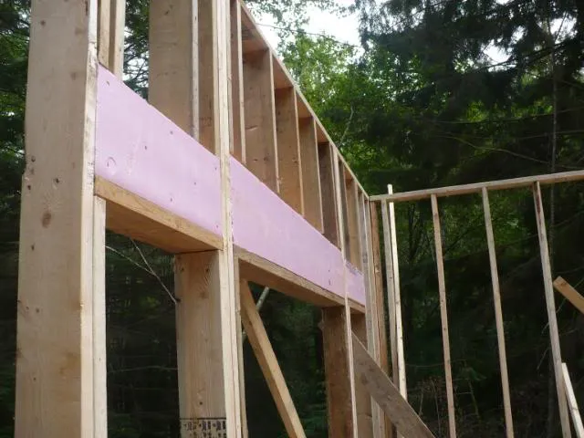

We pre fabbed our headers out of 2 pieces of 2 X and a piece of 2 1/2 " foam to fill in the gap

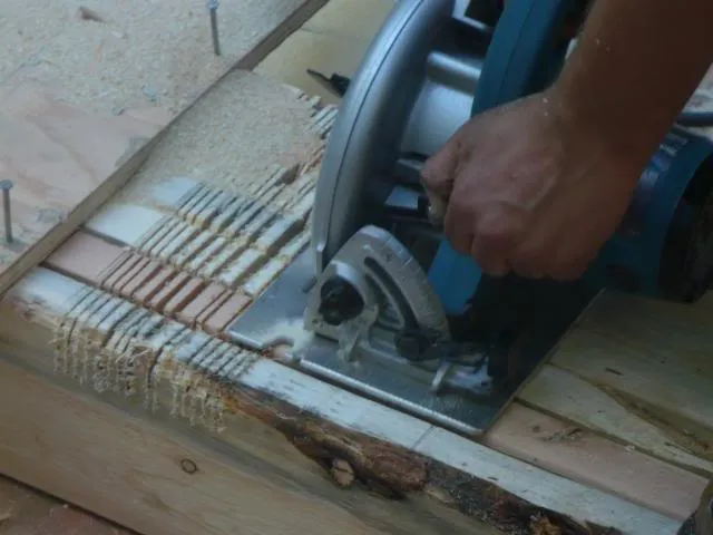

Alright Time for the notches
we didn't have any clamps so we used our tie downs
then we went crazy with the saw

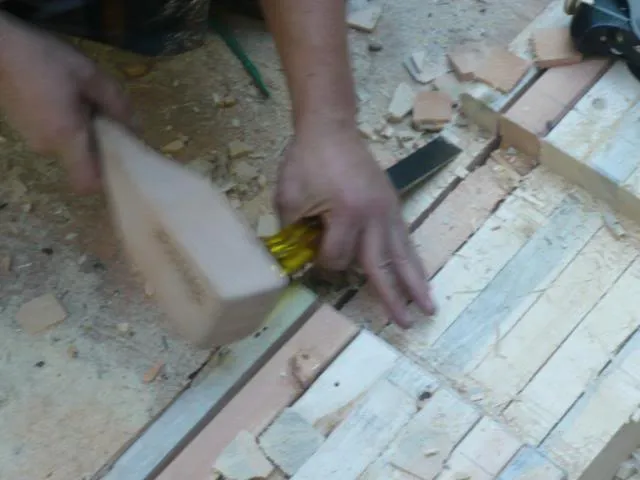

after breaking out all of the pieces I cleaned it up with my block my plane. I'm sure a router would be more accurate but I don't have one and routers give me a head ache.
finished off the corners with a chisel a shoulder plane would have worked better though.
fitted pretty snug with the Hampton premium

Bob I don't want to sound critical but when you headed out the windows and doorways having the foam(filler) on the exterior of your inside wall will be difficult to attach your interior wall covering and trim.  An alternative would be to place the foam on the interior of the header.  If I were to go that particular route I would have used a solid block on each end of the header to bring it out to the depth of the wall and then used the foam in between(from left to right).  That way you get equal distribution of the weight transfer.
Yes it is easier to frame in smaller sections but a pain to get lined up.  Good job.
Bobmarlon
Red we almost did put the foam in the middle but we are inexperienced and I was worried it would change the headers structurally. its not to late to pop out the foam and ad blocking though.
We gladly except criticism we don't want our house to fall down!
I am not sure what others will say but I have often used an open header with the blocking on the inside and out.  I would just cut blocks for the ends to put between the two header pieces.  I normally just build up the header to be full demension whether that be a layer of 1/2 ply and 3 layers of structural wood or what ever gives me the proper wall demension.  There is some area's in building that you can scrimp and save on but headers is not the place.  Non load bearings walls it is not as important as load bearing walls.
