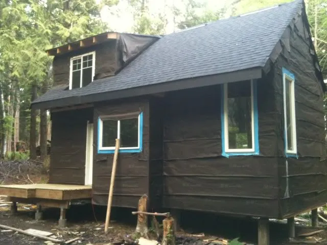

Just a thought as I look at the roof.  Be sure you have used a drip edge on top of your fascia board.  That will be important when you install your gutters.  Also, don't forget the rake edge along the fascia on your rafters.
Buddamonk
 [cool] Good job buddy looks like you guys got a lot of work done yesterday!! Roof line looks fine, it looks plenty straight from the ground. Any word on those 3"x8"s did you guys move the rest of them out to site on Thursday?

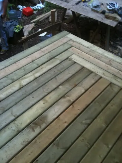

herring bone detail of front stoop
