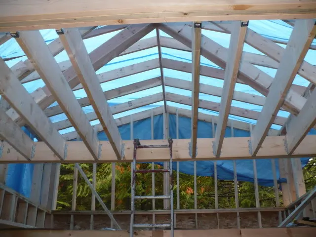

The loft framed up, that 2x6 in the left of the photo is a temporary support that we will replace with a log we have drying
Ledger board notch

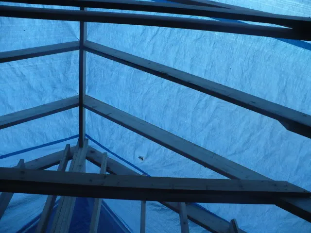

2x8 rafters, 2x10 ridge, 10/12 pitch with doubled up 2x6 collar ties
the roof is more mellow in the loft
the second loft viewed from the original loft, we are planning on having beds on either side with a gap in the middle

The steep portion of our roof seen in the last photo is supported by two double color ties made from 2X6 these are spaced 4 feet apart. then we have two 6X10 built up beams that span the cabin these are spaced 8 feet apart and are attached to the ceiling rafters sitting on the top plate these are also going to support a small extra loft.
does anyone have any structural opinions on this do the rafters do the same job as the ceiling joists were thinking about putting another small collar tie at the top of each rafter pair to create a small attic.
Looking for some of the structural guys to give us some criticism/advice

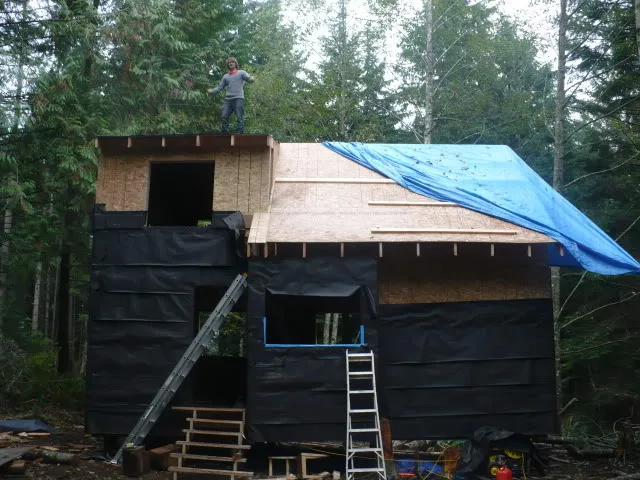

Never got a chance to dance on my subfloor so Ill just have to rock the roof!

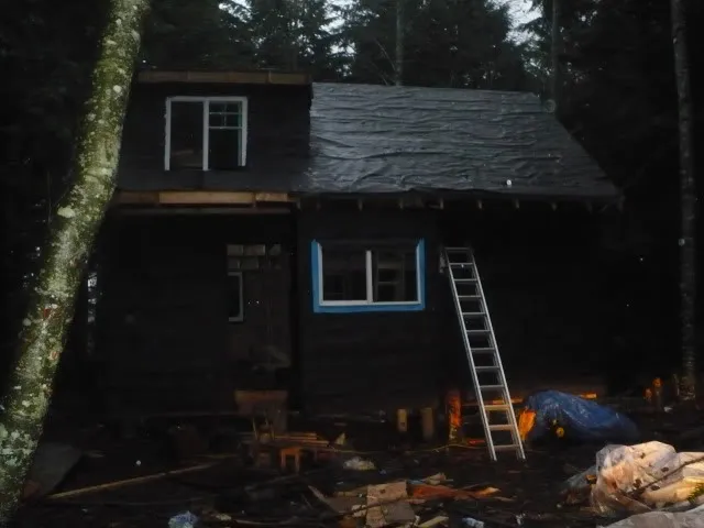

roof over hang extended over now
and the back of the cabin we are going to have a large 12 X26 covered deck here.
Ive kind of started slowing down because I havnt always been sure what to work on lately or how to do things.  Ive been getting a little burnt out.  like others I wasnt sure what to do for my gable over hang so I didnt extand anything out for my barge rafter.  I think Im gonna use corbels to hold it up.  were at about 5000 here but we have the roof matierial and facia trim all bought. I might just roof it like this and take a break for a while.

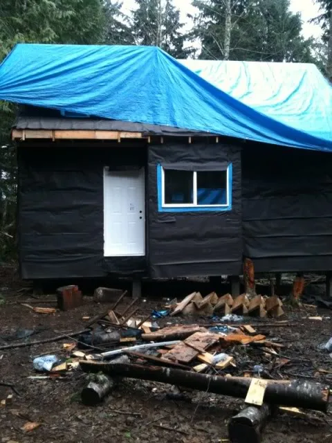

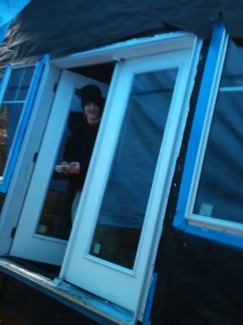

Finally got are front and back doors in
The front door probably gonna paint it red one day

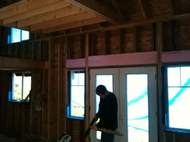

The french doors!  These took us forever to install it was a bitch to get them to close properly.

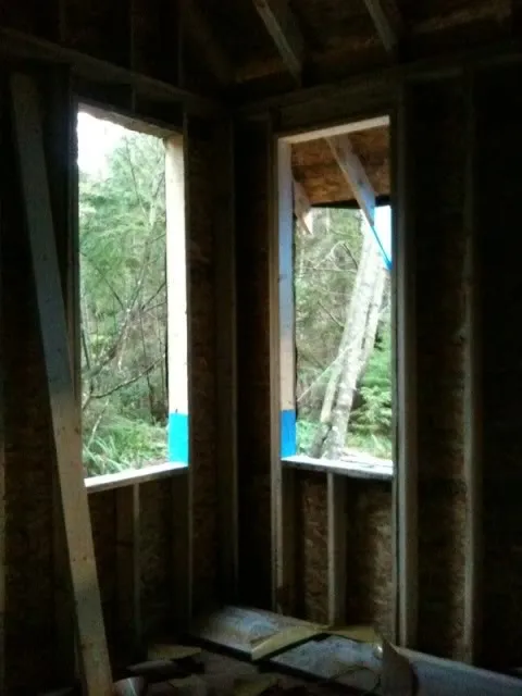

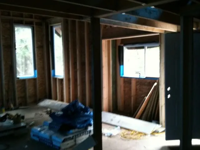

Two new window opening. Were gonna ad two more tomorrow
So much better with all this light

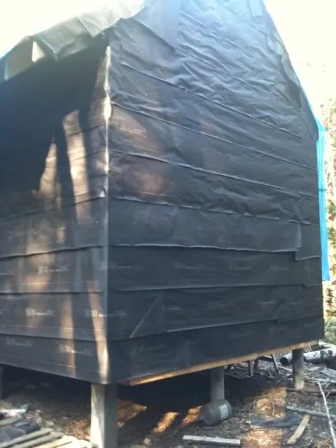

View of the backwall
View of the corner I was standing in the last photo
view of the new windows we have added

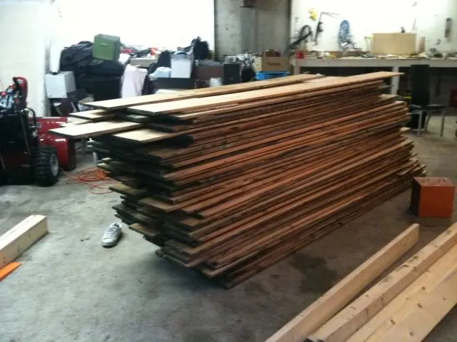

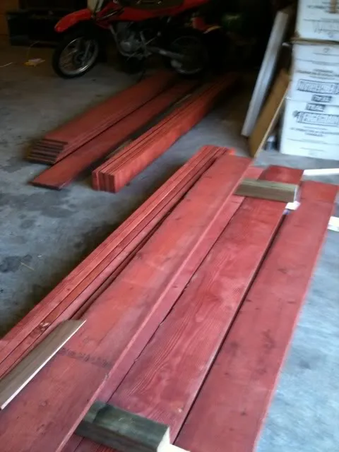

we picked the boards for the siding. It's cheap 1x10 SPF we spent two hours picking through the crap.  We are going to stain it on both sides then slap it up then batten it.  This stuff was around 40 cents a foot cedar being around 2 bucks for the foot.

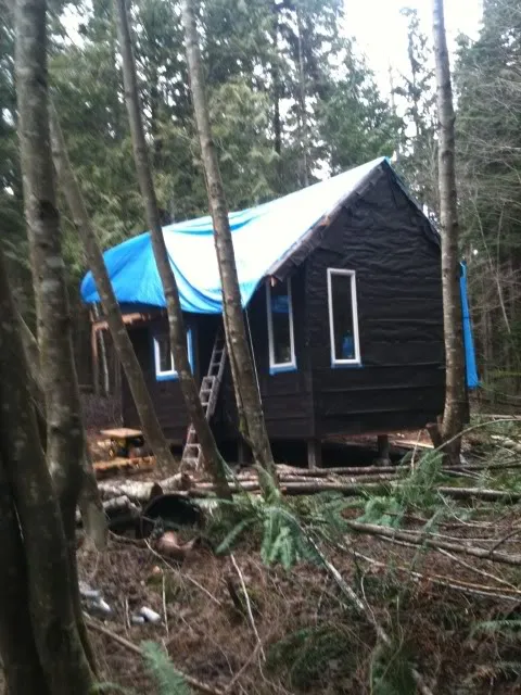

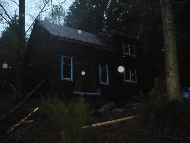

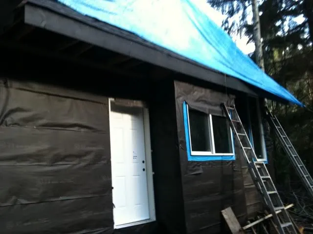

We got some facia up on the front of the cabin

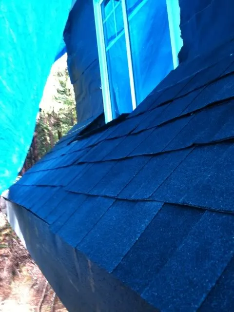

started doing a little roofing so far I like the look of the shingles

these are the boards
were using for siding now
we
just need to turn these into these
we've got 100 to go

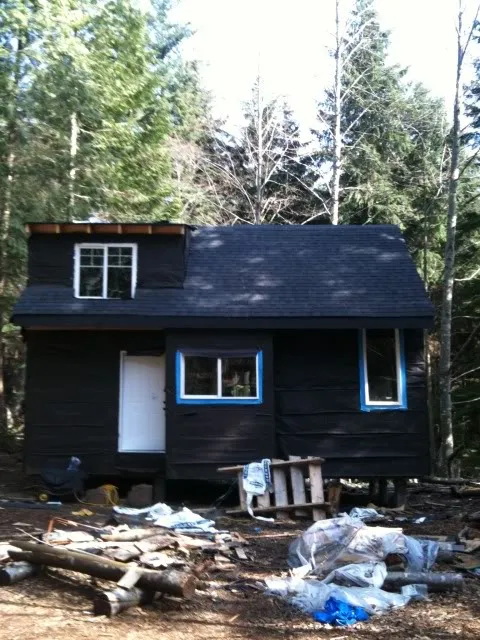

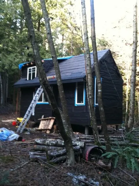

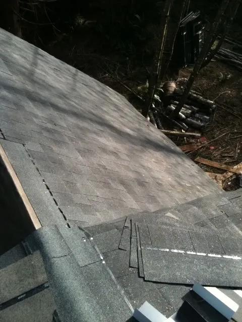

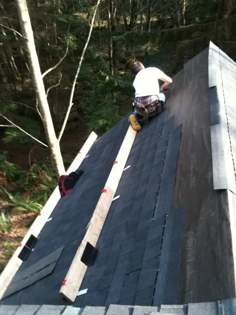

I finally got a day to go work on my cabin. Bobcat and I got the roof nearly finished, its completely shingled except for the ridge.  I am hoping to put in the ridge vents and finish shingling the ridge on Sunday.  I have to say I kind of liked roofing it was easy on the mind and we got to be in the sun all day 8).  Here are some progress pics.
you can see here the shingle line isn't that straight but I am still very happy. it was hard to get up there after falling off my roof last year d*.   I cant wait to see it with some siding, we scored four boxes of prime cedar shingles that were going to use for the dormers and Gables above the belly band and the rest will be board in batten. I'm just so sick of it being a big black box.

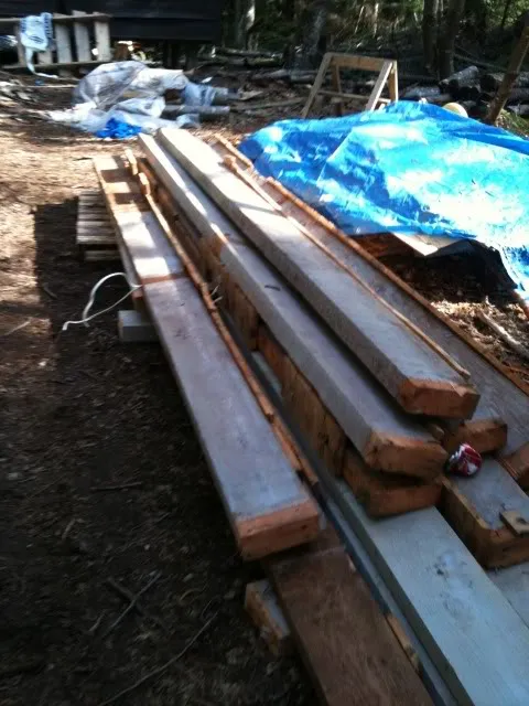

Budda Monk and I salvaged these fir beams from a cabin we tore down;  They are 3" by 8".  I really want to use them for a covered porch I am planning to build.  The porch is going to be 26 feet long and I wont be able to get 16 of them because they are going to a few different places.  Does anyone have any opinions on running the as rafters 4 feet on center then sheathing over with 2X10  there will be a moderate snow load as this part of the roof will have a very low pitch.  I just really want to use these they will look awesome after there cleaned up and sanded so I'm looking for some cool ideas.
