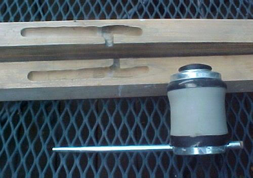

The dust I had bought is called Drione, I also bought this applicator with it to shoot the powder into their tunnels. Can't say yet whether it works, and it is an after the fact poison I guess.
I had sliced open a board to show what they do in case anyone had never dissected their damage before. This is not all that deep, they can go alot further. Woodpeckers sometimes then go after the holes and really make a mess.
