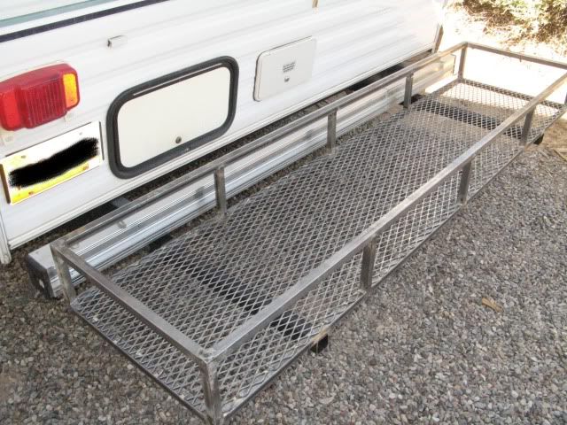

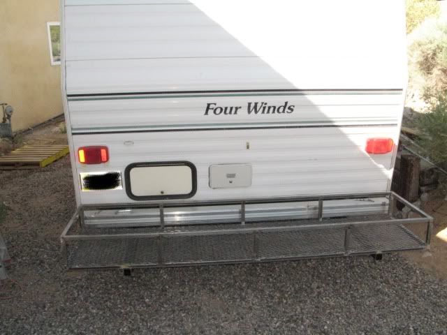

I've wanted one of these for awhile.  I went to Harbor freight and bought their receiver basket, but when I got home and put it behind my trailer it just looked silly.  So I pulled out my wire welder and got after a custom one.  I'm not much of a welder... but I can sort of stick two pieces of metal together once in awhile without burning holes through the tubing.  Actually, by the time I was done with this, my beads were looking pretty good.  Oh.... and I wore leather and didn't get any third degree burns.  Ahem.
It's just shy of 8' long, and is 24" wide by 8" deep.  I welded two receivers onto the main beams of my trailer so I could slide this on and off as required.
I'll have to watch where I tow a bit, as I don't want to be dragging.....
I still need to wire brush it and paint it, and I am going to fasten the basket to the receiver tubes with some grade 8 bolts just to be on the safe side.  Total cost was $180 plus a day of my life.

Nice job Shooter [cool]
Not to be a know it all, but you might what to drill little weep holes under the frame tubes. If you don't and water or condensation gets in them after one winter your sq. tubes will be round and they might split.
If you weld the expanded metal in evey spot it will make the frame more rigid.
You might need a brace across the middle for coolers, beer and fire wood.
have fun,W

Frank looks good. I will have to agree with Whitlock and add a horizontal brace mid center of the two receivers and maybe a couple gussets at each end.  Yes it looks sturdy but being on the "tailend" it will bounce a bit and lord knows I wouldn't want youor welds to break. ;D

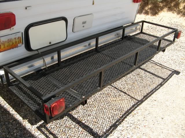

You might consider mounting a couple of lights in the back corners of the basket to be auxillary when you stack all that beer and firewood up to conceal the trailer lights.  d*

These are great ideas...
A cross brace the long way or the short way in the middle?  I am thinking the short way...   I like the idea of putting duplicate lights on it.  Maybe I'll put backup lights on it too so i can see better when backing.  I didn't think of the weep holes... another good idea.  I'll need to do this before I put my 9000lb porta-band away.
Okay... more welding.  Oh... and I am planning on bolting the cage to the receiver tubes too.
Excellent idea on the weep holes. Even here in this desert it freezes. The tire rack I welded up several years ago developed some rounding of the lower ends of some of the square tubing after s few years.  >:(  Nothing broke but there was water in them when I drilled holes.
Looks good BTW. Though it's a guaranteed dragger on my road in.

Okay... finished.  I wonder how long it will take before I get a ticket because the gear in my basket is obscuring my license plate?  But seeing as how that plate is all blurry anyway, why would they care?
I guess I could move the plate to the basket carrier, but then it would not be permanently mounted to my trailer.  Hmmm...
Acid test coming up soon for a quick weekend camptrip.  I'll load it to the gills and bounce it down the road.
