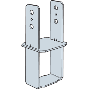

This is the bracket I used

  Lookin good , maybe you should have used a CB 44 bracket ,
  http://www.strongtie.com/products/connectors/lcb-cb.asp
   More up lift strenght.
To late now but some one else might read this in  a high wind area uplift is your enemy!
That being said IF you place ends up in the path of one of your tornado's nuttins gonna hold it down.

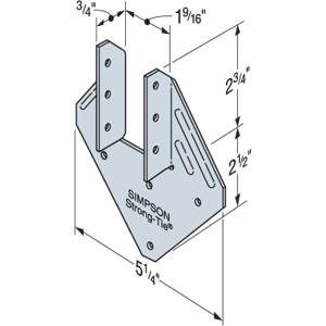

Will you be using H-1 on your floor joist to beam connections , as well as your rafter to top plate connections?? It would be a good idea IMO.
  H1

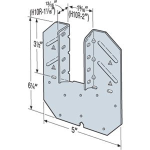

  Maybe even theses H10's  , more uplift strenght.
Link to Simpson page / more info:
  http://www.strongtie.com/products/connectors/H.asp

I had never seen the simpson's you show---wish I had, but too late now.  Likely I will be fine, though we do get a fair amount of wind and tornados.  Maybe I'll play it double safe and use some of the mobile home auger tie-down things underneath.
I am planning to use the H1 brackets for the roof/floor joists.

Just need to finish the other outrigger and put H1 simpson brackets on the rafters---then will be ready for roof.
