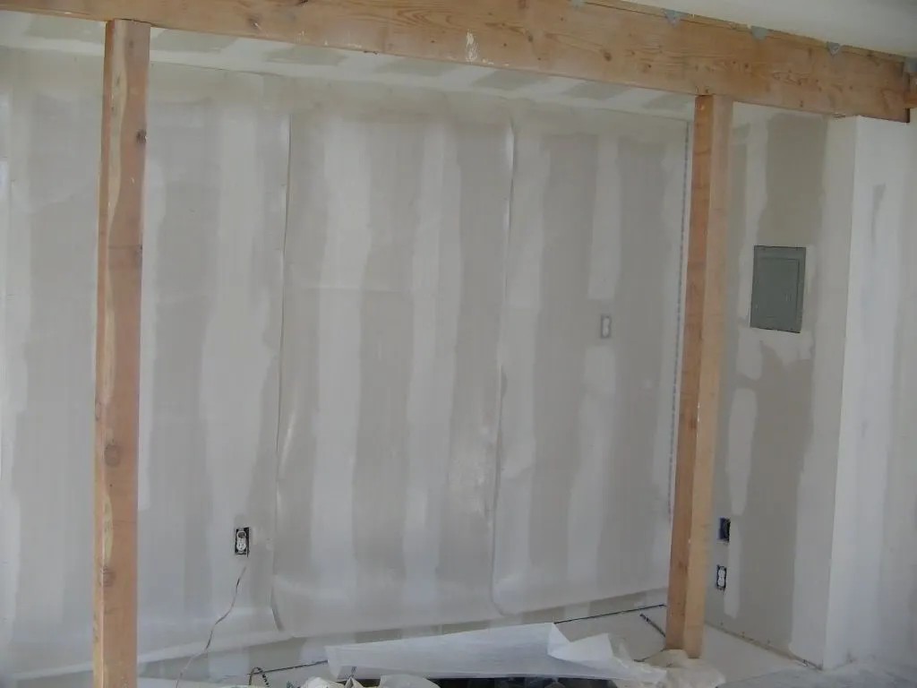

Making progress.  Finished the first layer of sheetrock and decided to lay another layer on top of that.  I put a layer of foam between them.  I just used laminate floor underlayment stapled to the first layer and put the second layer of rock on top of that.  Hopefully will decouple the layers and block more sound.  One of the pics below shows the underlayment layer.

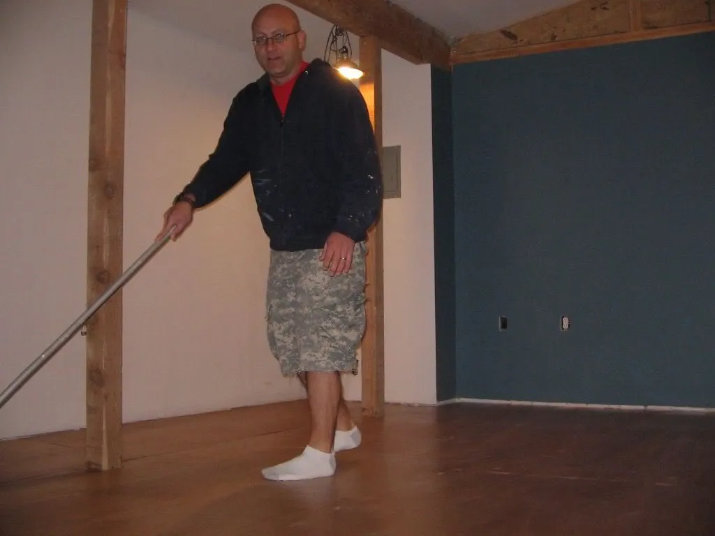

After painting the rock I installed a layer of foam underlayment on the floor and shot in cheap luan plywood over that.  Shot it in with a crown stapler.  Looks pretty good after four coats of poly.

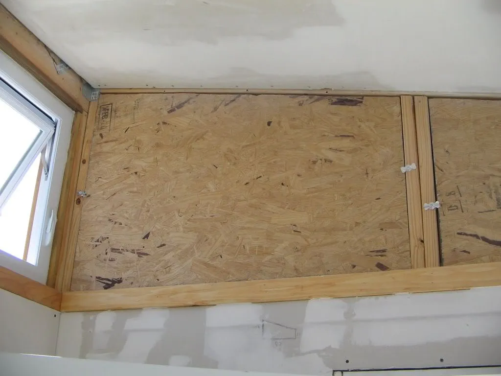

I really like the Lexan twinwall side windows but they bleed a lot of sound.  I have cut removable panels backed with compressed owens corning fiberglass board to fit in the windows

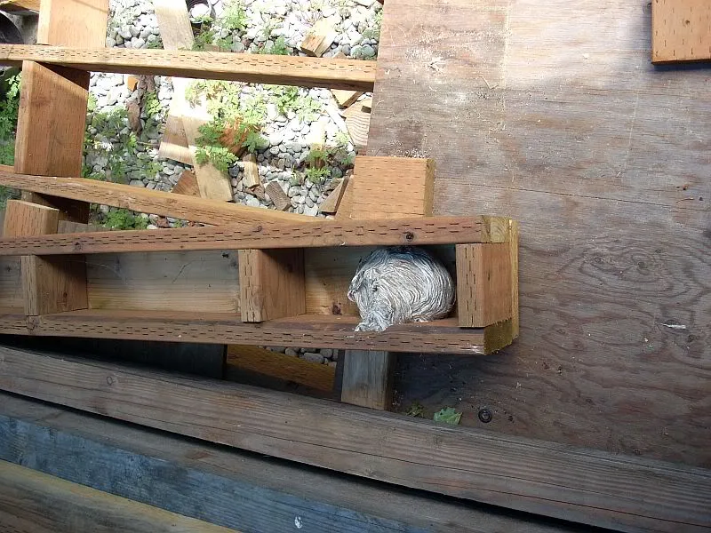

Your manshed looks very awesome..Great place to hide out!  I love the look of the siding that you and ScottA did, but have a small question-  What keeps the wasps out?  (Maybe you don't have wasps there?)  I live in Southern Missouri, and I'm afraid that would be one gigantic wasp nest, with all the tiny gaps.  They get in any tiny space that's out of the weather and sun.  Got any ideas how that could be solved?
markert2523
 Cindge,  I plan to live in harmony with the wasps and mud dobbers.  And maybe get some of that spray that shoots 10 feet!!
Pine Cone
Wasp spray is a builder and homeowner's friend ;D
This is a nest I had to deal with in one of my wall-module building forms.  I used most of a can of wasp spray on it just to be sure...

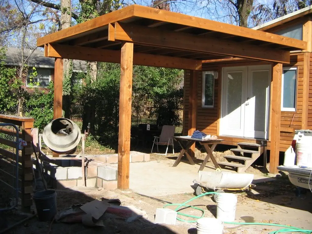

Finally got around to starting the pergola for the manshed.  14x16' with beam span of 14' and joist span of about 10'.  All cedar.  6x6" posts are set in concrete with gravel at bottom of holes.  It looks like I set them into sono tubes but these sono tube "rings" are actually 3" sections cut from a 12" diameter sono tube.  After I filled the holes with concrete I slipped these sono tube sections over the top of the posts and then filled them with concrete.  I did that to elevate the concrete at the post bottoms off the grade.  Sure it would have been better to pour a concrete footing and anchor the posts with simpson brackets, but I suspect I'll get a good 20 yrs out of these before they rot and likely another 10 yrs after that before it falls down!
The beams (double 2x12") have a 3" height difference.  I plan to cover the joists with rolled bamboo screen and then top that with clear lexan corrugated roof panels.  With such a low pitch it won't be watertight but should be good enough.  Not sure if I can describe this well but the perimeter fascia boards are 1x8" while the joists are 2x6".  That leaves me some depth to drop in the lexan panels where they won't be seen from the side.

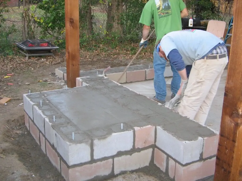

Hey folks,

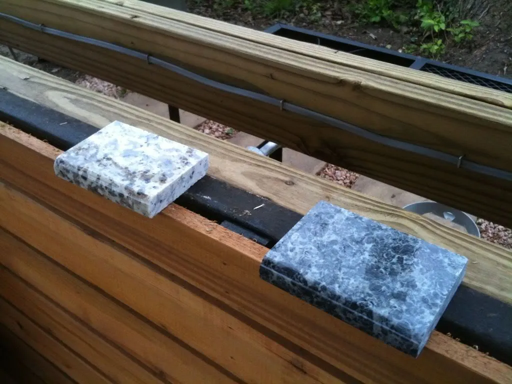

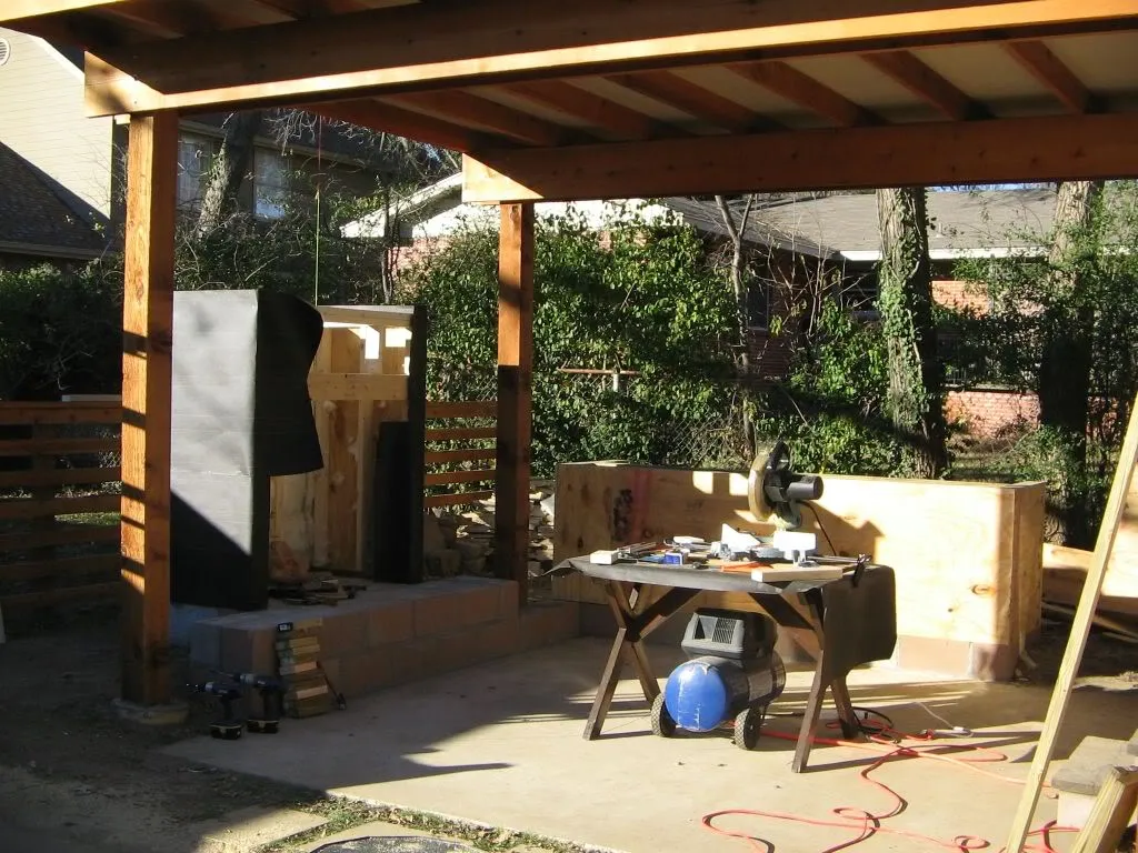

Been working on the manshed the last few months and wanted to update the thread.  Finished the pergola with a hard roof.  Hired a contractor to pour a footing and build block base for the fireplace and cooking island.  I framed up the fireplace and used an indoor insert for the firebox.  Really almost done except waiting for the granite to get cut for the fireplace hearth and island top.
I picked the lighter color for the granite
Enjoying the fruits of my labor.
