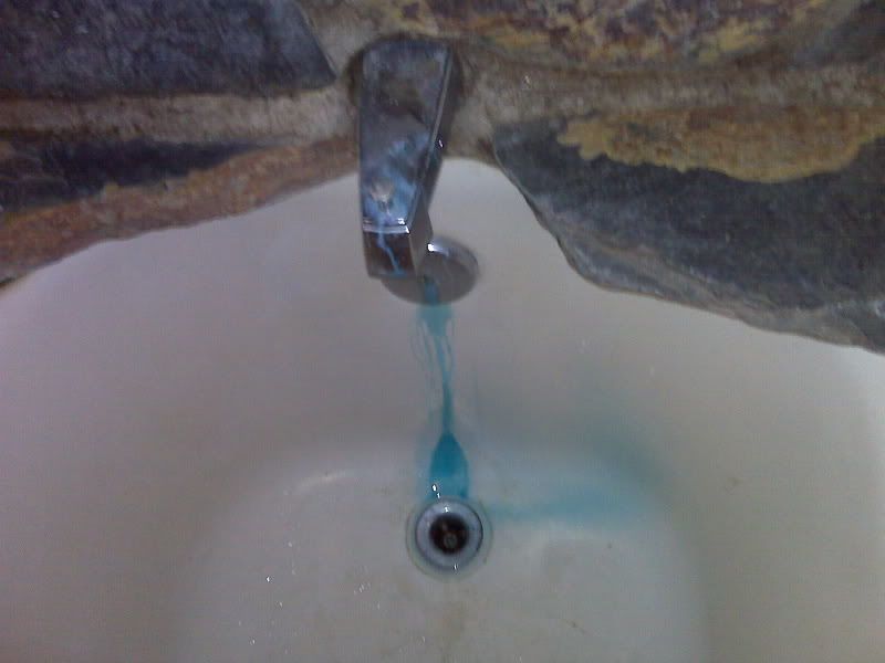

I have a customer I am doing the same for but it is hard copper pipe being dissolved by our water.  It actually leaves a blue streak in the tub and shower head as the water dissolves the copper.
The copper eventually gets as thin as foil then just starts spraying water from cracks.
Due to the slate surrounding the tub and shower I also did it from the back --- next to get under the house. d*

Hey Glenn, I just now saw that picture of the blue water..it is pretty but, were those folks drinking that stuff too??????????? I can't
believe that is very good for your inards!! But, that's just me, us originals never drink blue green water, unless it's from alkihaul.
Okie Bob
I once lived on an estate which had it's own natural spring.  Our whole bathtub looked like that.  I just thought it was laiden with minerals.  Funny when I built my new house I asked my son who was around three what he missed about living at the Lodge and he said he missed the "green bathtub"  rofl.  Since then the new owner has laid new lines to the spring (250,000 gal @ day) and is now selling it retail under the name of "Allegheny Mist".  At least it is spring water and not from the Atlanta water supply as some are.
Okie BoB, I think she gets bottled water.  Nothing wrong with the water by itself I don't think but when combined with the copper pipe it is bound to be very heavy on copper.  As I understand it, it is likely acidic and just dissolves the copper.
