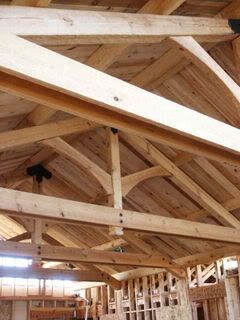

Two years is reasonable.  I built a 1600ft addition with timber trim and had it done in 3 years while working a full time job, and keeping up with two kids / vacations / travel for work / other activities.  I did hire a framing carpenter to help give me a push with framing the ceiling... he set the purlins and decked it with the roughcut.  He also helped for a month on odds and ends.  I did hire out the insulation and sheetrock too.
Here's the ceiling done.  I hung the timber trusses with a buddy.  That was an exciting day for me...

Good looking ceiling shooter [cool]
What's the dimensions and spaceing of the rafters, purloins, collor ties, braces, and are the collor ties let in to the rafters? Local cut timbers?
Mike
That is looking very nice Frank. Very nice indeed!  :)
Thanks... that room is 25' X 40'.
The trusses were fabricated by Adobe Building Supply in Albuquerque:  http://www.abslumber.com/
They are not structural.  There are scissor trusses above them.  If they were to be structural, code wanted me to change the design.
The planking and purlins were cut by the Rose family at their sawmill near Raton, NM.  So all the wood is local grown.
The trusses are spaced 8' apart, and are 8' from the end walls.  The collar ties are actually lofted up from the tails of the rafters, as I wanted a little more headroom there.  I now have low voltage halogen cable lights that run the span underneath the trusses.
Without climbing up to measure, the purlins look about 5' apart.
I have only a little carpentry experience... a decent carpenter could have framed this all with much less wood.  But I saved a truckload of money doing it myself, and it is very strong.  In our 50mph spring winds the rest of my house groans, but this addition is silent.

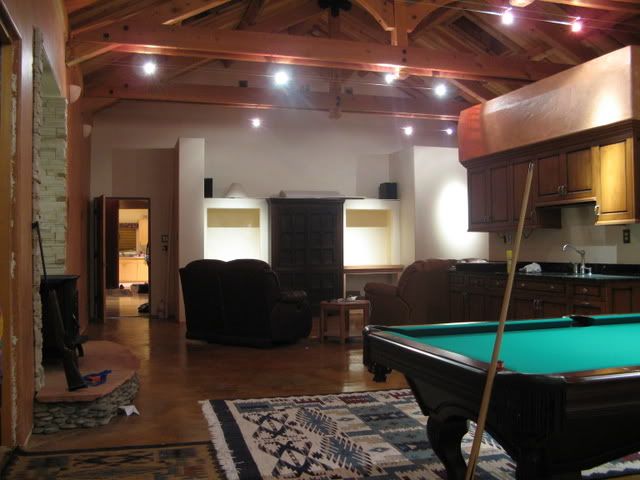

Same room 2 years later.  Still under construction but useable.  No comments about the dishes in the kitchen sink please.  BTW... the build-in structure in the room is a half bath you access from a hall off to the far right that also accesses the in-law room.
