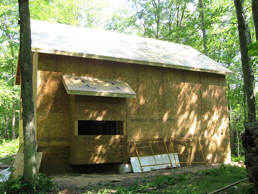

We spent the last couple weekends getting the eaves, roof sheeting and underlayment on.  See photo album at: http://picasaweb.google.com/jerry.wenzel/Cabin for more pics.
I took PEG's advice and got the last 1/4" of sway out of the knee walls.  I think the rafters and eaves are straighter because of it.
This was my first experience with synthetic underlayment.  With the exception of having to pound a lot of plastic capped nails, this stuff was nice to work with.
I used Permafelt.  Its rated for 6 months of exposure and I had a hard time pulling it off a 8d nail let alone a plastic capped nail.  The literature said it reduces slippage and I had my doubts that plastic was going to be less slippery than the wood roof sheeting.  But, it is "grippy". The nearest I can explain is its coated with something like the glue on Post-It notes.  It was on sale for $90 for a 10 square roll which I could easily carry the roll up the ladder and the 1 roll covered the whole roof.
This is a good way for those of us who can't get the finished roof on right away to protect our cabins and not have to worry about a storm blowing off tar paper.

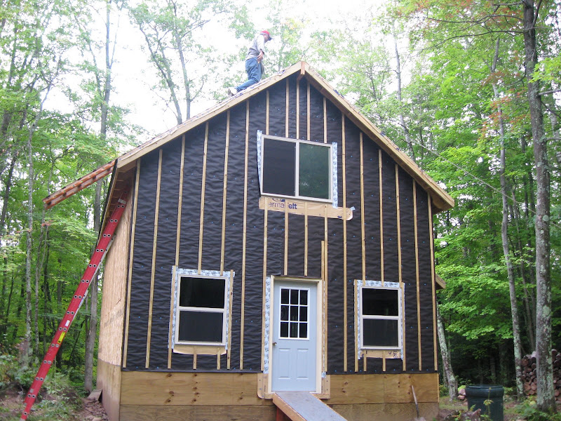

I'm ready to install a weather proof barrier on the exterior walls of our cabin.  This forum and other sources on the internet have me thinking that black felt is a better long term solution than house wrap.  This is mainly in regards to the felt's ability to get rid of liquid moisture in the wall system better than house wrap.
Also, the forum & ScottA have turned me on to the concept of a rain screen. Which, while its more work, seems like a good way of dealing with moisture that will get behind most types of siding during periods of wind blown rain.
Here is what I'm planning to do:
Cover the cabin with 2 layers of building felt.  The felt could be exposed from now to next spring so I want the outer layer to take the beating from the elements and the inner layer to stay pristine and water proof.
I would install the vinyl windows on top of the felt and use bitumen tape to seal the window flanges to the felt.  The vinyl windows have a built in brick mould which is about 1.25" thick.
Using 2" wide furring strips cut from 1/2" PT Plywood, put vertical strips up every 16" O.C.  The furring strips would extend up into the soffit space to vent the top of the air space. (I realize I need to use special fasteners with the new pressure treated formula)
This would get a dried in cabin and I'd do the next steps just prior to siding.
I planned on putting a wainscoting of corrugated metal siding up 4' from the bottom of the cabin. The bottom of this metal will likely be embedded in decorative gravel around the cabin.  This would be covering the lower 4' of sheeting which is pressure treated .  I would not have the airspace behind this metal only the felt.  Instead the air space/rain wall would end and drain slightly above the flashing on top of the metal wainscoting.
I plan on using wide 2x6 trim around the windows and at the intersection of the wall and the soffit.  At the soffit the trim would sit on top of the furring strips and the airspace behind it would be screened to allow air, but not bugs to flow from the top of the rain space into the soffit space.  The bottom opening will also be screened.
I'm planning on putting a rabbet joint on the vertical window trim to hide the edges of the cement or vinyl siding.
At the windows, I would apply caulk between the brick mould of the window and the trim which would extend beyond the thickness of the brick mould.
The top of the trim would have Z flashing installed.
Cement or vinyl siding would then be installed over the furring strips.
I'm looking for feedback on any pitfalls on my approach and thoughts on whether cement of vinyl siding may have problems with support across 16" OC furring strips.

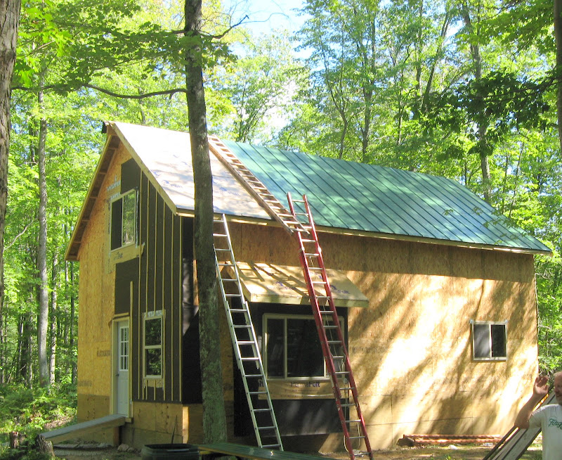

After an August break to catch a couple weekends of vacation, we started back up on the cabin.

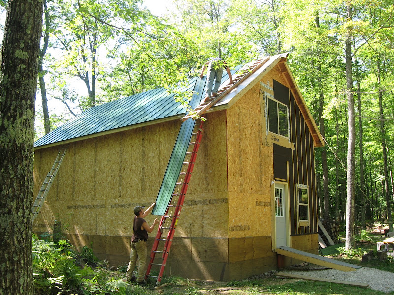

Here we started the standing seam roof.
The metal went on nice and fast.  The ridge was a different story, the standard ridge cap was not wide enough & once we got the wider ridge, straddling the ridge, not bending the ridge,  keeping the vent foam in place and trying to keep things straight was a challenge.
The rain screen on the front.

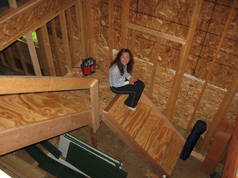

The staircase.

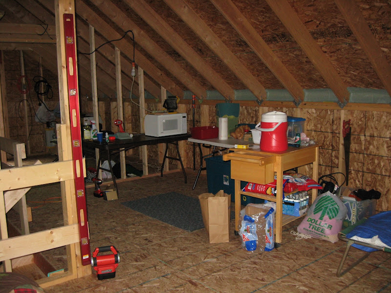

Temporary digs upstairs.
Even thought the nights have been in the 60 DegF range, the kids still get pretty cold without the insulation.  We bought the insulation and a woodstove and that will be our next project.
