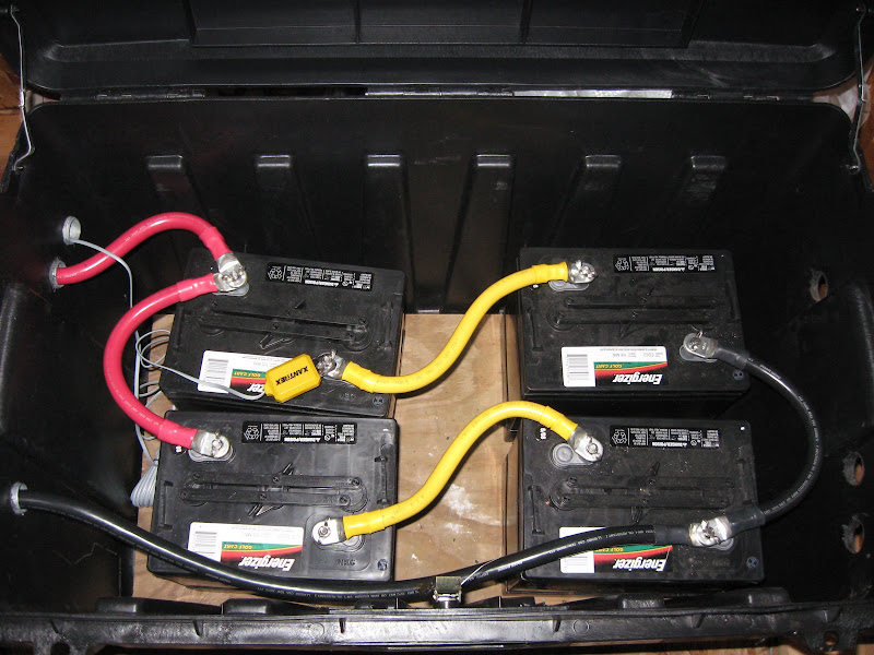

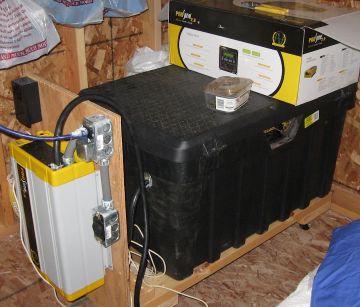

Here are some pics of our inverter system.  We have had it running for 2 trips now and its working good.  I'm using 4 6volt 225ah GC2 batteries and a Xantrex 2kW Prosine inverter/charger.  Its on wheels because I plan in keeping it under the landing of the stairs.  I have a standard 120V plug for temporary 120v connections but it will tie into the cabin's load center through the lower twistlock plug.  I also need to vent the battery case, which is a heavy plastic pickup truck toolbox.
It runs CFLs for hours without much of a voltage drop and handles a microwave without any issues.  The only issue I'm having now is my generator puts out about 85volts unloaded & the charger in the inverter sees this as a low voltage condition and won't begin charging.  I currently plug a 100W light bulb in the generator to put a load on it and get the voltage in the range the charger will see as OK to begin charging.
Jerry
I find a similar issue with my soft start Bosch Rotohammer.  I need to start a drill or other motor before it will start the first time - then after that it will restart until unplugged.
Some of these electronics are just too smart for their own good. d*

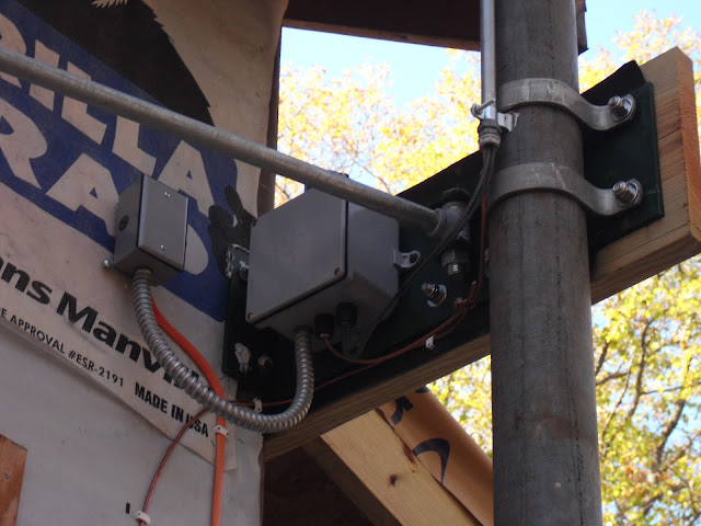

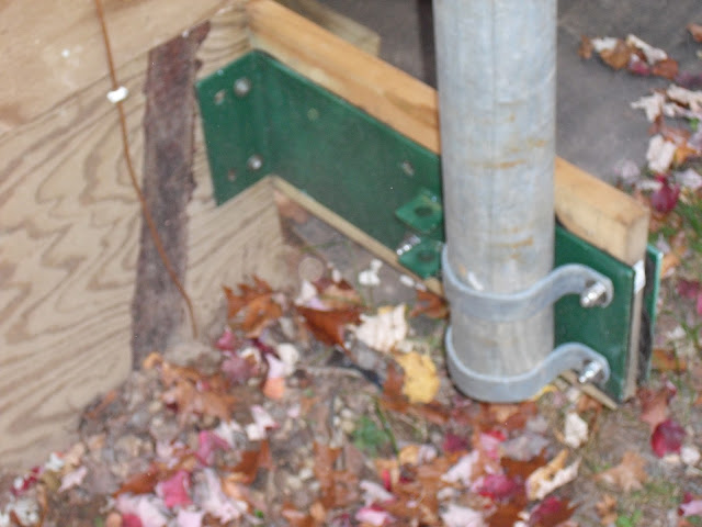

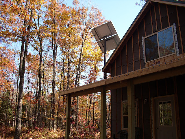

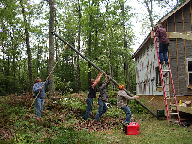

Being deep in the woods, finding a hole in the trees to get good solar exposure was a challenge.  After lots of observing, the best spot seemed to be on the corner of cabin.

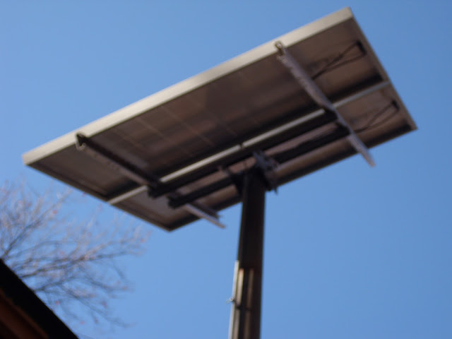

I installed a 20' 4" steel pole and put 320 watts of solar panels on top of the pole.  The panels are in series and put out 80 volts into an Outback FM60 charge controller.
Rasing the pole Iwo Jima style.
Upper pole bracket, J-Box & lightning arrestor.
Lower pole bracket. (Raised to prevent issues with frost heave)
Solar panels are up!

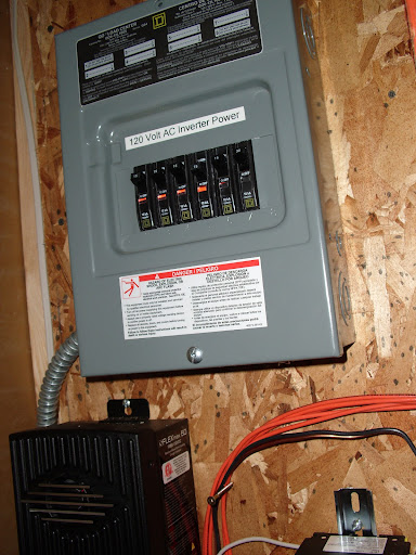

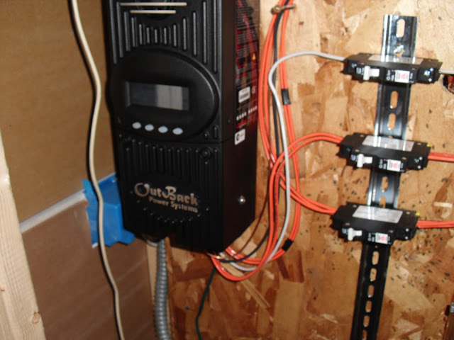

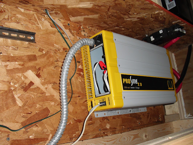

Also got the batteries and inverter permanently installed.  Still need to put a door on the front of the battery bank.
Prosine 2kW inverter.
Outback charge controller and DC breakers
120 volt breaker panel.

I like the all copper bus connections, and the DIN rail D.C. circuit breakers.

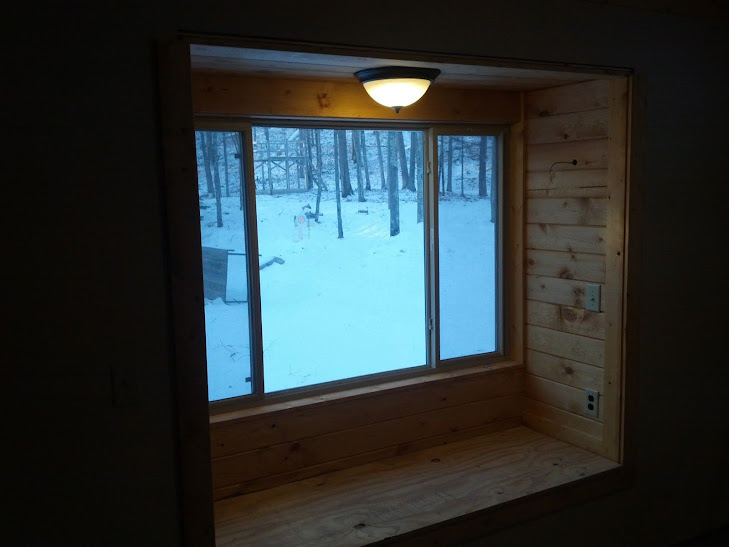

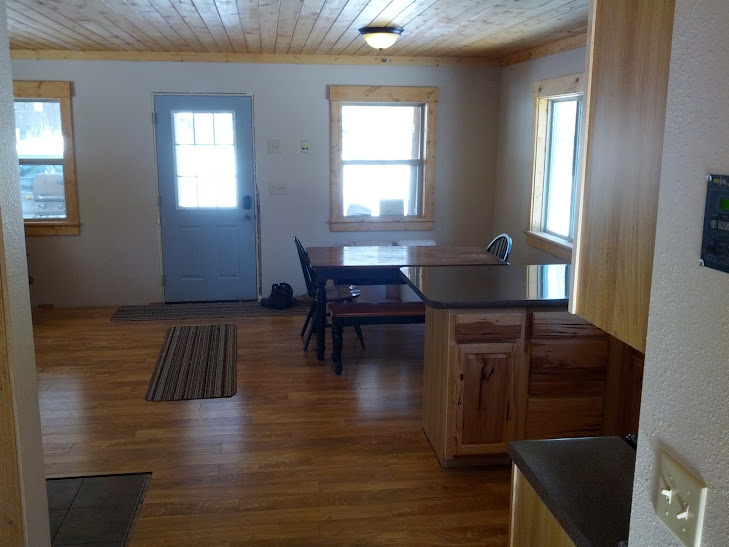

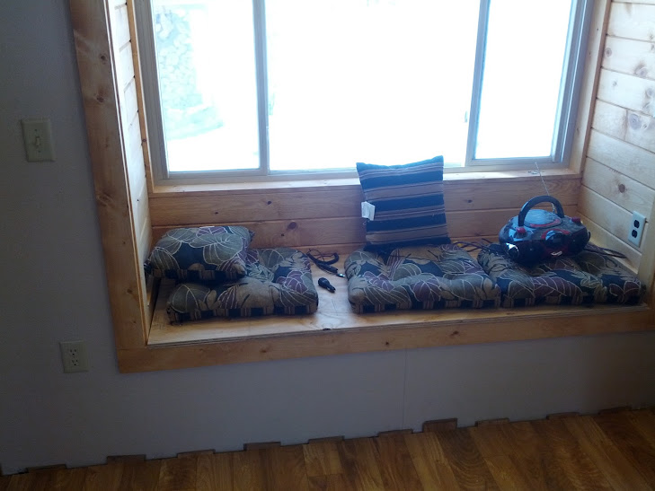

Window seat

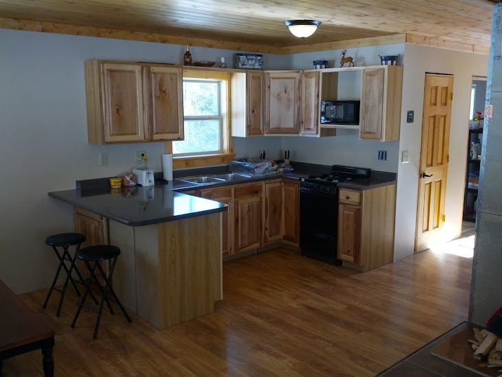

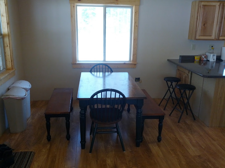

Kitchen, Its great to have a functioning place to cook
Dining

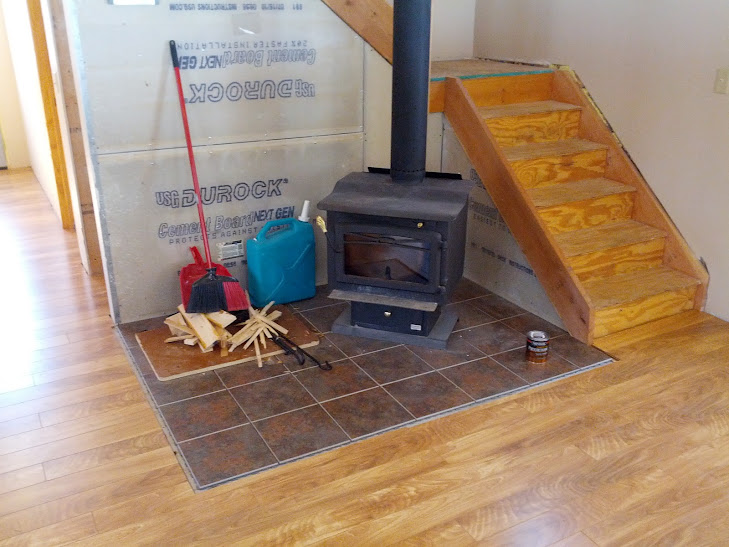

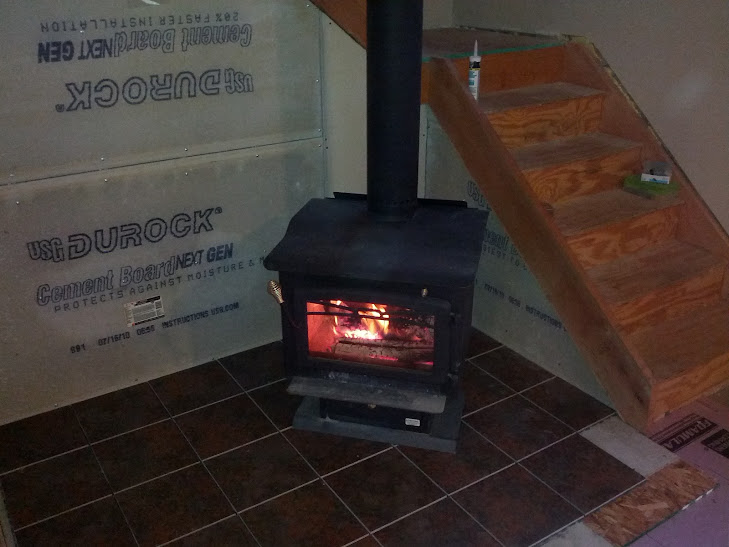

Wood stove

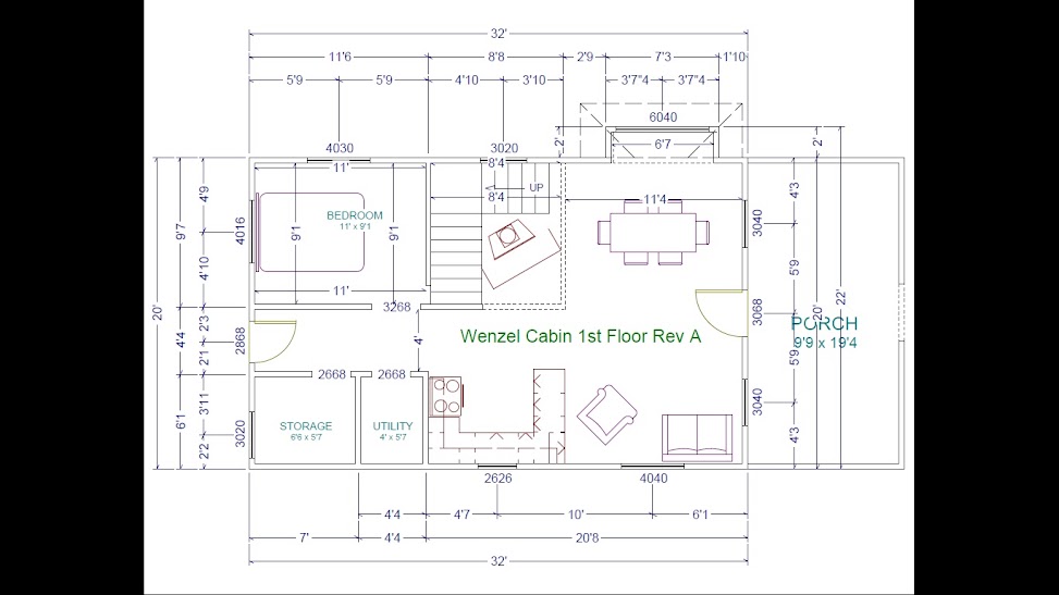

Here are 2 pictures of my 1st & 2nd floor plans.  The 1st floor storage room will become a bathroom.  The 1st floor utility room houses the batteries, inverter, charge controller, water pump, on-demand water heater and lots of shelves.
The second floor has 2 big bunk rooms, a small office and a 8x10 opening with the stairs and chimney coming through it.  It gives a open look from downstairs without consuming too much second floor small.  The bunk rooms are for the kids now, but could easily hold a couple adults and children once the kids have their own families.
If anyone would like these in PDF or 3D Home Architect format, please PM me.
