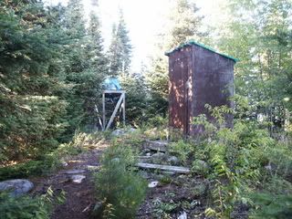

I visited an outpost cabin in Canada a few years ago that had a sweet offgrid setup.
For water, they had a honda pump with the wet end in the lake.  Once every 3 or 4 days we would run the pump to fill up a tank that was lifted up on a structure.  Here is a picture of the tank (and the privvy)
The tank was perched on the highest point on the island, but even so it was only maybe 6 feet above the shower head.  It fed a standard propane water tank in the cabin and the pressure was fine.  Not a blasting, needle like shower, but very adequate.
To prove to yourself how well water can flow with just a little head pressure, take a piece of 3/4 PVC, put a valve at the bottom, and experiment with filling it with water, holding it vertical, and draining the water.  You can get good flow with just a little bit of head pressure.
