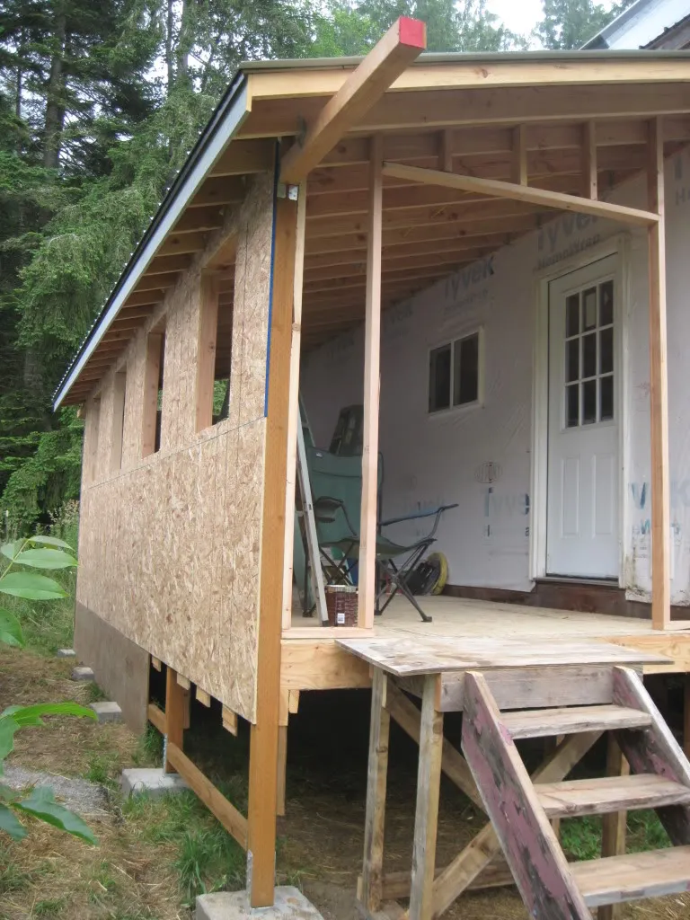

So - the sun porch is DONE.  This is the "magic moment" when the room is absolutely empty....before I start lugging the stuff out of the downstairs part of the cabin to finish the inside....before winter. (hopefully the gods are listening).
Jethro approves
Looks great!  You've been busy  c*  How much does that add to your square footage?
Nice room. Still have the windows to trim out?  It will make a nice place for the kitty's  ;)
Sassy, it adds approximately 192 sqft (8 x 24 less the wall thicknesses).
Redoverfarm, the windows are not trimmed because once this room gets elevated from "storage" to "living", that wall is going to have built in shelves and counters that seamlessly integrate with the window trim.  Under the windows will be shelves that store yarn for weaving and fabric for sewing.  The counters will serve as a cutting and ironing surface, and at one end be surfaced for the tiny wood stove...and between the windows will also be shelves.

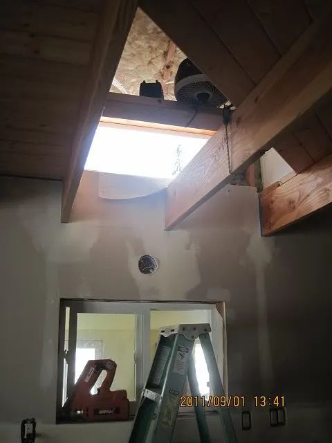

I wanted to show you'all the windows I stuck between the floors in the cabin.  They don't open, its all about light.  Storage is at a premium in a cabin one lives in year round.   Wall space is a great place for shelving and cabinets....at the sacrifice of windows and natural light.  So, here's what I'm doing.  This is just one little window, 14" by about 35"...it fits between the top of the sun porch roof and the bottom of the cabin roof eaves and in the "catwalk" part of the loft floor....It really lets a lot of light in, both up in the loft and on the main floor.  There will be 3 more in the stair well.

Good on the windows, Considerations.  :)
They are a lot like some of the ideas in the Underground Cabin.  Light from all four sides and it can come in high....well.... I guess that would be obvious, because in some places a low window would just be looking at dirt.... duuuhhhhh [ouch]
