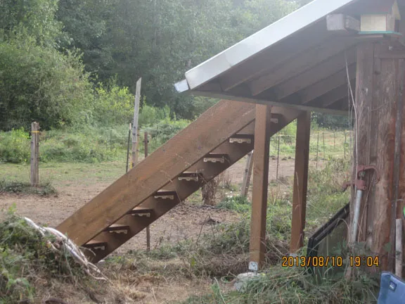

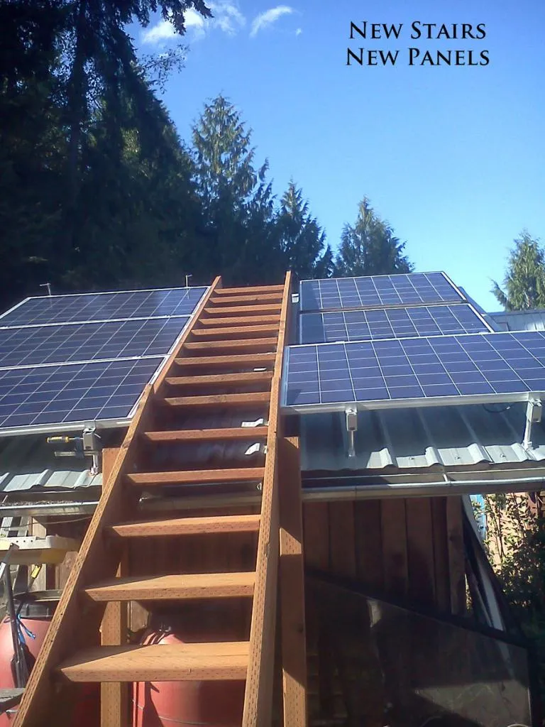

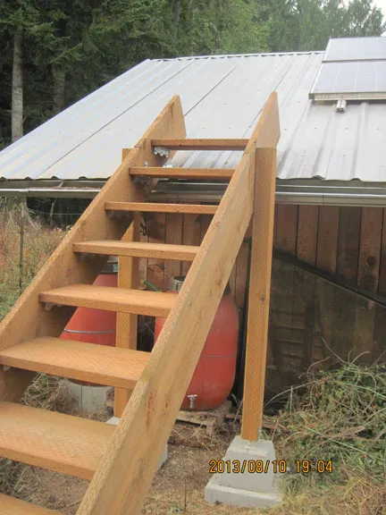

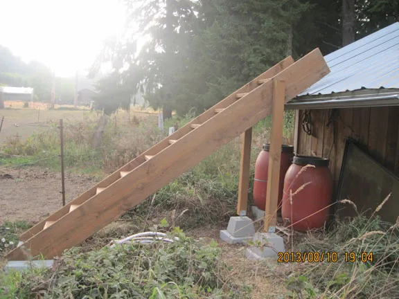

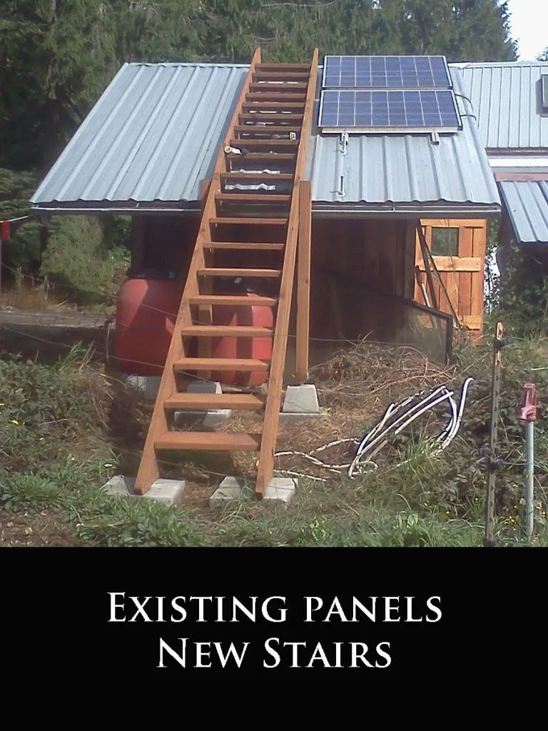

That being said..i got more solar panels and a charge controller to match..so now have started the install. Trying to think ahead got me doing a little geriactric engineering. The slope on the power shed is about 27 degrees and the first panels up were a scary project. 8 years later I have been staring at that slippery slope with a jaundiced eye...things are not getting easier...and they take longer.  So I decided to build a stairway from the ground right up the center to the roof...putting me between solar arrays on a level footing. Lots of benefits, handle the awkward stuff with a "ramp" (the top of the stringers) , and  ease of panel cleaning and maintenance later.
I got risers to make the top of the panels virtually flush with the top of the stringers to avoid shadows. I think its going to turn out OK even though it is a fairly tight fit all around.

Drum roll !!!!!!!!!!!!!  I have upgraded my power.
The stairs are done, the solar panels in place, the wiring done and the sun is shining!
Getting 5x what I was with just the 2 original panels..Whoopee!...I have extra.
Flipping on the breakers and powering up the first time was, well, tense...but it is working!   ;D

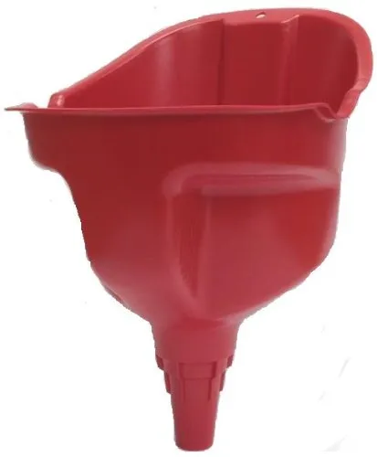

Finally-a solution!
This is the perfect solution for dealing with the new and totally weird fuel can spouts.
1 Open Gas Tank
2 Insert Funnel
3 Remove fuel can spout
4 Pour fuel into funnel, and therefore, into fuel tank.
The new fuel can spouts make transferring 5 gallons a 4 minute yoga exercise using a 40 pound weight.
That is, IF you can apply pressure to the spring loaded thingy in the spout.
and IF you don't care about not being able to drain the fuel can completely.
The above instructions cut the time to less than a minute.
No muss, no fuss...for 5 bucks.

Whew!  At first I thought that was one of those *ahem!* "female" urinals. . .   :o
Well, female urine devices are almost as much trouble as the latest EPA approved fuel cans.   ;D   But not quite.
