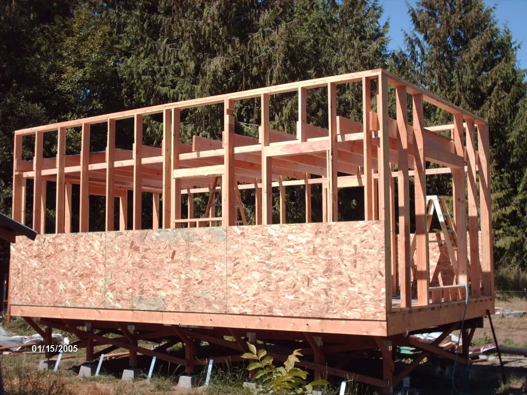

Progress is slow during the week, but the headers are going into place.  My neighbor borrowed his compressor back, so back to the hammer. Didn't take long to get out of practice with it.  Nailed my thumb.  Yagh.  I hit it so hard it is bruised on both sides, the nail is purple....ick.  I was doing so well, driving 3-1/4" nails and none of them bent.  Really got into it.

It is raining here, hard.  I stuck the ladder in the middle of the floor, and put a huge tarp over it and all of the floor except because the stud walls are up, I cannot cover the bottom plates and the floor under it.  Plus there is a row of OSB along the bottom of each long wall.
I know how to drain the tarp without getting the floor (except the edges) wet, because it started drizzling a few days ago.  The floor is 2x6 T&G.
Am I in trouble, or is some rain ok?
Or, how much trouble am I in?
Lots of work in what is up so far.
Not really healthy for it but not a total disaster.  It is nailed in place which will help hold it shape somewhat.  I would try to sweep the majority of the water off when it stops raining.  Then Mother nature (sun) will do the rest.  It may raise some or seperate at the joints but may go back since it's attached.
CF you need to hustle and get a roof on it.  If it were anything other than T&G I wouldn't worry as much but that is going to be your finished floor probably.
Oh I forgot you are in Wash State.  How far are you from getting the rafters up and sheeting?
  I'd  say,  no problem,  the T&G will take it , it may check some , but it's going to do that anyway , some what.
  Just sweep it out , make sure your bottom plates are nailed down well to the line you should have snapped and set the walls to , then cut out any door openings bottom plates and sweep the water out those holes in the plates. The door openings.
  Your going to have to sand the decks anyway once your done with your drywall and painting.
There's other tips like covering the floors with building paper AFTER you are in the dry to help some with the floors , but for now just let it rain it will dry out tomorrow , well maybe the next day  ;)
  At your current pace you should have the roof on and  ready shingled  / roof before the real rains start  in late Oct.

"How far are you from getting the rafters up and sheeting?"
2-3 weeks.  I was setting headers and top plates, then
ceiling joists
t&g Loft
rafters
sheets
metal
Yep 2-3 weeks....I set my dry in date as Oct 1, but my helpful neighbors say Sept 15 to beat the rain.

Got headers and cap rails on today.  Too tired to take a pic.  Tomorrow is ceiling joists.
I had to steal a 2 x 6 from the roof lumber pile.  Hope it wasn't a ledger board.  Yagh.
d*
Looking good considerations.  Don't forget to put your blocks over the window headers to distribute the weight.
I did cripples, in the places where the floor will end up going all the way to the wall.  But there are some open spaces in the loft floor, and I have to cut back and support those ceiling joists where they aren't going to reach all of the way.  So I didn't want to put any cripples up in those places just yet.
I need to think about that some.  If you go back to page one or two of this thread, you'll see the tentative flexible floor plan that shows them.    I have figured out how to do this in the stair well on the other side.  I need to think about the part over the kitchen.  I think I know what to do, but I will get the tape out tommorrow and do some measuring and thinking and balance it with the reality of what is there so far.
Thank you, however, for mentioning it.  It's easy to miss things.  At the end of a day, I'm tired, and just go inside and shower.  Then when its time to feed the horses, I clean up the site, and put away all the tools.  In the morning, when I'm bright and rested, I work on the puzzles.
Good progress. You might want to think about some braces now that you are going up to hold the walls plumb. Also did you notice the date is wrong on your camera?  d*
