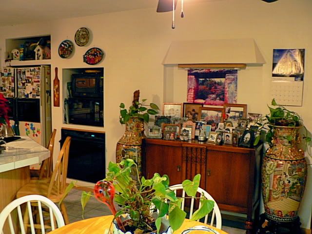

Here is a pix of a wall of built-ins I did at our other place about 10 years ago.  It was a remodel and we had a small kitchen and big bedrooms and utility room so things got changed.  Fridge back and broom closet went into utility room and oven and microwave backs went into the bedroom.  The picture display area is exactly as you mentioned to the point of adding a header and taking out a stud for a larger area.  We only had 2x4 walls there though.
Only problem with this is Sassy will really be after me for more storage here -- Oh well -- she is anyway.  I have some plans pretty soon.
This was before I learned chainsaw, and sledge hammer construction.

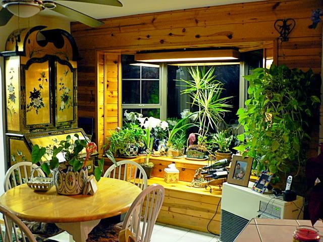

Bay windows are another nice feature in homes - Glenn's son had built a beautiful knotty pine window in the dining room; I had him take out the regular windows in the living room & put in bay windows there also.  Makes the rooms look much more spacious & you can display your knick knacks etc or depending where the window is, make a nice reading nook like some have done here in their cabins.

Wow, Sassy the urns in the first pic are beautiful!
