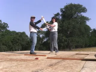

Well, here's our dancing on the floor picture.
I broke my break dance, so we'll have to settle for some local square dancing.
My jokes are almost as bad as yours, Glenn!

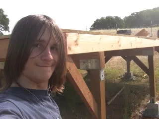

Here's that hippie that keeps hanging around calling me Dad, Daddy-o, or something.
Far out.
Keep practicing, Drew -- soon they will be as bad a mine.
Looking good Drew.  Once the deck is on you can start to see some progress.
Looks good Drew. Now you'll have to build walls. No end to the fun.  8)
