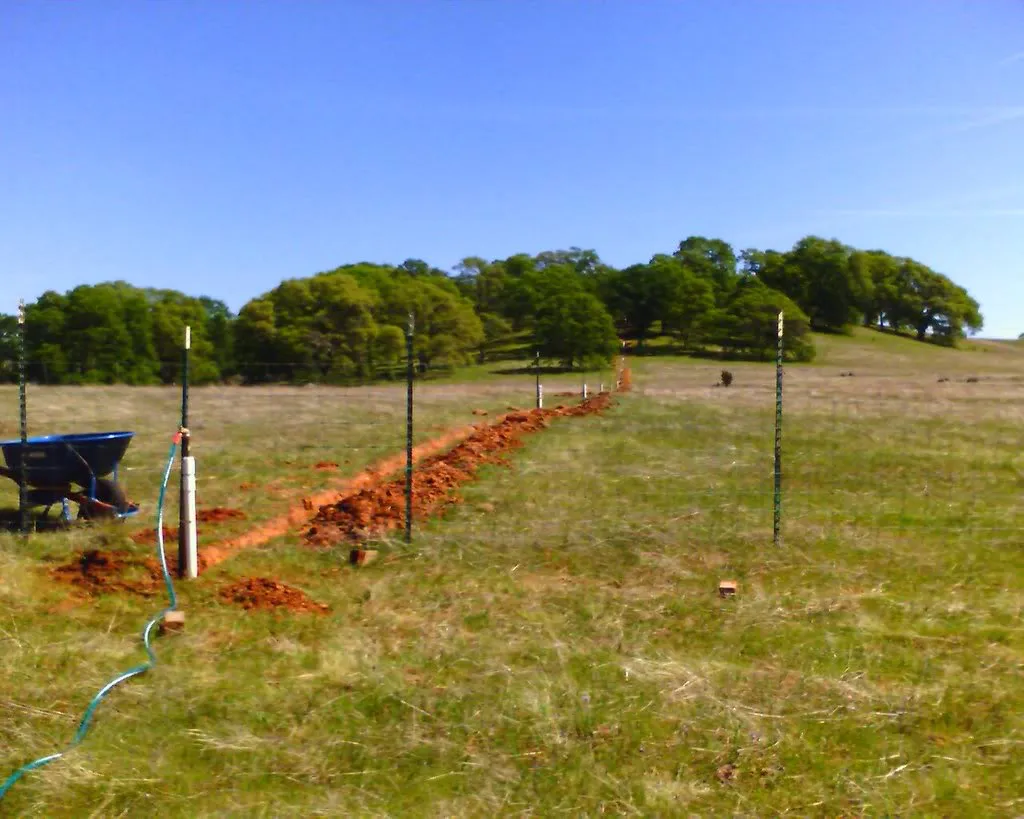

Anyway, we dug the sod off for the complete 610' run from the tank to the fence near the lodge.  We're digging to 12" and have about 40% of the trench at that depth.  Another couple of crew days with a little rain before the work day should be all we need to finish.  That would be 4 crew days for 610' of 12" trench in clay.  Not too bad.
I'm still thinking about whether we want to do the last 150' run around the lodge after the lodge construction is complete so we don't have to work around it or even if it would be an issue.  Right now it is not a critical path issue, so I let it rest.

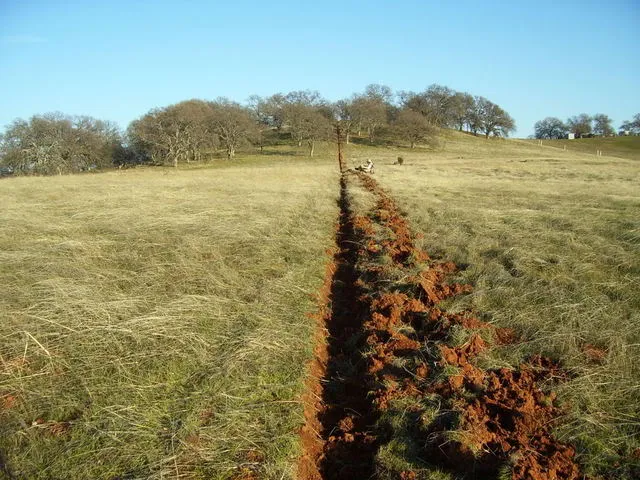

Here's the trench.  That's my dad in the chair.  We put the chair at the middle point between the two sections we were working on.  The "winner" got to sit down.

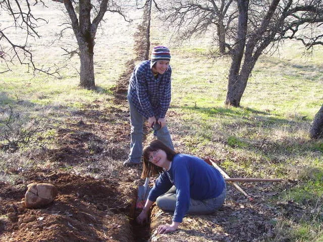

Dan and Robin worked on the hill.  This was the slowest, most thankless work of the day.  They busted more rocks than a gang at Sing Sing.  They still kept their sens of humor.  And all the cookies.
Drew I have to hand it to you all. Anything bigger than a post hole and I'm looking for a piece of machinery.
That's some serious will power. How did you keep it so straight? I couldn't keep that straight with a trencher.  [cool]
Drew
That's the thing, Scott.  We stretched a mason's line on 18" stakes, eyeballed it, and got going.  When you are digging 4" at a time, it's easy to correct. :D

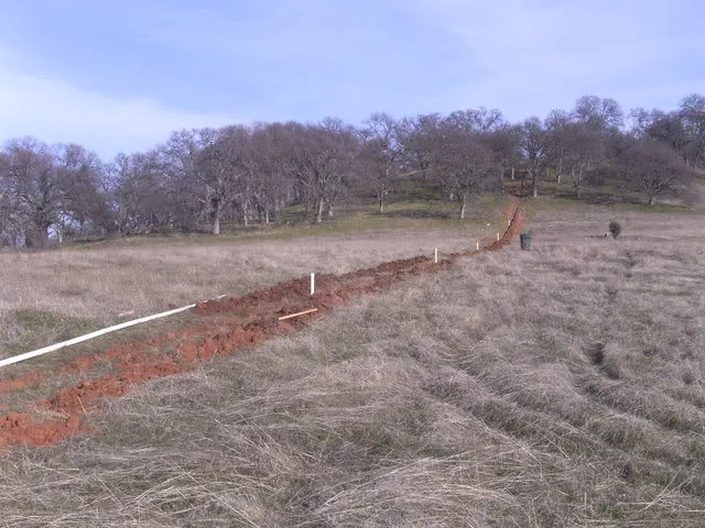

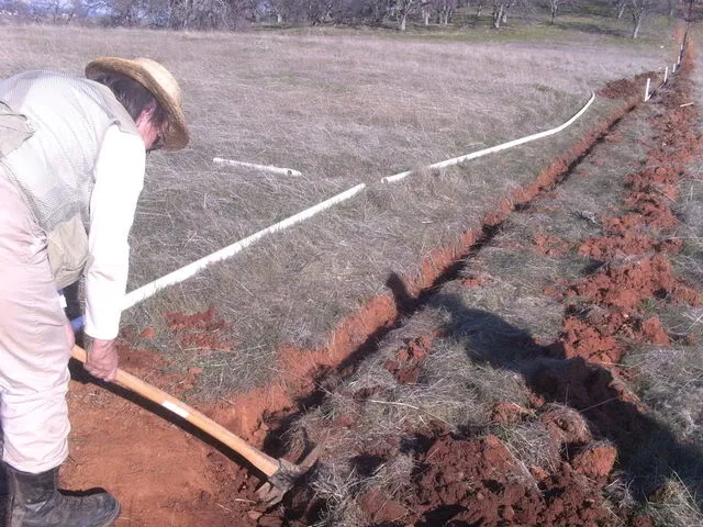

This time it was my dad, my son (Dave), and me.  Dave worked on the remaining trenching while the Old Man and I doped and laid pipe into the trench.  Here's a picture.  The vertical lines are the 2" risers.  They're on 60' centers.  The ones I don't need to use yet will have a cap on the top connected by a compression fitting.  The other ones will have a homemade manifold, also connected by a compression fitting.  That way I can move manifolds around, change them out, design new ones, and expand as I need to.  The whole system can deliver ~3,000 gph to 4.4 acres on this field.  I can expand it out at the end when I need to go further west into the trees.
The whole line was 610'.  We had our share of rock veins, but none so bad as this one.
That's the OM working on what we now call "Dave's Rock", a table about 4' x 2 1/2' or so.  No idea how far down it goes.

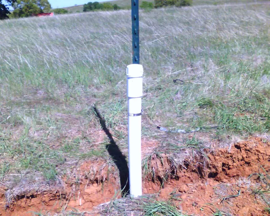

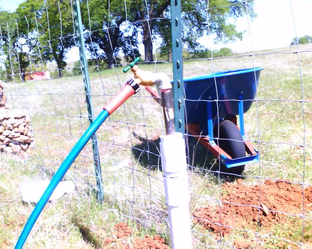

The mainline has seven risers on it.  In order for us to tell them apart, we gave them names.  The Old Man decided we should name them after presidents.
This is a Nixon.  Two bibs up in the air.  "I am not a crook!"  Yeah.
This is a Clinton.  The early manifold models were attached to the riser with a compression fitting.  When brought to pressure, this one, which was at the far end of the line, would pop off and make us stop everything else.
This is just an end cap on a riser, so it doesn't do anything.  We call it a Carter.
