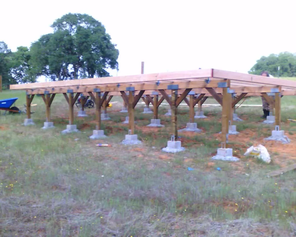

But the weather and fates were kind.  This is what it looked like when we finished a couple weekends ago.
On Friday I did the cross-braces, put concrete on the feet, got the floor materials, and nailed inmost of the Simpson brackets.  My dad came out Saturday and we put it all in place.  Check out the symetrically placed hurricane clips.  Yep.  If this thing blows away I plan to take an acre of dirt with me.
We got the first course of OSB in and ran out of adhesive.  I learned that my leftovers don't keep, even if they are still sealed.  That's okay.  Dan and Dave were bummed at missing all the fun.
Looking at the thing from the ground gives me a bad feeling in my gut.  One end always looks high, and that one end changes when you walk around the thing.  It has to do with the grade and the lines that trick the eye.  Still the level is bang on in every direction.  Then I stood on it and all those fears went away.  This was the only truly flat spot for hundreds of yards.  I could feel it in my feet and back.  And the level.
I'm trying to get everyone up there again at least for Saturday (More 4H on Sunday.).  Flooring and framing is a lot more satisfying.   But who am I telling?
Impressive, Drew, and looks like the wrists have healed up nicely.
Second pix has a bit of a spaceship look to it --- A big wooden mother ship waiting to whisk you off to the far away galaxy of the Vegans. [crz]
Nice progress Drew.  Had the same thing in levelness "trick to the eye" on my loft floor.  My son took a 4' level and checked.  Maybe a little but nothing I will loose any sleep over.  It was that the log had a bow and looked to throw off the floor where it met them.  Are ya going to have a picnic on the deck when it finished? Or maybe a night of camping on it?  ;D ;D ;D

Looks slightly tilted in the last picture.  :o You sure you used the level correctly, Drew?  c*
Drew
You bet, Scott.  I put the level out on the floor, then shimmed one side until the little bubble was in the center.
Naw.  Actually I kept buying and trying levels until I found one that gave me the answer I wanted.   :D
I thought it said  you slammed one side of the level until the bubble was in the center.
That should work too. [crz]

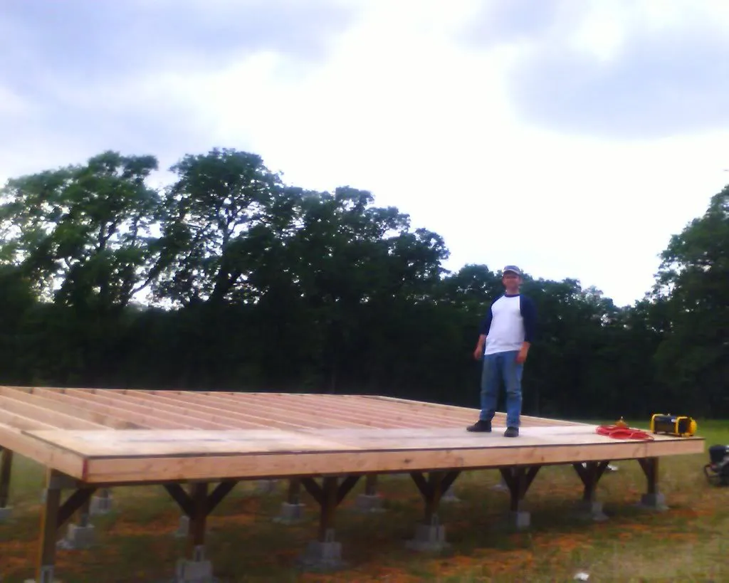

It seems to me that this site had a tradition of dancing on the finished deck pictures.  Drew?
(Maybe I'll be sorry I asked....but...have to keep those traditions up...)
Found it...now you're obligated...
http://countryplans.com/smf/index.php?topic=1717.msg15740#msg15740
Drew
You know, fishing_guy, I was just thinking of that very picture when we put the last of the OSB on today.  Technically I still need to trim the edges and put on the forward braces to be finished, but when I do, I will treat you (and everyone!) to my break-dancing robot interpretive ballet!
