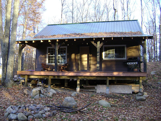

This is my 20'x30' cabin I started building may 2007.
http://picasaweb.google.com/bobby.boisvert/BuildingOurCottage

 It looks as though you are enjoying the process too.
I'll look forward to seeing more posts as you get more done.
Christina
 w*  great progress!  I, too, am looking forward to seeing more pix as you progress!  [cool]

Great progress, Bobby.  I assume you were checking out the size and pitch at home in the early pix.  Looks like a good way to get an idea.  Thanks for posting that and Welcome to the forum.

Yes my first plan was to build a 20x24 when I planned it out at home on my lawn I realized it was just a little bit smaller than what I wanted so I ended up going with a 20x30  Cabin

Your concrete pier foundation looks very solid.

Windows installed this weekend
http://picasaweb.google.com/bobby.boisvert/Spring2008/photo#5204435433634048674
PS - Just added the photo here. Classic looking cabin.
John
Looking like it's getting comfortable, Bobby.
