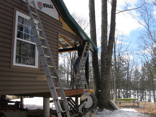

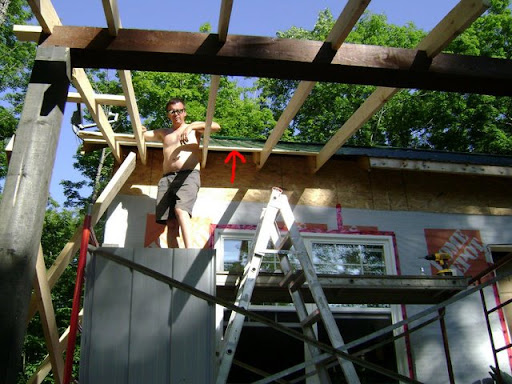

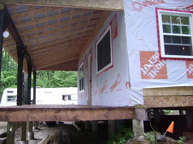

Hello Bobby,
Love the place.  It looks great.  I'm going to build our veranda this spring and was still thinking about how I was going to tackle it.  I wanted to have it continue off the existing metal roof but thought it might be too late, having already installed the metal roofing.
Can you tell me a little bit about how you installed your veranda?  I see that you added it after-the-fact as I am going to try, yet yours has the appearance that it is continuous.  I also see that you used a ledger board.  Would love to hear/see more about the veranda installation.
Curt
Bobby.B
I started by removing the fascia board. This gave me a 1-1/2" of roofing sheet metal over hang .I then joined the new rafters to the sides of the existing rafters, installed the strapping snug up to the sheet metal this allowed me to slide new roofing under the existing roofing . I started my sheeting from left to right all top right corners had to have a nib cut out of them this allowed them to slide under the existing roofing .When you install your second sheet you will see what I mean .I am sure this is not the proper way of doing this but it did work for me .

Bobby.B
not sure whats up how is this
showing strapping
Trying to find roof pitch
Alberta Curt
The pic of "finding the pitch" worked, as did the last one.  Thanks Bobby
Did you have to bend the metal on the veranda to match the angle of the roof?
Did this design hinder the sofit at all?
Sorry for all the questions Bobby............probably more coming.
Curt
Bobby.B
I did not bend the metal I just slid it underneath the existing roof metal
Soffit was ok
Keep the Questions coming hopefully I am being some help to you.

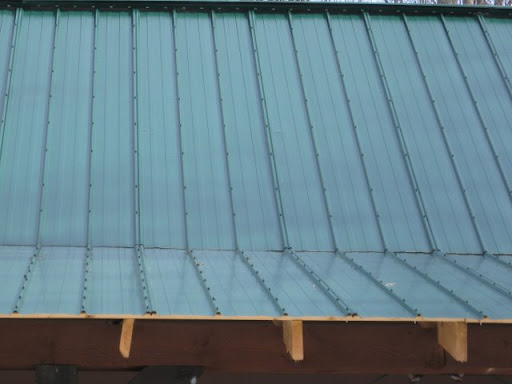

Thanks Bobby.  did you use any flashing where the metal roof meets the metal veranda roof?
Heres a picture of what I'm working with..........
Bobby.B
No flashing used and I have not had any water leaks either

Bobby.B
#71
Alberta I was at the camp last week so I took a close up picture of the roof where they overlap each other.
