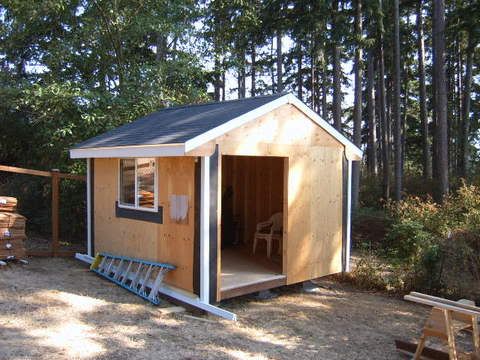

peg_688
BTW I did a ramp like I described for this shed , and it was longer on one side than the other MTL what your discribing, no photos of the ramp itself , at the time who'd a thunk some one would want to see it ::)
The ground is falling away from left to right as it goes away from the shed door.
