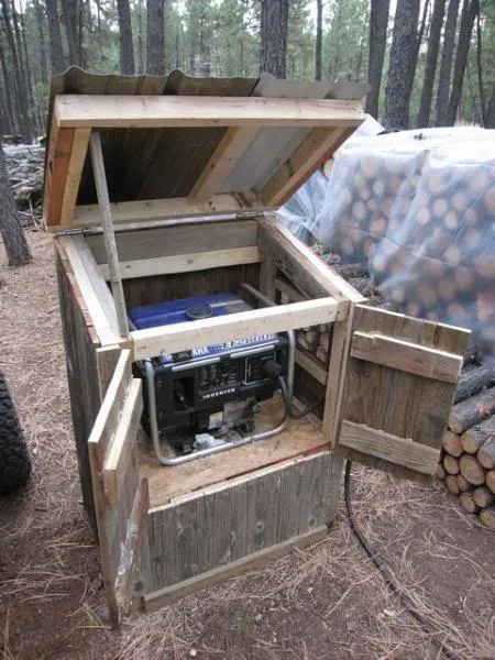

Another weekend, another small thing attended to. Up to now my small generator has been housed in a makeshift shelter of stacked firewood and OSB scraps. It now has a "home".
I used recycled 1x4's and 2x4's, some old 6x6 PT landscape timbers, PT 2x4 leftover from the gazebo, metal roofing leftover from the house, and some salvaged pieces of "new" 2x3. There's a cooling exhaust  air vent on the right side. I'll be adding one more panel next time up in the mountains.
The top is hinged so I can fill the generators top mounted integral gas tank.
The sections of 1x4 for the doors were so sun baked and dried out they split easily. Even pre-drilling holes before inserting the screws didn't prevent more splits. So I used some polyurethane glue to help secure the door boards to the horizontal battens. Some of the glue oozed thru some splits. I'm out of old boards right now so have to be content with the glue marks.  :'(\\

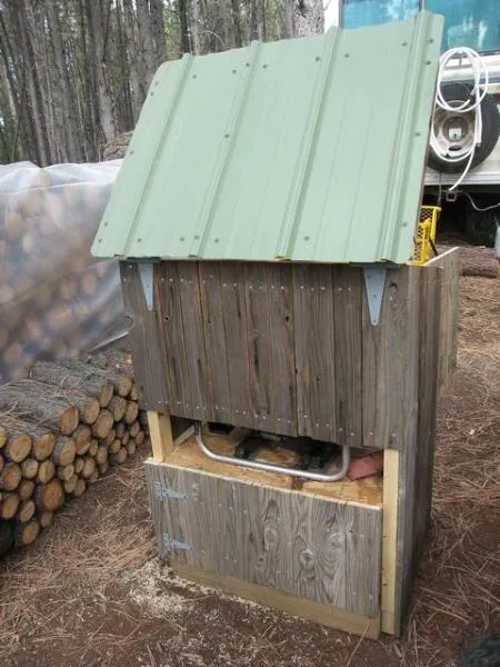

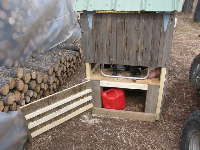

Rear view showing the rear ventilation opening. The rear bottom panel is hinged for access to gasoline storage. The generator exhaust exits through the opening. I have an auxiliary super quiet muffler I have to refit. It will be outside the box. The rear vent opening will have a 6 to 7 inch wide "shed roof" installed next time up.

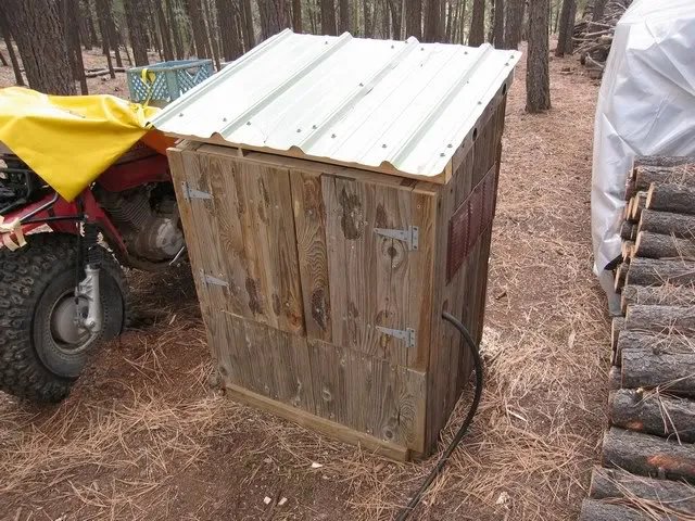

It was dang cold Sat night. Thermometer read 26 degrees at 7:30 AM. By 11 AM it had warmed up to a whopping 38 degrees. Then it very briefly snowed for 20 seconds or so. Nothing to photograph.

There's now a little shed style roof over that rear opening to help keep any rain out.
