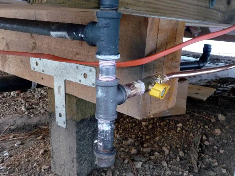

MountainDon,
Very impressive work on the propane hookup. You certainly know what you're doing if you have a drip end. Nice work.  ;D
#1015
Thanks, BK.    I try real hard, read/study a lot.   :D    You do too if you know about drip ends.
