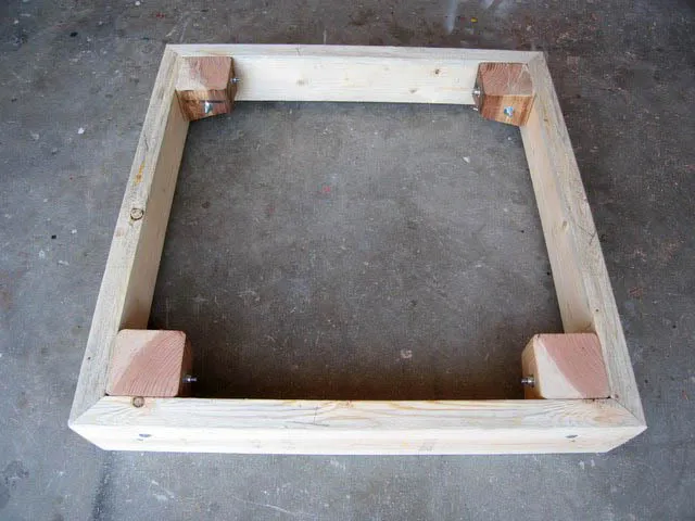

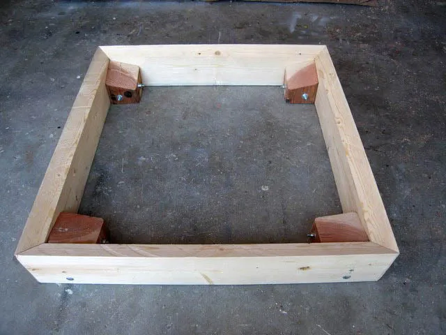

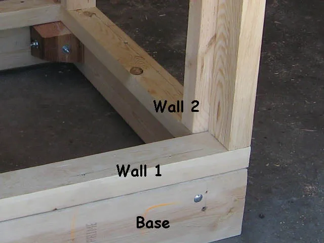

Starting at the bottom... The base upside down...  And Glenn got it right; it's a Cupola.
...and right side up...

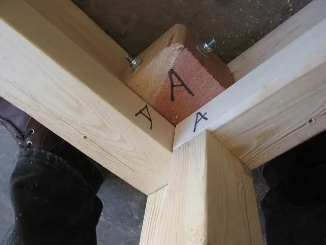

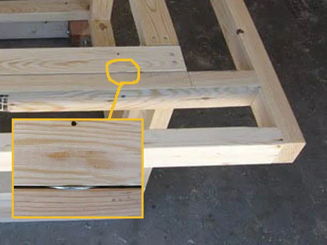

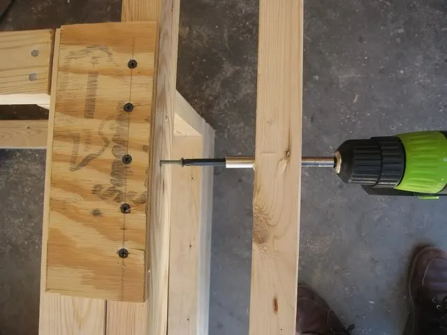

Two of the corner reinforcement blocks split when I drove the #8 deck screws into them. I should have drilled pilot holes.   :-[  I should know better; those redwood scraps have been sitting around the bone dry shop for a few years. I glued the splits back together with polyurethane glue, and then decided to use ¼"carriage bolts to help hold it all together. I used some screws too, with pilot holes.

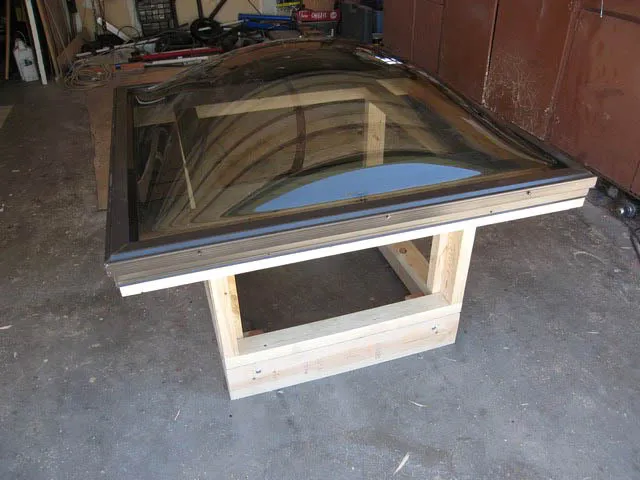

I got carried away with working and forgot to take some of the pictures I meant to.   The four sides that sit upon the base were framed like stud walls; a lower plate, corner verticals, and a top plate.

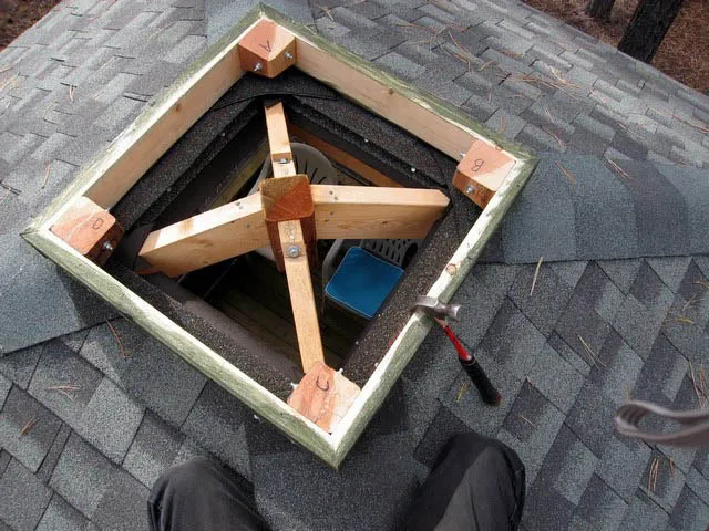

This whole unit is designed to be taken down into manageable pieces and re-assembled on the Gazebo roof up in the mountains. The 4 wall sections will be secured to the base frame with #8 deck screws, and probably a few ring shank 12D or 16D's. The corners are fastened in a similar fashion. The upper framework is fitted over the assembled wall sections. I used a 1/16" fender washer as a spacer during the trial fitting and assembly to make it easier to slip the framework onto the wall framing up on the roof top. The upper framework joints are reinforced with blind hardwood dowels. Again I forgot to take pictures, until I had glued it all together.
½ inch plywood plates are used to help support the upper framework. Holes drilled through the framework allow an extended bit holder to drive #8 deck screws through the inner top frame members to the wall framing for addition strength. The upper framework joints are reinforced with blind hardwood dowels. Again I forgot to take pictures, until I had glued it all together.

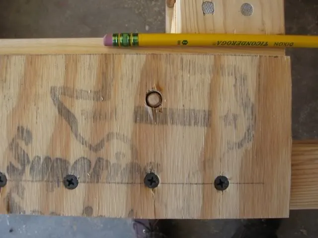

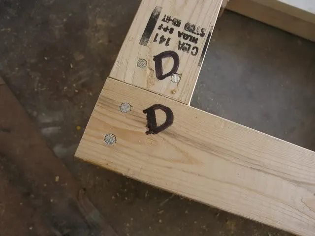

All sub sections were labeled to make final assembly easier.  :)  This is one of the top plate wall corners.
One corner plate has a 3/8"locating dowel to assist in correctly positioning the upper frame upon roof top reassembly.

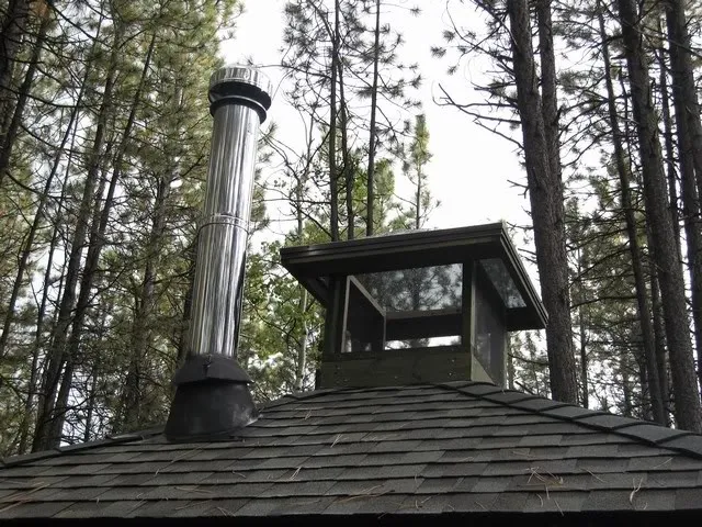

If you're thinking that's a strange upper framework for a roof, you're right. This is a Cupola with a unique touch! The "roof" portion of the Cupola is a skylight! It's the item  Lowe's took three attempts to get correct; a smoke plastic single dome, bronze anodized aluminum curb mount framed skylight. But they never gave up trying and were always quite courteous even thoough I did allow my frustration to show a wee bit, but also in a polite manner.  :)
The open sides of the Cupola will be insect screened. Over the winter I will build four louvered panels to be installed over the screening to keep out the rain and dress up the appearance.
I took the sub-assemblies apart and finished them with the forest green semi transparent stain that was used on the rest of the Gazebo today.
More pictures when it's mounted on the Gazebo roof peak.

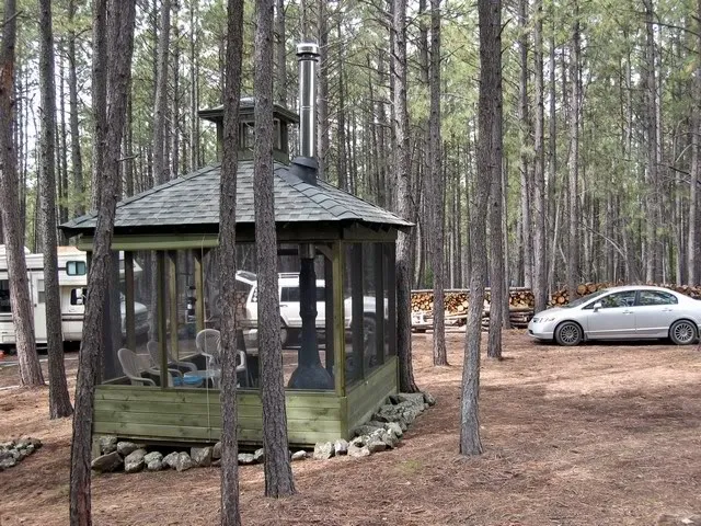

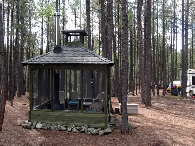

Back up on the Gazebo roof one more time. The Cupola base is secured...

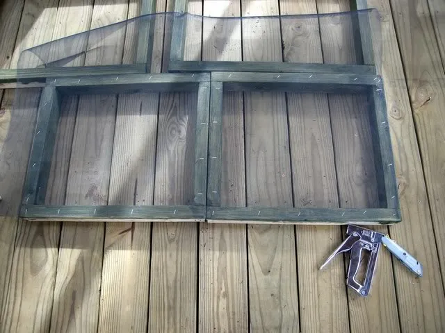

The four sides of the Cupola consist of two slightly different sized sections. They are screened to keep insects at bay. The sides will be later covered with louvered panels (yet to be made). I screened them in pairs, then cut the aluminum screening apart with a utility knife.
The once very tightly packed deck boards have dried some and are now far enough apart to dispense with the dust pan when sweeping. Simply sweep the dirt, wood bits, etc. across the cracks and it disappears!  ::)  Once the sides were up it was a snap to install the pre-framed roof/skylight framing and the skylight itself.
The view from the front side, from the north...

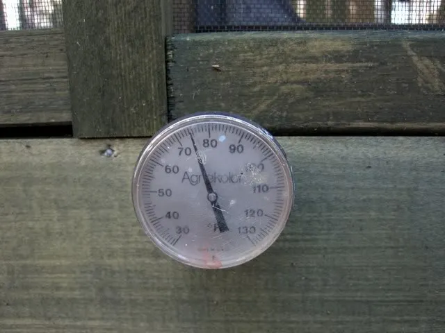

Saturday was rainy, cool, hailed some. Even with a blazing fire in the Chiminea the temperature behind the sheet steel wall protection didn't go over 75. (ambient air temp 55 to 60).

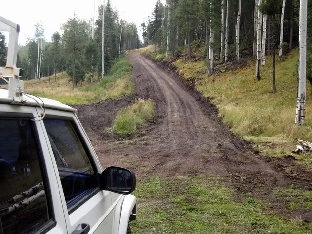

The road up the hill to our place was improved last weekend.
I missed all the fun James had with the TD9.  :'(  He cut down the steepest part and pushed the earth down to fill in at the bottom. Now even the Honda Civic can make it up with ease.  :)

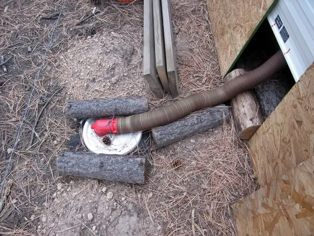

One more picture... my temporary gray water disposal system
