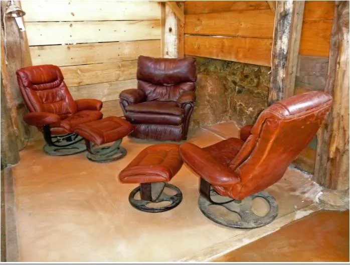

I had a short break from work this week so got another section of the light duty India plunger pier concrete floor done.  The new one is the wetter looking concrete at the bottom side of the picture.  The one the chairs are on, I did a few months ago.  This is in the great room area under the sun scoop.
The concrete is about the same as stucco with pier holes pounded down to the natural earth with the end of a digging bar and filled with grout.  Jute matting is used for the reinforcement instead of steel.  I have mentioned this in other places on the forum.  We are leaning toward it more as it can go over non-compacted soil and is still a strong durable floor.
Sassy told me I must mention that the chairs were just sitting down in a dusty unfinished storage area for months and we just got them out to get a look with furniture there. d*  Besides - they were in my way for continuing on... [waiting]
It is environmentally friendly as it is only about 1/2 inch thick on the average, minimizing use of materials.
