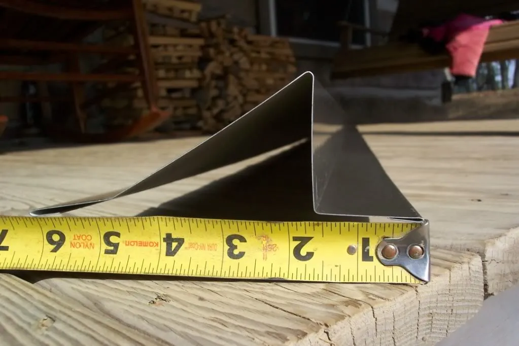

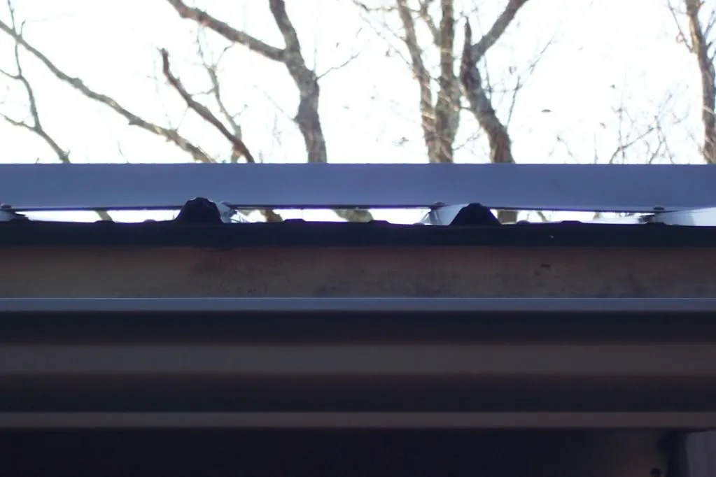

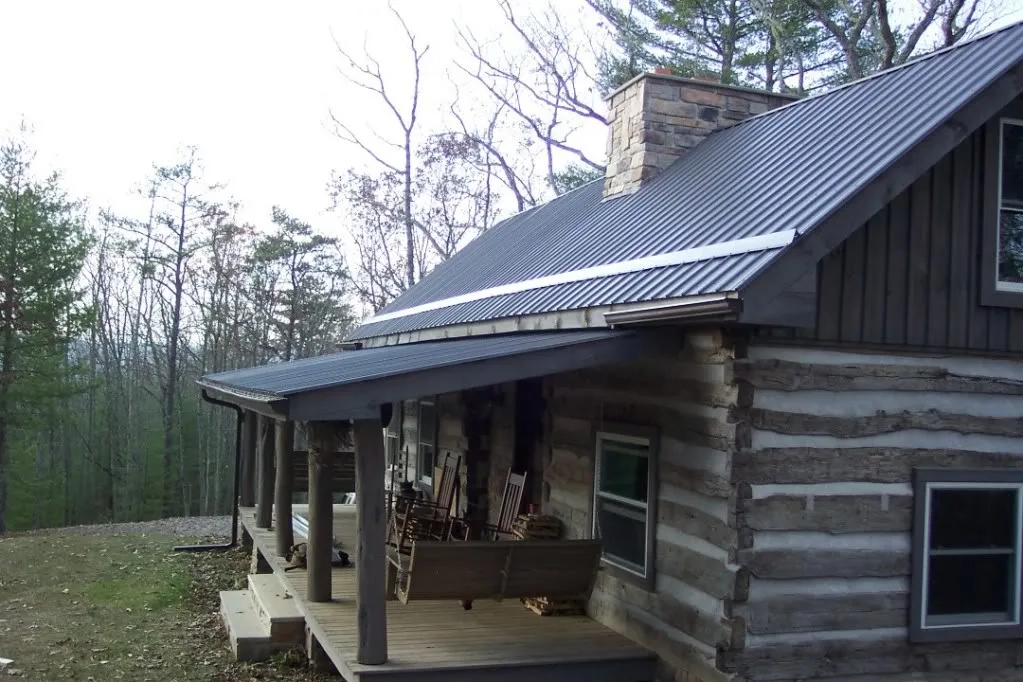

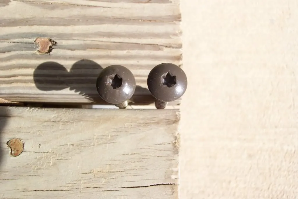

Nathan if you go with exposed fasteners on your metal might I suggest what I used on mine.  They are pan head with the torx inset in the head.  They are less prone to collect what ever needs to slide off the roof like hex headed screws.  They come in colors the same as regular fasteners.
In addition I used a ice/snow guard ( Witches Hat )to prevent the gutter from being torn off by sliding snow.  It still allows melting snow and water to exit the roof.
Thanks Red. Since I ordered a standing seam roof, they come in 16" sections. One side gets pancake screws, and then the other side snaps in overtop - leaving nothing exposed. When I ordered the roof, I thought I was going to have exposed fasteners at the eave edge and at the rakes. But, I was just looking at the order the other day, and it looks like they are sending me the stuff to do it with no exposed fasteners. THis means the gable trim gets pop rivets, and the panels at the eaves actually have the bottom 1" of the panel bent 180 degrees and tucked underneath a flange.
I like those screws you showed more than the hex screws (used on my shed). Do they have a rubber washer on them?
Side note, I was so surprised by how inexpensive the roof was. this is for the 34x20 + 8x12 mudroom. The quote for the standard panels was $1800 and for standing seam we paid around $2800. That includes all the trim and even the fasteners. ABC roof has a branch in Utica.
Quote from: NathanS on August 19, 2016, 06:47:02 AM
Yes they are identical in thread and gasket like hex head.  They have proved themselves being close to the woods with pine needles and leaves wanting to hang up.
