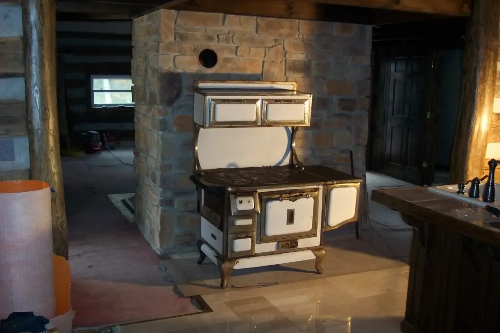

Downstairs insulation. You can also see my makeshift heatshield for the wood cookstove. I use a radiant gun thermometer to keep an eye on everything, and have never seen any dangerous temps anywhere.
The attic is R-60. Criss-crossing the insulation. I am being extremely meticulous, especially at the eaves where i am making 7-12 cuts and installing the insulation on the top plate in a slim strip to guarantee I don't have any gaps or accidental compression. The east side of the attic is mostly done, and the sound deadening effect when the rain hits the steel roof is pretty impressive.
I thought I'd snap a few pics of the woodstove too, the firebox is massive. Cookstoves are EPA exempt, so there is no air tube at the top of the stove for secondary combustion. The stove is extremely air tight, though. I have been getting some really good burns with just junk Aspen/poplar that is a little too wet around 18-20% moisture content. Once the attic is sealed off and the house is more heatable, I can't wait to see how it performs. Also my 10 yards of concrete slab is fighting against me right now, rather than acting as sort of a thermal mass flywheel.
The oven is porcelain, and the bottom part slides out so you can put it in the sink to clean it.

They have came a long way designing wood Cookstoves over the years.  I can't believe the size of that firebox.  The 1926 model I have is only 8WX10HX16L.  The load door itself is considerably less than that.  I don't know how they cooked with them but they did and did so well.  I would imagine that they spent more time just adding wood than they did cooking.
If I could get this snail motivated internet to improve I would post a picture.
Finally.  If you look at the upper left door that is the firebox load door.
NathanS
The only thing I've done so far is heat up coffee.
I have read that the cookstoves are more forgiving of temperature variation when baking. We won't find out until early spring or until next fall though. Using one of those woodstove temperature gauges near where the flu exit is, when I am running at around 500F, the oven usually hovers around 325F when shut off.
Your cookstove is a beauty. I love those old ones. With that size of a firebox they really are just for cooking. Are you planning to hook it up to that flu? It actually looks like the cooking oven on yours may be a little bigger than mine.
I have found with this stove,  if I load the fire box right - open the built in damper and light her up, the stove can climb to 500F in 20-30 minutes. Once the chimney is up to temperature, close the damper. Once the wood is burning good, I have a top and bottom vent on the firebox door I can start to shut down. It is surprisingly forgiving. I figured out the other day if I really want to go nuts I can open the ash tray door and firebox goes absolutely crazy - almost frightening. The stove used to come with another air control underneath the grate because the stove is designed to be able to burn coal. The body is all 1/4 inch steel.
I have already learned a lot about it, but I think I still have more to figure out.
I haven't actually baked anything but have used the cooktop several times.  The warming ovens are really nice to keep things warm.  Never had an occasion but once to use the water jacket.  It definitely will be a learning curve trying to prepare a complete meal and maintain the constant temperature to bake goods.  My grandmother did it everyday of adult life and never complained.
I had one similar to John's, it got in the way in the kitchen so it went down to the shop before it got in the way there. I did bake biscuits in it and cooked on the top a few times. They are a pain to keep in wood, glad it was part of my Dad's chores and not mine!
Be careful with that roaring, ash door open burn... It doesn't take as much as I thought to really warp steel  d*. I was working on an antebellum log house years ago. Folks stopped by and some had stories. One lady came by and introduced herself. Her family had lived there. One morning her father had lit the cookstove and didn't realize the water jacket had frozen overnight. With the outlets plugged and a fire, it made steam and killed him. The heat exchanger was already burned out in mine, if you go to use one make sure to flow check it. I like the idea but potential steam scares me.
