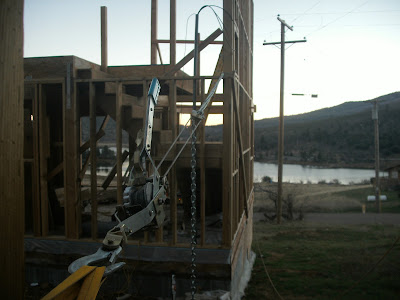

I'm doing a post and beam house similar to a First Day Cottage. This will be the final, interior view, minus the bracing.  The insulation will go on the outside of the sheathing, followed by exterior siding, kind of like an SIP.
We'd had it plumbed and square the last time DH was home at Christmas (he's driving a truck in ND).  My bracing is still up and in my excitement to get going with the sheathing, now that the weather has finally warmed, I didn't recheck plumb until this point.  ::) The west half of that wall, to my son's left, is just a hair over 3/4" out of plumb.   I can see where the 16d duplex nails on my braces wrenched a bit when it moved.
It leans to the west, into the prevailing winds.  For whatever weird reason, this makes me happier than if it were leaning away.  And this is obviously why I was planning a divergence from the First Day plan and will put up a plywood shear wall in my corners.
My dilema:  I'm pretty sure I can't "persuade" this back into plumb with just a 13 year old to help and DH won't be home for another couple of weeks.  (No, I don't have a come-along, though I'm sure I could track one down if needs be).  If I'm not mistaken, code allows 3/4" for an 8' wall but I know it'll be a hassle when it comes time to put in windows and doors.  {correction, it's the NAHB with this rule of thumb and it's 3/8" over 32", or 1 1/8" over 8' which seems like a LOT!)
Do I want to try to fight this back into plumb?  Or do I just want to adjust doors and windows accordingly so they hang plumb in a frame that's not?

   I didn't even have a 13 year old to help---but I did have a good come-along, and used it frequently.  Whenever I was about to put up the shear panel I'd re-measure, then fine tune things.  You can hold the entire wall in place with some temporary diagonal bracing on the part of the wall you're not yet sheering.
    Looks to me like you could throw some webbing around the upper corners, hook a come-along to it, then anchor the other end on the low opposite side.  I would crank on it until it was tight then put a scrap block against the wood and whack it with the 'persuader' (big sledge hammer)
     Whenever you go to move stuff though, you have to think about what's moving.  It sounds like you figured that out already if your duplex nails pulled out some.
      Another trick since you don't have a come-along is you could run a through-bolt thruogh holes drilled through the top of a diagonal brace and somewhere near the top of the wall.  Then cut the bottom of the diagonal somewhat vertical and use a good screw clamp between it and the bottom of a stud.  Crank on it hard---if someone climbs upstairs to wiggle the whole structure back and forth it'll help gain the difference

Generally you can tie off to the floor somewhere and pull whatever is leaning out back in. A length of rope and a stick to twist in it can tweak most things. A 1/2" lag over the edge into the rim might be one tie and lashed around an upper floor beam over the outward leaning corner at the wall diagonally opposite as the other point.
Diagonal sheathing would lock it, horizontal will let the wall slip back unless there is some bracing or some sheets of ply.
Now where I parked the truck today... that's going to take the big come along  :D

QuoteA length of rope and a stick to twist in it can tweak most things. A 1/2" lag over the edge into the rim might be one tie and lashed around an upper floor beam over the outward leaning corner at the wall diagonally opposite as the other point.
I think this is what I'm going to try first.  And, if it works, I can leave it that way while I re-do the wall.
Please use caution.  Removing bracing in order to tweak could result in the structure becoming unstable.  Often when using a comealong to convince something into place, I also put a "don't come along" so that I can't overpull on a wall and have it topple.
It appears that you have some significant mass overhead, which could try to get away if something pops or it racks in a hurry.
Remember to check the middle of the structure for plumb too, not just the end walls.  If you already have the floor or roof deck on, you may not be able to fix any bowing in the center of the structure.  Is that ceiling in the picture you posted a square surface?
Edit:  BTW, you can also attach a 4x4X8' along your opposite rim joist with 8" or so protruding out that you can latch your pull structure onto.  You frequently don't need a whole lot of force to rack that wall over.

Yeah, I think that's why I'm going to try Don's trick with a twisted rope, first.  I think I'll be able to control small movement that way easier than with a come-along.
The come-along will be next if the rope doesn't work...
ETA:  Regarding the concern about something coming down--it's not like anything is truly leaning.  Like I said, 3/4 of an inch is still within the bubble's lines on a 5' level.   I've lived in old houses that were considerably farther out than that.  ;)
I bet that will work just fine.  Be sure and stand outside the structure when twisting on it  ;D  a rope tensioner is more like a spring than a cable is, and it tends to keep pulling even though the endpoints move together.  Cables relax in a shorter distance than ropes do.
