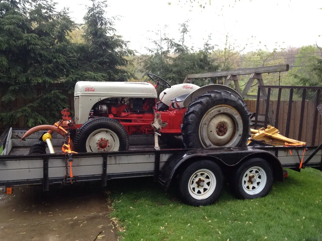

new to me ford 8n

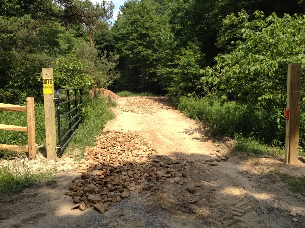

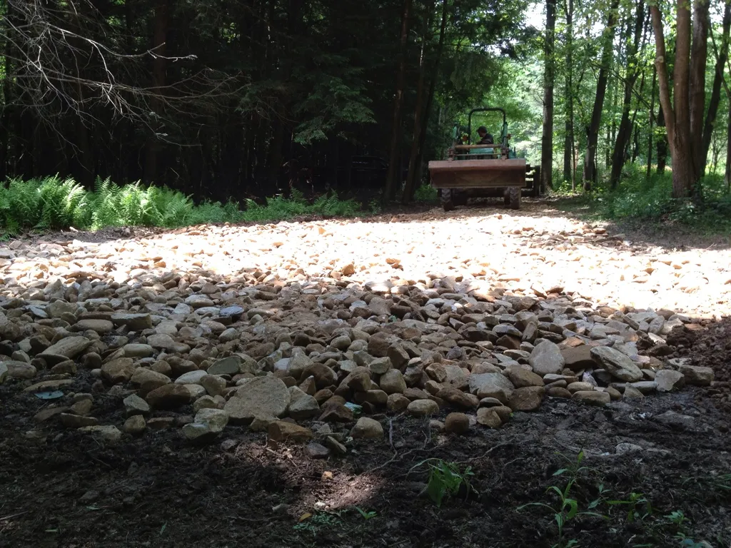

installing driveway
driveway install
current driveway picture, still need to add topcoat

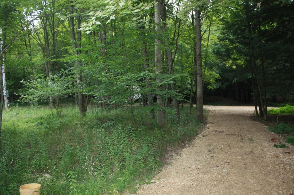

build site before clearing trees
