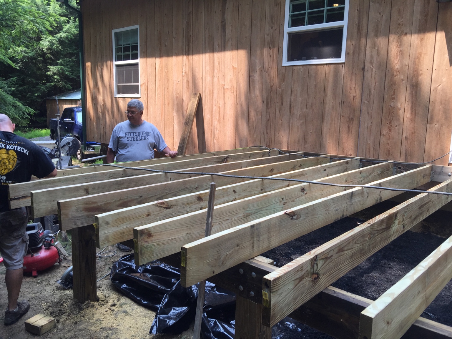

Well I was able to get up to camp today, I got some more grading done now that it is really drying up. (we had a bunch of rain) I was able to get my utility line dug and my water line run.  I am hopefully going to be able to get my friend who is an electrician up there next friday to get my electrical service hooked up in the cabin.  I also found an Amish Hemlock mill very close to my camp and I ordered the hemlock for the outside, board and batten.  I am really excited about that as it was half as much as I thought it would be, as I had priced it out at a mill closer to home that was a dollar a board foot.  The Amish price is 50 cents a board foot.  So I am at half of what I thought.  BONUS...  I also did some laying out of where my walls are going to go for the bedroom and bathroom/mud room.   I am ready to frame those up on my next trip.  Things are going well, I am happy with where I am.  I am also in the process of getting prices for my metal roofing.  That is where I am at...

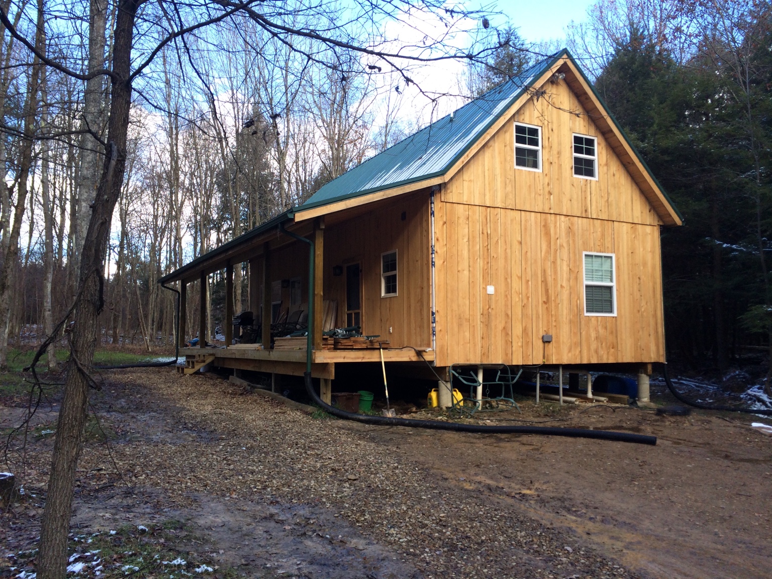

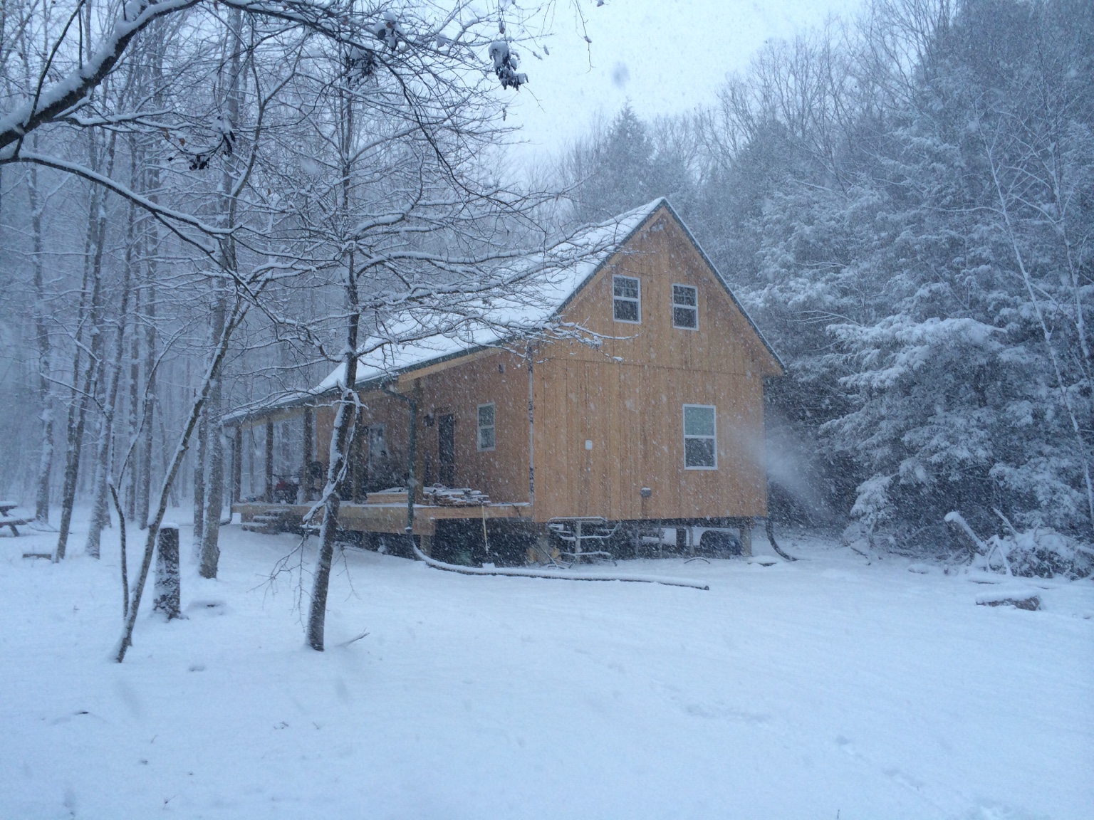

So a lot of my pictures are gone from photobucket, not sure why and it has been forever since I updated here so I figured I would add a few recent pictures....
Sent from my iPhone using Tapatalk

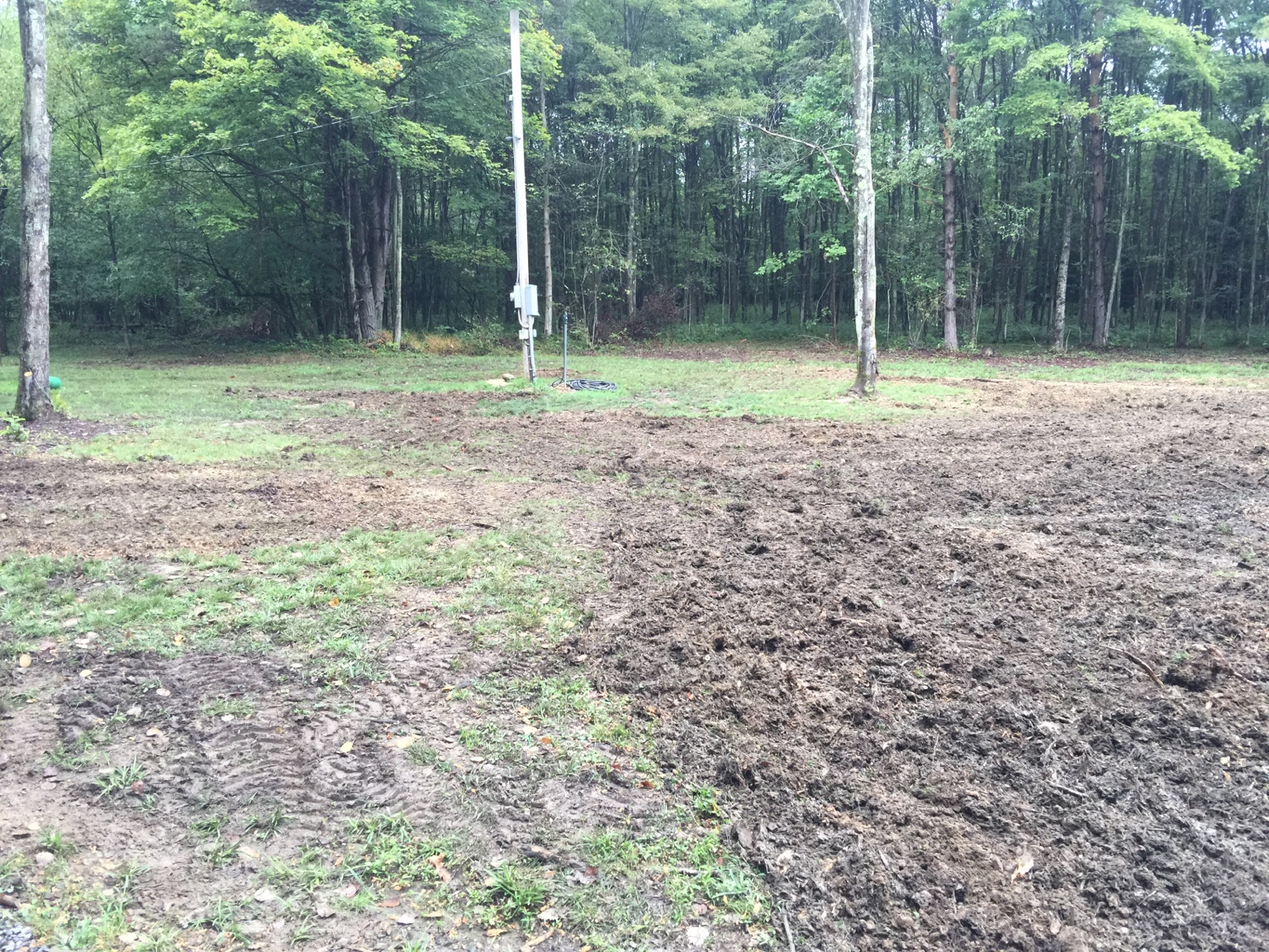

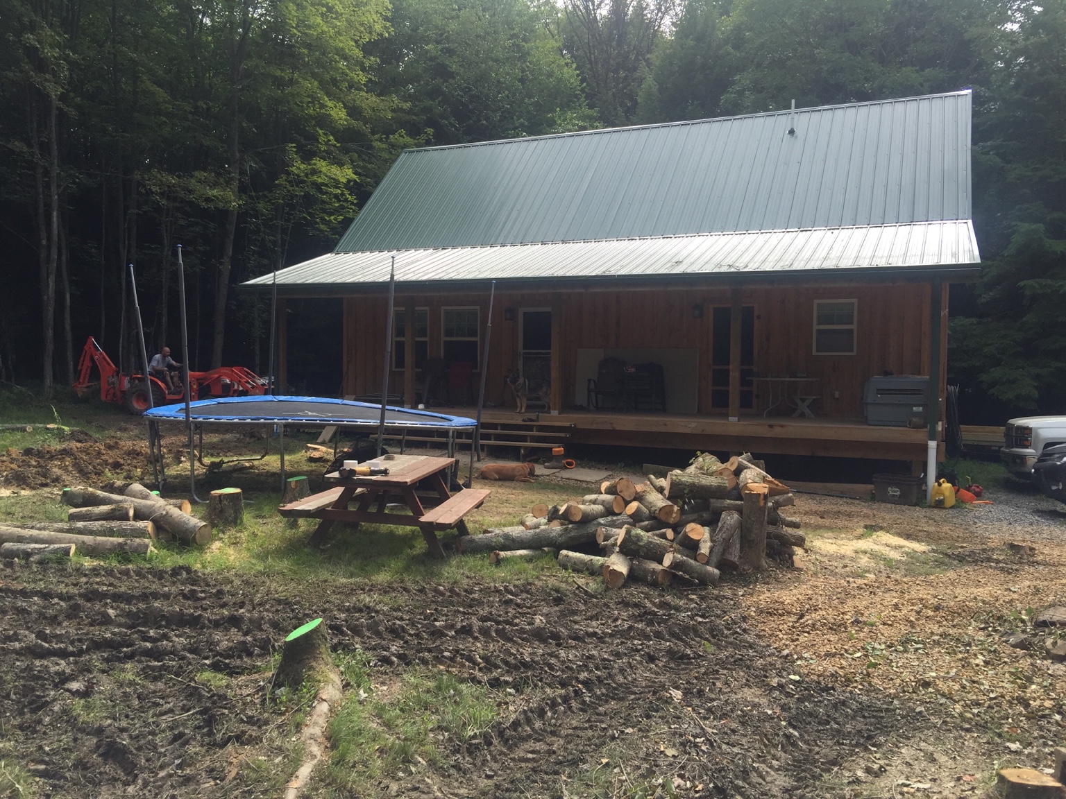

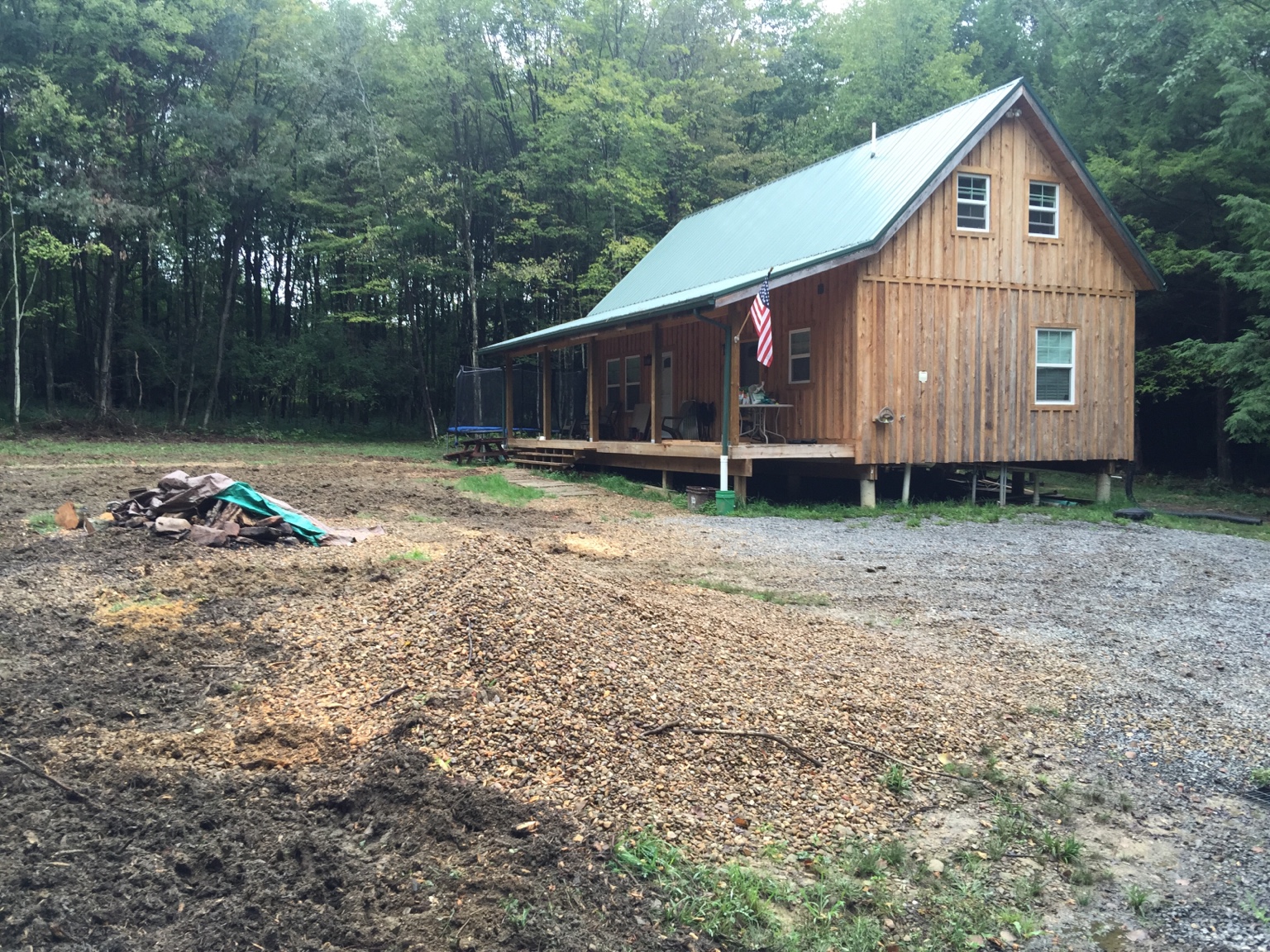

I just had all of the stumps grounded from the 30 trees I took out in front of the cabin. I had to open it up it was too wet and wouldn't dry out. I am in the process now of power raking, adding topsoil and seeding the front.

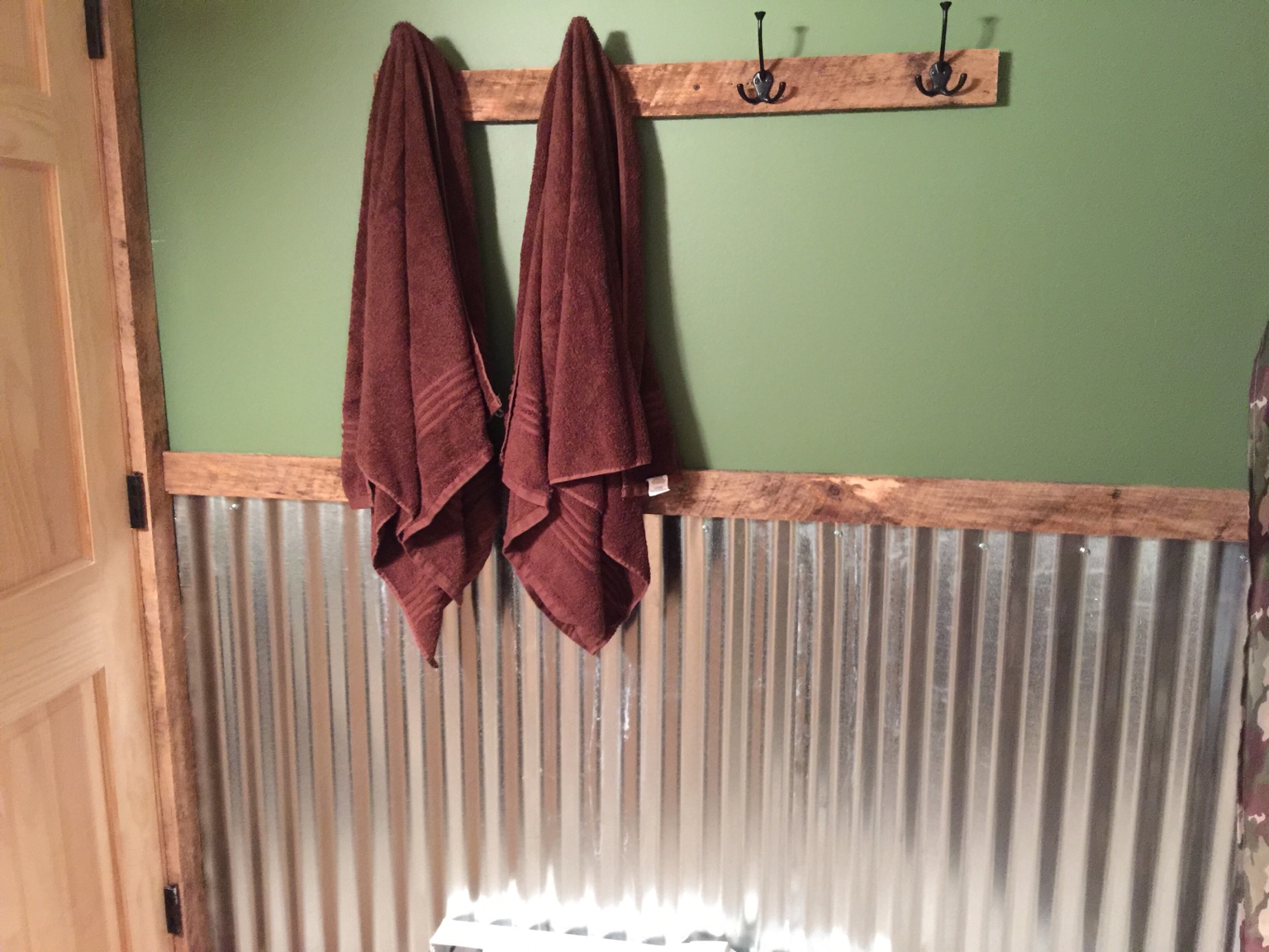

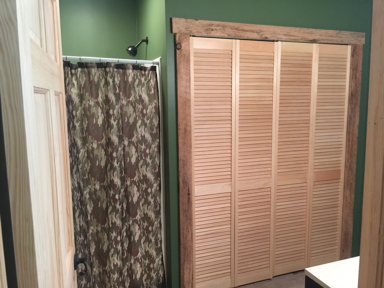

I have all the drywall hung inside and am paying a local to finish it for me, I did the finishing in the bathroom but for me to do the whole cabin it would take forever and I am trying to get it primed and painted before fall.  The place is coming along so nicely, my family love going up on the weekends and it will only get better as I check things off the list.
