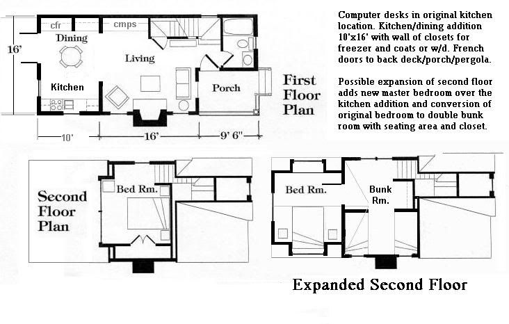

Heres a sligthly more ambitious expansion. A 10x16 addition at the back provides a new and larger kitchen/dining space under a shed roof.  Wall of closets for the chest freezer and possible w/d.  Kitchen is less visible.  Double computer desk in old kitchen location.  Possible expansion of  second floor by building over the new kitchen, provides new master bedroom and two guest bunks,closets and seating area.
mark chenail

#6
Mark,
I really like what you've done. Can you explain how the roof would look on something like that? And do you think it's something that could be done in 2 stages if need be?
The area that you have set aside for computer desks in the original kitchen might be a little small... but I'll bet we could turn that area into something similar to what we have now. I'm thinking 6x10'
If you don't mind the mess, here is what we have now...
Mike...
Mark_Chenail

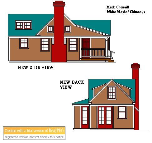

Mike:  Glad you like the design.  That computer counter is about 10' long. If you had drawers on either end for support and upper cabinets for storage, you might be okay.  Id have to tinker some to get more counter space for puters.  I can do a little drawing of the roof. Might take a day or two, but I will do it.  Basically its just another gable intersecting the original one with two shed doors on each side.
Give me a day or so and I will post something.
mark chenail

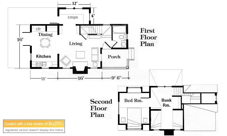

Mike:  Heres a new plan with a computer room and two views of the exterior that show the additions.
Let me know what you all think.
Mark
mark chenail
mikeschn
Mark,
I'm really impressed with what you've done, especially since I know you did it in paint, and you had to draw every individual line.
We need to get you hooked up with a program that lets you do more in less time... Now I'm not the expert, but I played with ISMI Floor Plan this morning, and other than needing to peek at the help a couple times, it's really not hard. And you can crank out designs as fast as you can think em up. Just food for thought.
Okay back to the house design. Well, you certainly gave us the computer room that we know and love. I guess there really is no way to integrate that into the main house without making the house larger.
Thanks for taking the time to do this... It really clearifies your thoughts...
Mike...

tjm73
An upstairs bathroom over the computer room makes sense to me.  Just an personal observation.
That would involve extending the gable back over that section of the buidling but is a good upgrade idea that I would probably do as well. With a steep gable you may only be able to fit in a 1/2 bath.
tjm73
Even a half bath would be fine.... so you didn't have to go down stairs in the middle of the night to pee.
Mark_Chenail
"Resident Designer"   You make me blush John :-[ :) but thanks for all your kind words.
I agree about the convenience of a half bath on the second floor.  You could possibly make the closet on the landing a water closet with a bit of shifting but it would be tight.  Extending the gable over the computer room would probably be a simpler  solution.  Considering how much alteration we have made to the original house particularly on the second floor, it might be simpler to frame the  main walls higher than the original design so that you got  a 3-4 foot pony wall all around on the second floor and then sprang the roof.  This would give a lot more headroom and useable floor space without much expense, give room for the half bath. The house would look a bit taller but I dont think it would hurt the appearance any.
MIKE:  I will take a look at ISMI today and let you know what I think.
Mark
