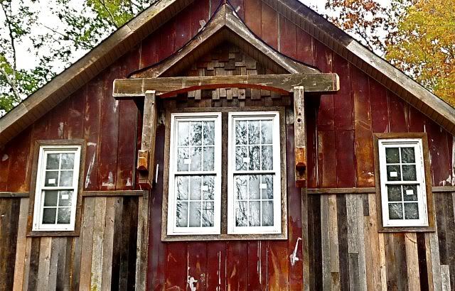

Hello, new to the forum and really enjoy it here.  I found this picture while surfing the net and wondered what the little shed over the window is called.  I want to call it a dormer but I know its not.  I'm just wondering if there is an architectural term for it or if its just a "shed over the window"?  ;D
bayview
   Open Pediment . . .
Timberjack
Thanks!  I just knew somebody here could identify it.  I thought it looked nice over the window and am considering designing one for a window on our cabin (although much simpler).  Thanks again!

I had been calling both of these pent roofs, but only the lower existing one is that. Now I've got to go tell them what I really built  :D

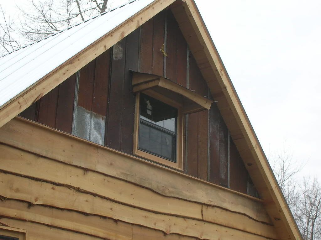

We got ourselves an open pediment! :)

WOW! looks great!
Love your siding, what is it?

great touch! the place is coming together nicely!
Timberjack
Thanks for the compliment, the siding is cypress.

Quote from: Timberjack on February 09, 2011, 06:52:31 PM
      Yes you do!   An open pediment is triangular like a gable end. . .    And you have a window with an awning within the tympanum!   Very nice . . .

Anywayyyyy....I also have a question about the siding.  It is zackly what I want to do as well.  I want to know about how it was sawn.
Trees taper, so, if one splits a log right down the middle, and then slices "siding slabs" from each half, those slabs will taper as well, so one end of the siding will be wider than the other...or so it would seem.
So do the slabs have to be turned and sawn again, to make them uniform in width?  Important, as I may have to discuss this with the saw mill owning victim I target to do the work for me.
Timberjack
The sawing was kind of tricky...and the installation was even trickier!  I picked logs that didn't have much taper, mostly butt cuts with good grade and form.  That was half the battle.  The sawyer (using a woodmizer band mill) placed the logs on the carriage and slabbed one side deep enough to make a flat side.  He then turned the log a 1/4 turn so the flat side was facing outward from the mill and then he started sawing his boards.  The boards came out with one squared edge and one bark edge.  The trick is to pick logs with substantial size and good form.  If you are planning to do lap siding like I did then you will need to lap the board over the previous board more than you would on normal uniform siding.  In some areas the lap may be 1.5" and in others it might be 4" or more on the same board.  I have an average of about 12" showing on each board so the lap varies.
My friend Chet who is helping me said we had to "work with it and not try to force it to do what we want it to do".  First we snapped a chalk line across the top edge of the board to help level each piece as the woodmizer isnt exact when it comes to squaring the top edge.  The we found the narrowest place in each board and dropped it 1.5" below on the previous siding board.  This way if the siding shrinks it wouldn't expose the previous edge.  Then it was just a matter of leveling and putting in the fasteners.
