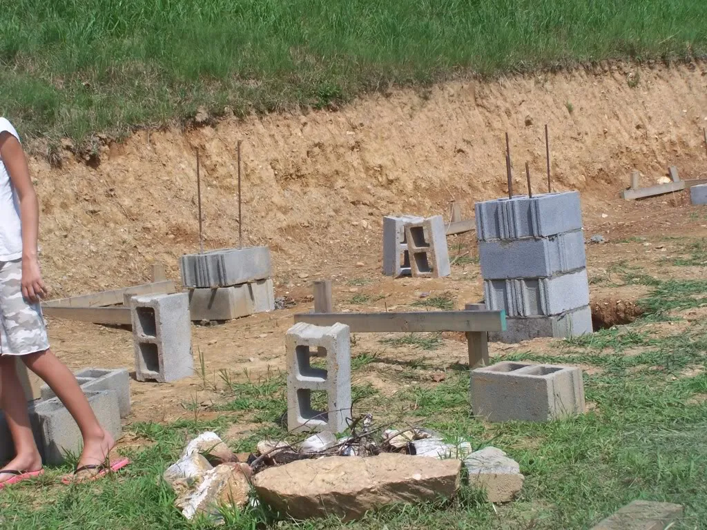

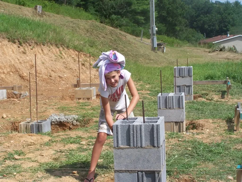

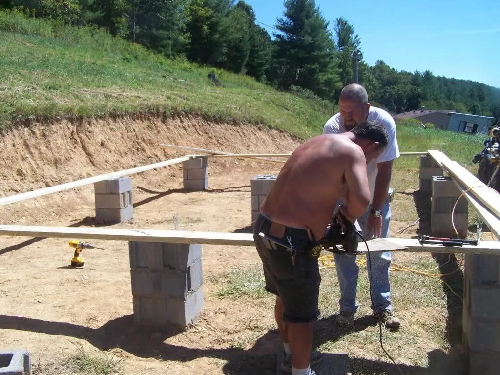

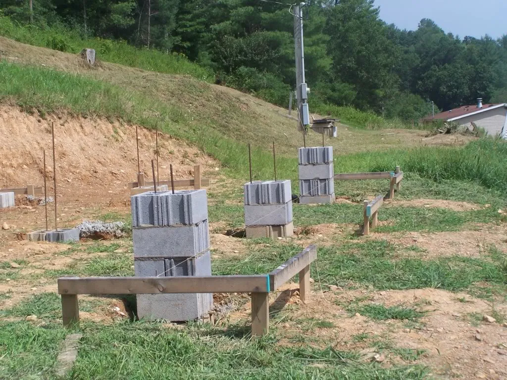

This is a first for me.  Got some block layed with a little help from my little boss. Used some instruction from some friends. Were going to fill the block with cement.
wannabuildacabin

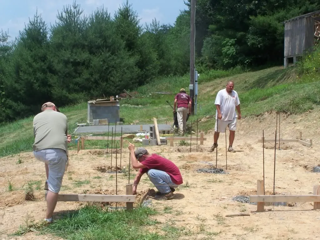

 :) Got the foundation done and finally started to build. Getting excited now. Thanks to all the help from my friends.

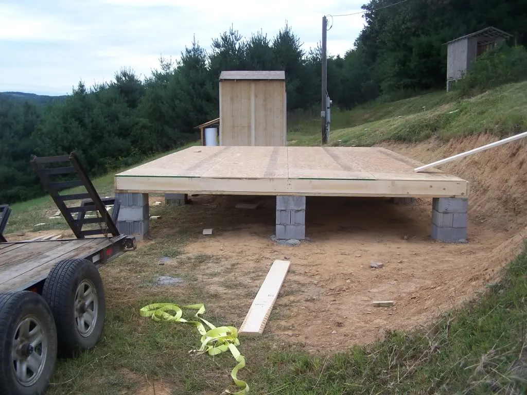

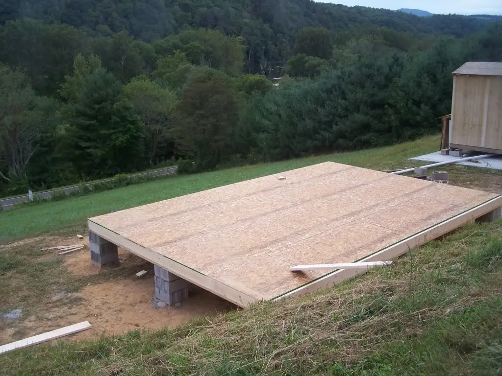

Congratulations on the floor.

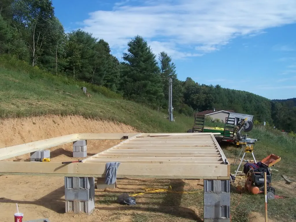

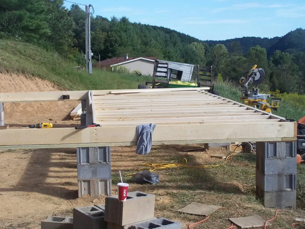

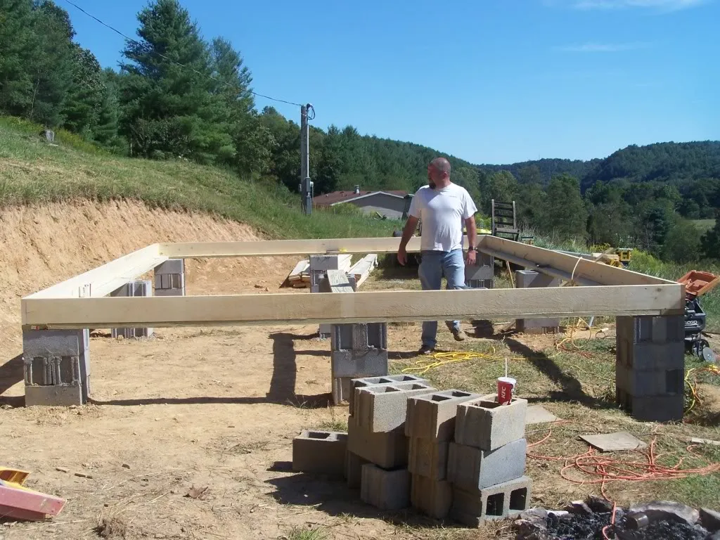

I am a little concerned with the joist layout.  I am only guessing by the pictures that I can see.  It looks like you rested the entire floor on a 2x8 laid flat with only a single 2x8 around the edges.  This looks like this is over at least an 8 ft span.  This does not look like it will hold the weight of an entire cabin.  Are you building to code?  It does not look like any design I have seen in any of my framing books.
I can see what has raised squirl's concerns. In between the pictures that show the perimeter planks laid flat with a 2x placed on edge around the outside perimeter line, and the picture of the decking in place, we can not see what else was done. Has the on edge 2x's down the long sides in particular been doubled, tripled or quadrupled?  If this structure is to have a normal gable roof with rafters those long sides are going to be supporting the entire weight of the building. That calls for some husky beams, not necessarily solid wood, built up beams are fine as long as they are stout enough.
Questions;
What are the dimensions? It appears to be about 16 feet wide by maybe 20 feet long.  ???   The spacing between the piers on the long sides would be about ten feet then. That is quite a distance to span.
Floor joists are what size and how far apart are they spaced? Did you use metal hangers to attach the ends of the joists to the long side perimeter 2x's, or do the ends rest on the flat planks? There could be some issues there.
wannabuildacabin
 Instead of just putting a short block on each pillar i ran the sill plate all the way across which also helped support the joist as we built it and it also has joist hangers . The dimensions are 16x24. The outside band is doubled and the middle is doubled. After the outter band was up we put the joist in in sections so they could all be nailed from the ends as well as the hangers. Each joist is just under 7.5' and are spaced 16"oc. I hope this clears it up a little better. Should have taken more pics. I need all the help I can get. Please let me know of anything else and of how what I have done sounds. Thanks everyone for your input
It's a little better than I had originally assumed, although the span is longer than I had assumed.  It looks as though you doubled the 2x12's along the outside of the 24' side?  This still leaves an 11' span on a built up 4x12.  I think you also mentioned in an earlier post that you plan on building this as a 2 story.  I believe the load that this can handle is far below what is required for the load over that span.
I am not an engineer or master builder.  I am concerned though for your safety and others that may follow.  Maybe someone else can give better insight.
First; good news. The floor joists, 16" OC are not an issue. Even 2x6 #2 of most common 2x species would have no problem spanning 7'5". Anything bigger is plenty strong for joists and provides space for good insulation. It is the span between piers down the length of the building that appears to be an issue.
16 x 24 ft. That makes the clear span between piers on the long sides 10 feet if all the piers are 16x16 inches.
What size are those 2x's;  2x10 or 2x12?
Table R502.5(1) in the IRC 2006  lists the following.... (note their chart starts with a 20 ft wide building, so with a 16 ft wide the following sizes and numbers would be on the safe side.) Note this is what adherence to most other building codes would require if things were done by the book. The book does have some safety factor built into it I'm sure, but here's what the numbers in the book are...
For girders (beams) supporting a roof, ceiling and one floor with a center beam;
for 30 lbs snow,  3 - 2x12 would span up to 10'2"                50 lbs snow, 3 - 2x12 would span up to 9'2"
or
for 30 lbs snow,  4 - 2x10 would span up to 10'1"                50 lbs snow, 4 - 2x10 would span up to 9'1"
For girders (beams) supporting a roof, ceiling and two floors with a center beam
for 30 lb snow, 4 - 2x12 would span up to 9'8"                   50 lb snow, 4 - 2x12 would span up to 9'5"
Since the chart is figured for a 20' wide building those 2 floor spans should likely be okay for a 16' wide.
Or another way to look at this:  if those girders are doubled up 2x10's as I think they are, the table R502.5(1) indicates that the pier spacing should be no greater than....
For girders supporting a roof, ceiling and one floor with a center beam;
30 lbs snow, 7'0"      and 50 lb snow, 6'4"
and,fFor girders supporting a roof, ceiling and two floors with a center beam
30 lbs snow, 5'9"      and 50 lbs snow, 5'8"
So unless I've done something wrong it would appear that the easiest remedy would be to install more piers.
