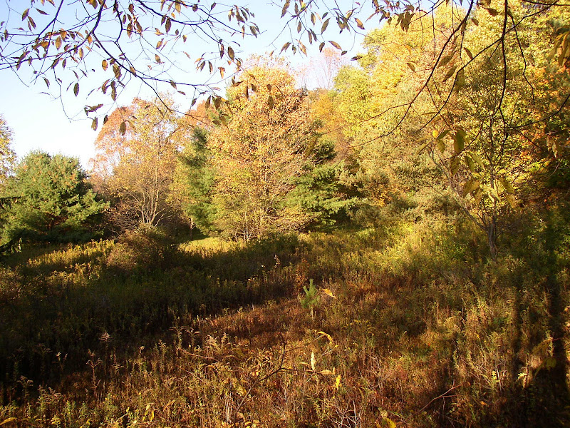

Here are some pictures of the property.

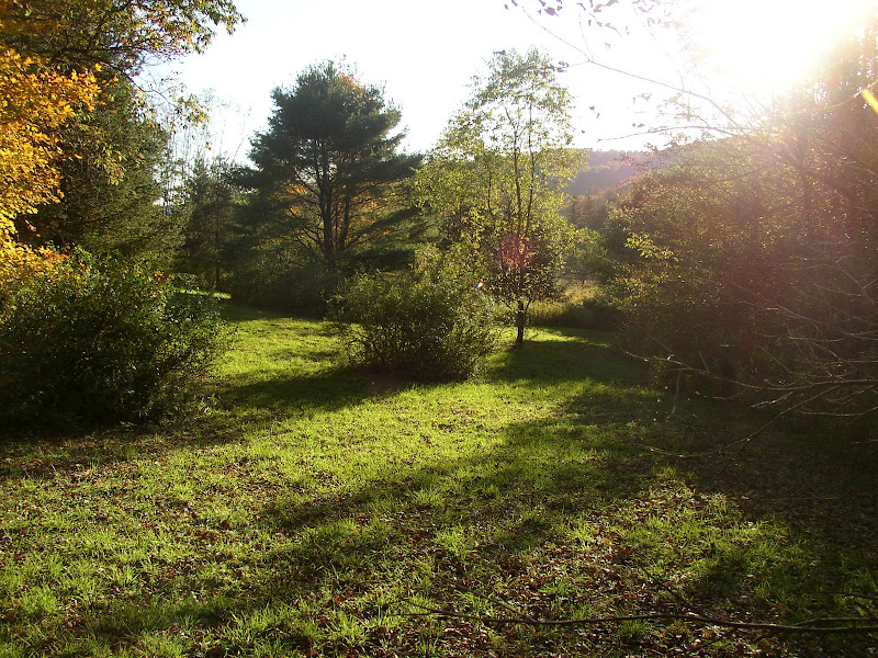

It's about half overgrown field, and half young woods.  Here's a view across the fields in full goldenrod growth in the fall.  The hilltop across the valley is state land.
There's a seasonal creek that comes out of the woods and then hangs a left down the valley.  I mow a small section between the creek and the woods.

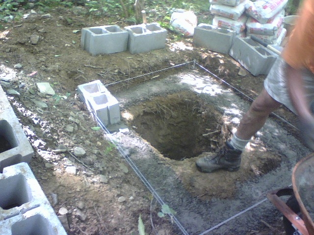

I got my by-the-book ways partially be being an engineer by trade.  So of course I had to design the thing on CAD:
I found this to be very helpful in that it allowed me to have just about no wasted materials, and everything fit together well.  I didn't have to spend much time scratching my head in the field and recutting wood that didn't fit the first time.  I realize this approach isn't everybody's cup of tea, but it works for me.
I had to start with the hole of course, which took lots of days to dig, since I did it by hand.  Because the hole was 4' deep, but only 3x4 feet opening, I could only use a pick and shovel the first foot or so, the rest was by hand.  And there were lots of rocks.  This took a lot more work than I though it would.  Here's a shot of the hole (it's bigger than it looks there) just as I was starting the foundation:
As you can see, I don't have the foundation down to frost line (hey, this is already fancier than most outhouses!), but I did dig down around the hole to mineral soil.  I leveled it out well and put down one bag's worth of concrete to provide an even more level surface for the first of two concrete block courses.
Even with just two courses of blocks on a tiny building, this was a lot of material to carry into the woods (since I can't drive across the creek).  It made me wonder what it's like when I start larger projects.
Note, I did fill in the voids with mortar, something you wouldn't normally do.  This was just to provide more strength against frost heave.  I also drove some rebar through the mortar into the soil for extra anchoring.  Here's the finished foundation (was getting dark by the time my son and I finished, which made the cell phone camera pic not so good).

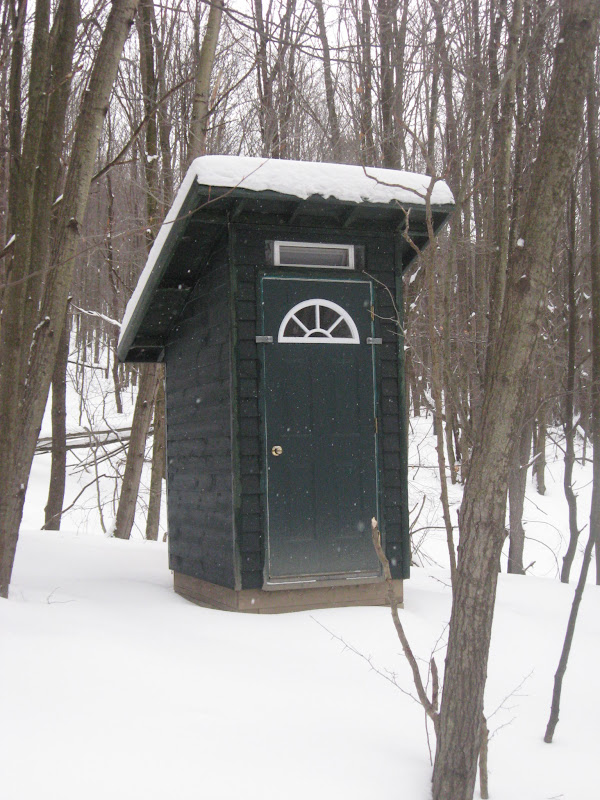

I don't have any pictures of me building it, and only a few when I was done.  Here's a picture of it the first winter:
I originally constructed it just with T-111 siding, but after two years, the porcupines found it and started eating it fast
So I had to put up some wood siding on it and restain.
It works well and doesn't stink!

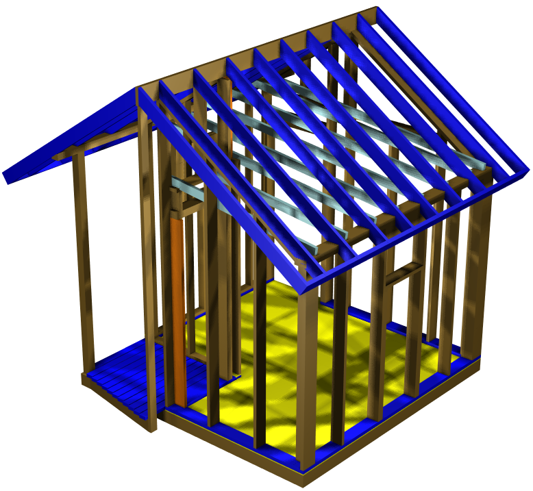

As I mentioned, I am starting with a shed.  I am not sure what the exact dimensions are for not having to get a permit in my town, but I proposed a 10 x 10 to the inspector and he said no permit was needed.  So I stuck with what I proposed.

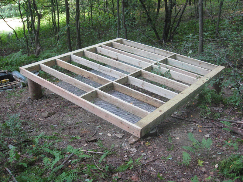

Being in cold winter country, I needed to go down at least 3.5 feet for the foundation.  I decided to go with four sonotubes installed using a two-man power auger (the kind you have to pick up and run).  With all the rocks, this was a lot of work, but after the better part of a day, my son and I had the four holes dug.  It took much of the following day to mix the dozens of bags of concrete to fill them all.  I had some pictures of this but I lost them.
I leveled the tops of the tubes using a home made water level (water jug and 15 feet of tube) which worked real well.  As for getting the brackets square, I recently made a post about my technique:
http://countryplans.com/smf/index.php?topic=8906.msg115377#msg115377
One of the pictures from that post shows the end result quite well:
Although I used the 6x6 beams on the ends rather than on the bottoms, I thought the recent pictures from Soomb over at http://countryplans.com/smf/index.php?topic=8956.msg115418#msg115418 looked quite familar!  I had 16-inch spacing as did he, which means you have one set of 8-inch spacing over 10 feet.  I put mine 4 feet from one edge, based on my design.  Once again, I designed it on CAD first:
As you can see, I am not even going to have the full 10 x 10 interior to use as I am making a notch in one corner.  While this looks like a "porch", the actual reason is that in the future, after the real cabin is built, I want to turn this shed into a sauna.  For that, you also need a place to rinse off afterward (some may call that a shower, but I won't because that probably has code implications), and that's what this will be.  This corner is over the edge of a drainage swale, so any rinse water has a place to go.  I put the close-spaced joists where that half wall is going to go for greater support.  The whole future-sauna thing is also why I spec'ed out 6-inch walls on three of the sides for future insulation (the fourth wall will be a part that will remain just storage)
Although this is already in the ground, feel free to comment on the design of the foundation.  I see people usually going with more than four foundation posts for something like this, but I thought it was sufficient with only an 8-foot span.  Note, the sonotubes are 10-inches in diameter and have rebar in them.  They are also sunk more than three feet below ground surface.  So far no problem.
Another feature of the design is that I have the roof peak splitting the gable end 60/40.  This gives me a larger overhang on one side.  It also leaves me with a normal roof pitch using 8-foot rafters on either side which is nice for 8-foot metal panels.  This means one wall is taller than the other.  It's things like that where doing the CAD design first really helps when going into the field.
Another shot:

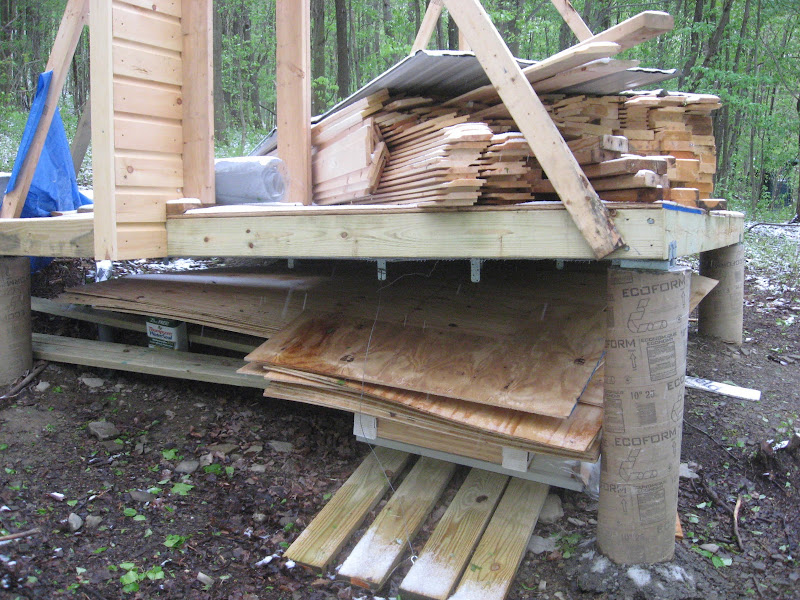

It's hit or miss, but I got some great lumber, mostly long 2x6's, for a real good deal.  Since I had the long 2x6's, I got the ridge beam (plus the doorway to the rinse-off place/porch) up first.  Since it's just a 10x10, I figured I wouldn't be able to tip this up after I had walls.
I supplemented the cheap stuff with an order from the lumber yard who delivered it last month.  It was a workout and a half carrying this all (basically the whole cabin, including the sheathing, two doors, and wood siding) a couple hundred feet uphill by myself.  Here's what it looked like piled on and under the platform:
It was good to see that my floor could handle the weight of just about everything except the doors and sheathing without complaining.  If I squint, I might discern a slight bow in the 6x6 beam, but basically, the foundation and floor seems stout enough.

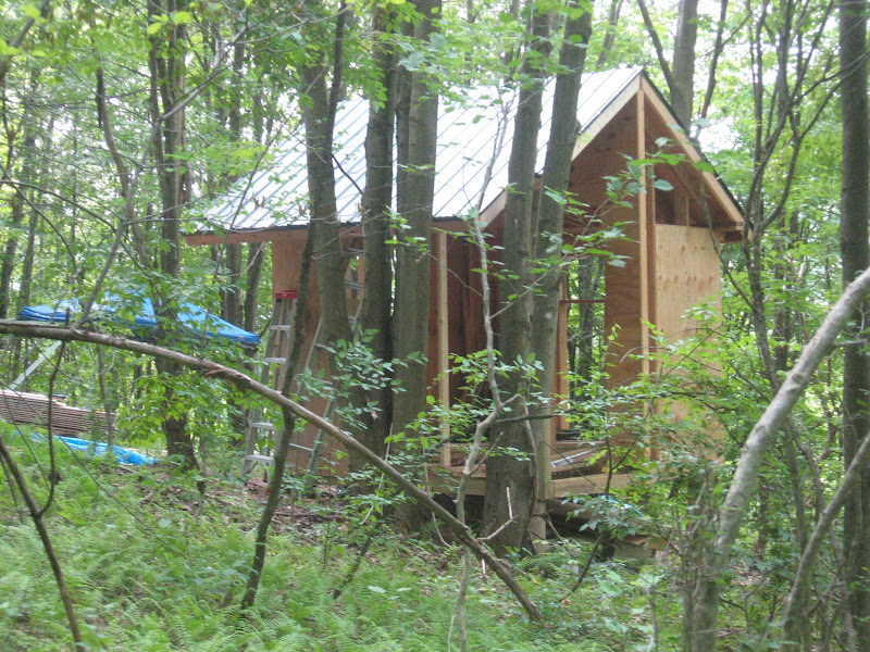

I had it all tarped over, but a huge front came through on Sat. before Mother's day, blew off the tarps, and left this view:
Yes, we had snow in May this year.  The previous weekend was sweltering hot.  Go figure.

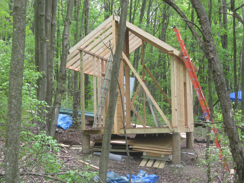

As long as I was down there to get the wood covered up, I at least started putting up the walls:
Same view a few hours later (snow's gone already):

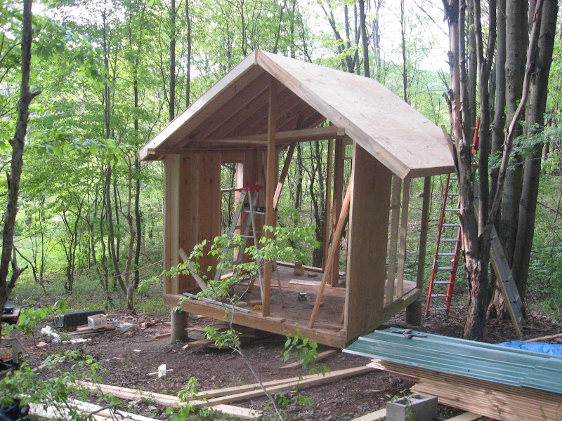

Well, making some progress over the last couple of weekends.
First of all, my buddy came over with another pair of hands, as well as some more tools including an air nailer, which is awesome.  Without the help and the air nailer, and not to mention his very nice long ladder, I don't see how I could have gotten up the rafters:

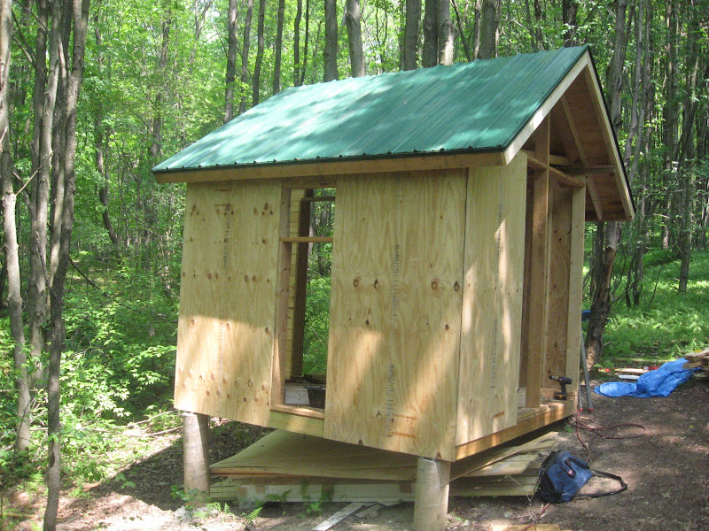

He also helped me get the first half of the roof plywood on
But I had to do the other half myself.

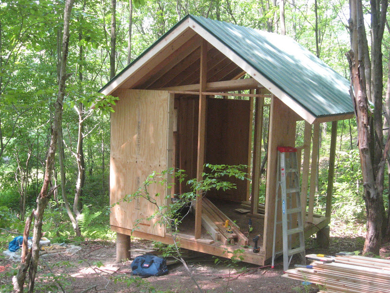

Now, with last weekend being a three-day, I figured I'd get a lot done.  But then there was also the Memorial Day party over at the cabin of the guy lending me the generator, not to mention some swims in the lake and some bike rides.  But I still managed to get the metal roof on:
I put 15# felt down, aluminum drip edges (over the felt on the rakes, under the felt on the eaves), then the panels.
Now, the first side (the side further off the ground) was actually easy because I put some cleats at the bottom (with kerfs to go over the drip edges) and just slid the panels down from the other side of the roof (at a hair over 8 on 12, this could be walked on still).  I then fastened the panels either from a ladder below or hanging over the ridge from the top.
But the other side had me scratching my head.
Once I put the paper down, I couldn't walk on it (the paper slid, ripping out the staples).  In hindsight, I guess the technique is to do one panel at a time while moving nailed-in boards to stand on until you get to the end.  I guess that's why this is a good learning experience.  I was not prepared to do one panel at a time because even though I allowed more than 12 feet of roof top to account for the extra overlap from the last panel, I still couldn't get the panels to not overhang the rakes until I futzed around with all four on there at once.  The lesson learned is to leave even more wiggle room (width) than just an extra inch+ when laying down the plywood.  Just a hint out of square can really throw things off, too.
And I still don't have the ridge cap on.  No idea how to do that.  I think I will have to borrow my buddy's long ladder again and go straight to the ridge and just straddle that to put that on.  Unless anyone has a better way.
Picture looking from uphill (had to find at least one new angle to photo):
