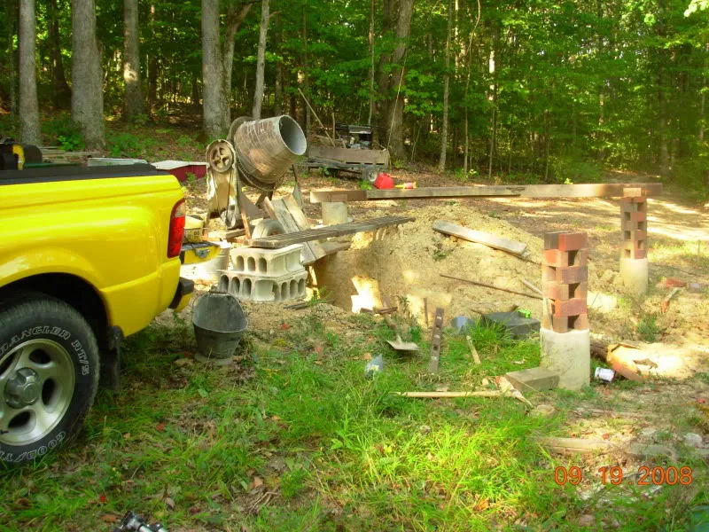

So '08 was a very frustrating year when it came to making progress on the cabin.  The year started out weird with the late snow fall, then the beautiful spring, then very limited success with the chainsaw mill, then rain, rain, rain, and more rain.  I am reposting the Oct. '07 photo where you saw the beginnings of the fireplace foundation hole.
Originally, I wanted the fireplace on the north wall and started a hole at that location, and if you look closely you can see that shallow hole to the left of the bigger hole and just off the right of the NW pier.  Then my lovely wife came to visit so that she could record a mental picture of what my vision was.  I explained what would be along the north wall and her first response was that I was blocking too much of the view, and she was right. d*
So I rethought the whole thing and moved the fireplace, rotated it 90o and moved it towards the SE corner keeping it away from both walls.  Even though the typical stone fireplace is on an outside wall with the chimmney on the outside of the wall; that doesn't make for an efficient wood burner.  Another reason for moving it away from the wall makes the chimmney shorter above the roof and therefore more of it inside for heat retention.
Another change was to still build a stone Rumford but just up to the mantel level and then run naked stove pipe to the ceiling, again to retain more heat as well as cut down on the total weight to save a little on the foundation.  So the next photo shows the results and note the date (11 months had elapsed before I was doing serious forming.
Working alone and manually digging the hole in between rain storms made the progress very slow.  Just when I thought I had it done and even covered up, it would rain and I would have a bathtub.  I had to trench down slope to keep the water flowing out of the hole, but then it would still get wet enough to soften a couple of inches of clay and I would have to go deeper to get to undisturbed soil.  The hole ended up at least 12" deeper than really needed.
Here I am set up and ready to pour.
This is the down slope end of the foundation and if you look closely you can see that the hole is deeper on that end.  The primary foundation is 8" thick with 1/2" rebar and this deeper end is 16" deep, again to get down to undisturbed soil.
The pour complete with rebar anchors for the corners where concrete block would be laid.  The next installment will complete my effort on this first location for the cabin.
Here is the teaser: remember the wet spring?  Even though the cabin site was on a crown with only the uphill side sloping towards the foot print, a stream of water developed almost dead center right above the foundation.  There was no hint of a ground water problem previously.  Secondly, remember the Kentucky dude who quickly put up a house on piers during the summer and fall of '08 and didn't brace the piers?  Hold that thought until next time. ???

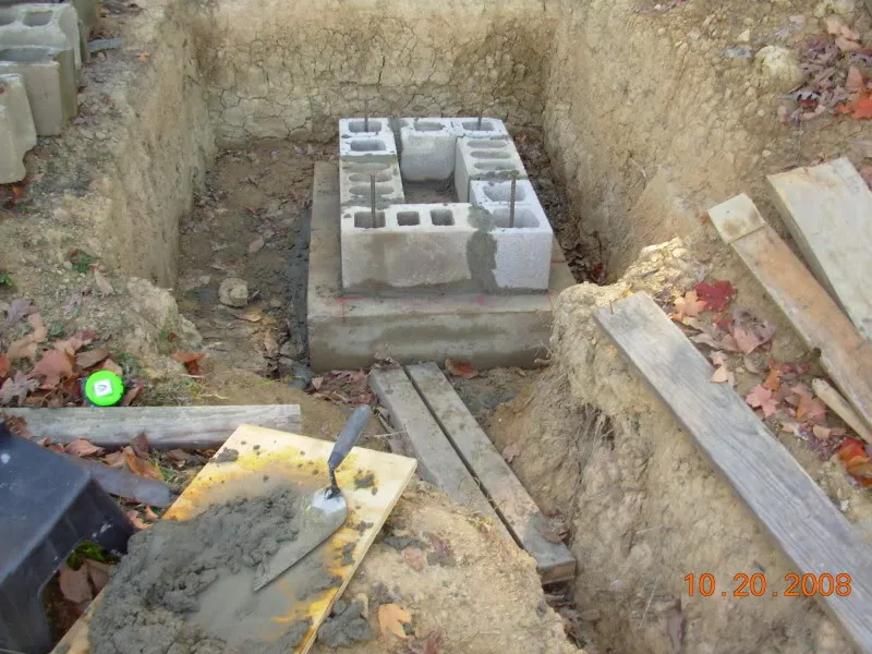

Here I have set up to start the concrete block work on the fireplace foundation.  I used my wife's car for some reason that I can't remember.
Got the first course laid and this, my friends and fellow builders, is the last photo of '08 and close to the end of construction on this particular site.  I did get 2 more courses laid before winter set in, but didn't photo document it because I was waiting for further progress which never happened.  My next post will try to explain why and where the second cabin site was selected and this one abandoned.  But first here's the start of '09 which in some ways was worse than '08.

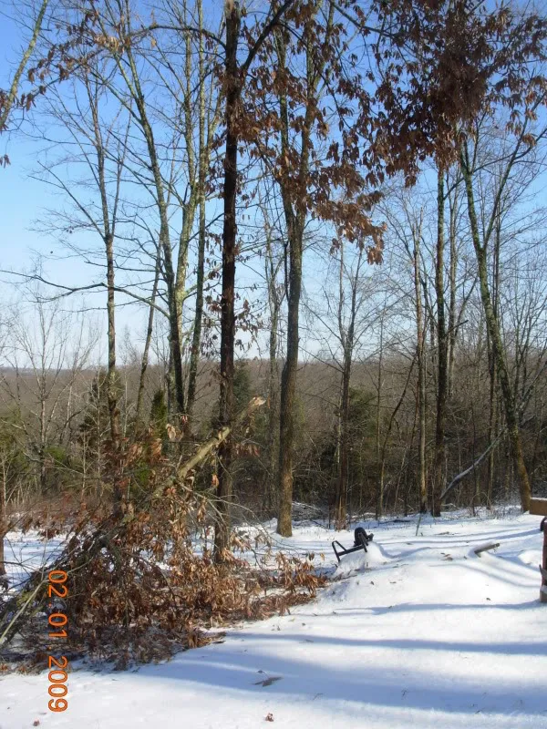

This could be the last photo of the original cabin site.  This was after a snow and ice storm that dropped about 12" of the white stuff, which is unusual for this part of the country.  You can guage the depth by the concrete piers which protrude 12" above grade.
The tree (a hickory, I think) closest to the cabin north side that sustained ice damage.  I told my wife that it was a sign from God that this was not the perfect site for the cabin.  There was a lot of other ice damage to maples and cedars and pines also.  I'll have some of those photos in a later post.

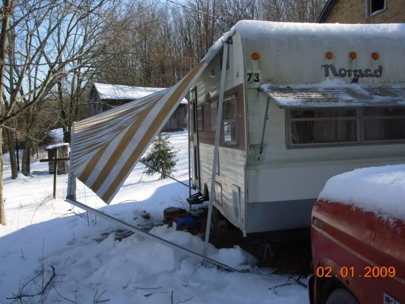

More ice damage, this time to my porch.  I should have known better than leave it out, but on an earlier visit it was so cold that I didn't want to roll it up.  Oh well, lesson learned.  So began 2009.

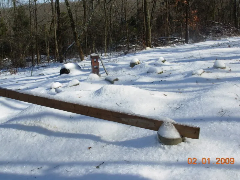

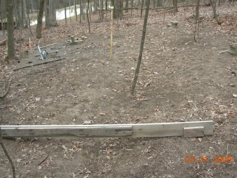

Just a quick update and short introduction to the new cabin site and the start of "Poppy's Pin Pier Plan."
First a couple of spring '09 pics to wet the appetite:
My newly dead corkscrew willow and another bush that I don't know the species of.  The large pines in the background are along the road and were planted as a WPA project, I think.  I know they are not native to this part of Adams County.
For you historials out there, the road past my land roughly follows the old Zane's Trace up from Kentucky. 8)
The same trees viewed from the opposite direction with the outhouse and largest walnut trees in the background.  If you look closely you can see one of the neighbor's barns.
What follows is a photo previously posted about an oak stump removal next to the farm road/driveway about 250 ft. from the road and half way to the original cabin site.
The large maple tree at the left center defines the intersection of two farm roads.  Behind the tree down to the left is the barn, and veering to the right is the road back to the first cabin site near the other end of the pond.
I found the "perfect" site just off camera to the left between the stump and the barn. ;)  If anyone is interested I can give a detailed list of why the first site was not so perfect and the new site is. d*
The first of many pics at the new site starting at the NE corner as any good Free Mason would.  This shows one pin in and the second one in position and the other two at the ready.  This is my own design using 1 1/2" sch. 40 galv. pipe.  I can give more detail on the background of the design if anyone is interested. :P
That's all for now.  Dale

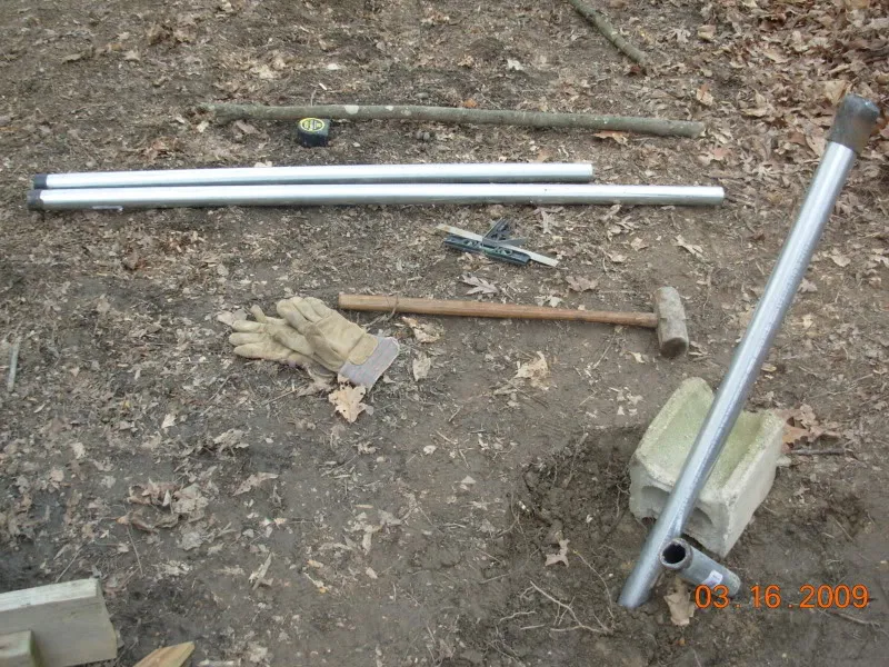

secordpd
Are you pounding the pins in then pouring a concrete base around them?  Are you using a cap on the pipes while pounding?  I can't wait to see more pix.   You really have a beautiful piece of land there Poppy....
poppy
QuoteAre you pounding the pins in then pouring a concrete base around them?  Are you using a cap on the pipes while pounding?  I can't wait to see more pix.   You really have a beautiful piece of land there Poppy....
Thanks for the kind words.
Yes, there will be a concrete base.  Originally the plan was to use a 1' section of 12" Sonotube, but it doesn't provide enough clearance around the pipes.  So I have constructed forms 1'x1'x1' and after placing some rebar to help tie the pipes together will pour all four caps in one process. (BTW, larger Sonotubes are really expensive)
By cap, if you mean on the bottom end, then no; the end was left open.  Interestingly, the soil compresses about 12" inside the pipe.
If by cap you mean on the top for driving, then yes.  The photo shows what I used for the first few after the first one; it's a section of 2" pipe with a slice of bar welded on.
The first pipe was driven using a cast iron threaded pipe cap, but that disintegrated during the drive, which I expected.  I actually went through about 5 itterations of driving sleeves during the whole process. d*
5 gallon drywall buckets with the bottom's cut out will give you about 18" of heigth and 12" diam.

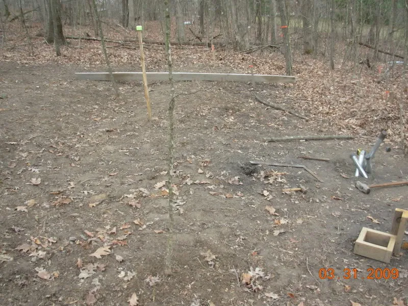

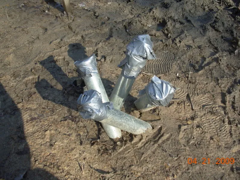

Another installment.  I am gradually catching up to present day, and then posting will sloooooow down, since this is a one-old-man show. :P
Three pins in and the 4th almost home; photo looking west.
Another observation, partly based on the sapling in the upper left leaning up hill plus the trough and crown shape of the soil; I think this is an example of soil creep.  There is little or no history of landslides on natural slopes in this part of the country, so I was surprised to see this, if that is what it is.
Here is another pic. looking east.
If it is soil creep, I don't think it is anything to be concerned about.  The slope is only about 2 in 12 and there is no soil erosion until you get to about 300-400 ft. down the hill.  Plus none of the large trees have the tell-tell sign of leaning down hill from creep and then bending vertically as it grows.
Until next time.

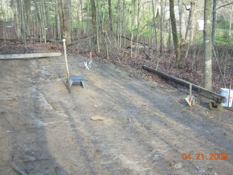

On to the NW pier after some more site clearing.
This is an early morning shot so you can see how the sun hits in the a.m.  This was also after some pretty good rain which I mention because wet conditions don't stop the pin placement process.  You can see the old house and "new" trailer in the background.
NW pier pins in.  I did have to slop around in the rain & mud a little on this one.  And good ole duct tape used to cover the ends.
A shot looking west at about mid-morning.  The stakes along the right loosely define the north side of the cabin.  That maple is a little close.  :o

Maybe you've been over it, what keeps frost from lifting these when you pour over them?
