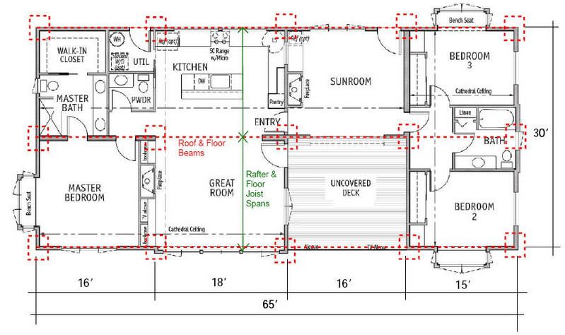

#13
 Ah now I found the floor plan,
Which is OK . I don't like that "walk thru the bathroom to get to the closet" set up at all. And venting that oven would mean a down draft vent hood / oven setup , do able if you like downdrafts.  the plumber will like that island sink , Ca-Ching!! He'll pass out with dollar signs in his head!
I'd lose or change the sunroom it's the same space as the great room really wasted floor space your paying for. I'd move the wash room/ powder room over that way and group it with the other bath . That "sunrooms " just a wide hallway. I put like I said the powder room over there along with the equipment room that would free up some space to get a better MB / WIC setup. ( Master Bath , Walk In Closet.)
They must be using "I" joist for rafters as thats a long span , or a pipe type truss?? No beam showing so some engineer made his $$ to stretch that place.
And these cabinets , typical factory grade you can tell "no one who cared" picked out the materials to match grain , let alone color , again Willy Nilly must be hard at work in the cabinet shop grinding out his 40 hours .
Almost should be crime to put nice looking fixture , sink ,  valve and pulls, etc   on something that , well ugly, mismatched  grain poor color match etc .
Other than that "she's Cherry"   ::) Who designs this stuff? Maybe they should try swinging a hammer for ten years BEFORE they get to use a pencil ;D
Sorry just my opinions :-[
#14
Glad you liked it, PEG. ;D
I didn't look at the floor plan close enough to see the bathroom walk-in closet.  That really doesn't look too practical. :-?
In this case the master bedroom is then without a closet which a real estate lady told me keeps it from being a bedroom -- unless you count going through the bathroom as it's closet.
To me the small hallway between the master bedroom and the powder room is a waste also.  What if you wanted to get to your gunpowder without being seen in the  kitchen? :-? :)

#18
For folks who don't want to open the PDF that I posted a few lines up this thread, here's an easy way to do the structure...
I agree with the layout revisions PEG and others are suggesting. I think I might do the two bedrooms with the middle bath in the left module, put the master on the right with the privacy buffer of what is now the Sunroom (it is not a sunroom!), and use that middle space for the utility and master bath. That way you can dump the landlocked powder room and get by fine with 2 bathrooms and a more spacious room layout.
I would not do four alternating sheds as shown in the painting. If the sunlight (South) is facing downward on the plan then you could combine the high sheds all on that side with the "sunroom" module having a nearly flat roof in the middle.
One thing about these sheds is that they lend themselves to building in stages - and the lower slope is easy to work on.
I opened the PDF and that was much what I had in mind also, but somehow got sidetracked from commenting on it.
It sounds like a good way to go if you are interested in this type of structure and I like the module idea. :)

John,
 It's way bigger than anything I'm contemplating so the question is mostly academic, but;
You've got the piers on 18' centers in the great room area.  Wouldn't that require a very large beam?  Without doing the math I'm guessing 4 - 2x12's.   I've seen quite a few with 12' - 14' spans, you usually place them much closer.
Ya know, sometimes this place makes me wish I had a .wav file of the Tim the tool man Taylor grunt.
Now that's beam... "grunt,grunt,grunt."
Yes, for the floor loads it would be a big beam. I would drop in one or more piers to cut down the spans. Can't do that for some of the roof spans however. Or you could do it all with trusses.
Just an exercise at any rate... not trying to sell a finished owner-builder design. Not my design anyway. For the bucks they are asking the beams could all be framed in steel.

How would you do the beams lengthwise, they would be 30 ft. plus,  that could add up quick buying beams that size wouldn't it?  The design is something that could be done in stages for sure.
